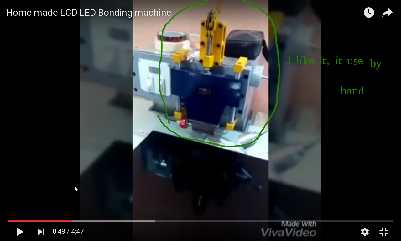

    I try to copy this idea use hand crank winch (Pic1).and Temp. control solder iron as a heating element. I will add microscope as an optical alignment.
    Yes, it is a LCD Bonding Machine or a COF Bonding Machine.

    The bonding force control use turn knob to adjust the pressure.
