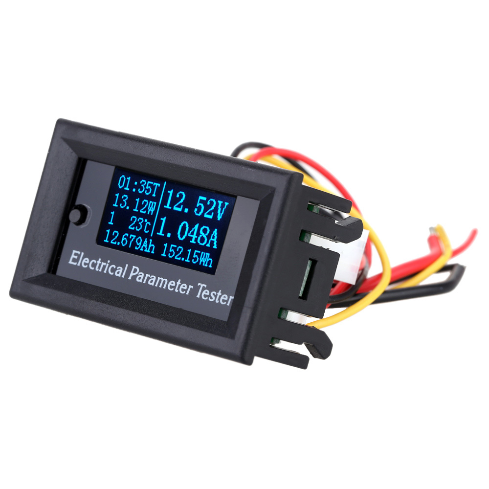

    I needed some digital panel meters for my bench power supply.
    Salvaged out of the garbage Simpson M245 panel meters, way bigger 0.5" LCD... and $280 each! But they keep blowing backlight LED's and I'm tired of fixing them.
    Found this chinese 1" OLED meter and am really happy with it for $7. I find it well built, accurate with 4-digit resolution and ~0.8% accuracy. Everything else had chunky 8-bit resolution, lousy accuracy and drift.
    Silly name "electrical parameter tester" got from eBay but all the other chinese stores have them.
    Three models and white or blue OLED.
    Fullscale: 33V or 100V, 3A or 10A combos.
    Runs off 4-20VDC at about 15mA, ground is common with the 25mohm sense resistor to the load.
    Volts - sense is 0-33.00VDC or 0-99.99VDC depending on model
    Amps - 0-3.000A or 0-9.99A
    Power - 0-99.00W or 999.9W
    Temperature -15C to +60C (has thermistor on back of PCB, you can move it)
    Coulomb counter 0-99.999Ah (great for battery charging)
    Energy counter 0-999.99Wh
    Timer shows run time 99h:59m
    Pushbutton resets Ah, Wh counters and can clear any drift/offset on amperage reading. Seems to also be able to store all this in EEPROM.
    I just wanted to let you guys know, I found it's useful and bench worthy.

        Wow, this is pretty awesome! Thanks for sharing with us!
        You can't believe how many time's I've worked on projects and needed both an ammeter and volt meter at the same time. Typically, I do this with two cheap multimeters, but it's always a messy setup. This could be much neater.
        Also, the Coulomb counter should be pretty useful for charging Ni-Cd and Ni-MH batteries, since those don't really have a defined cut-off voltage and can be easily over-charged or under-charged with your typical "dumb" chargers.
        So yeah, this "electrical parameter meter" is definitely going on my wish list next.
