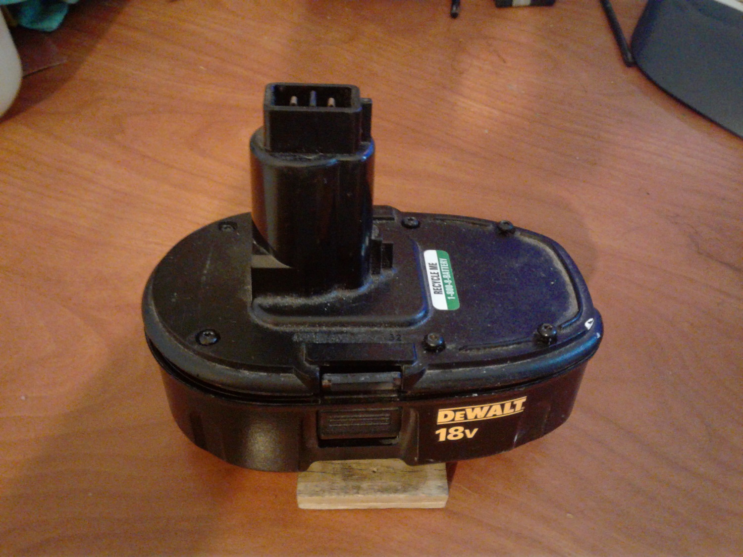

    Dewalt 18 Volt Battery Repair
    The set includes two batteries, a screw gun and a drill. I left it outside and it got rained on. One battery works in both the screw gun and the drill, and the other battery will not work in either.
    Both batteries test at 24 VDC, but the damaged one one run either the drill or the screw gun. I disassembled the damaged one (see pics), but don't want to go any further.
    These cells still hold voltage, and so I don't understand why it won't power anything. It looks like at least one cell is leaking, and I wonder if I can replace only it. You can buy a whole replacement cell kit (pre assembled) on eBay for $35, but you can buy a brand new battery for that price also. I wonder if you can buy these cells in pairs.
    Anyways, I'm looking for repair options. I can solder and have the tools. Is this repairable, or should I trash it and just buy another battery?

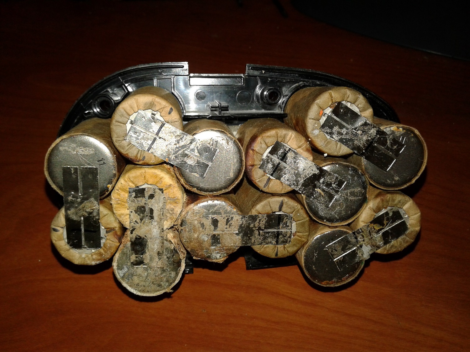

    Re: Dewalt 18 Volt Battery Repair
    Scratch the straps with flat blade screwdriver if broken you will need to rejoin it.
      They are not broken. Now what?
      Why am I reading 24 volts on both batteries, but one will not power a drill?
        can you measure the amps each battery is outputting im just wondering if the faulty one is low
          There is high resistance somewhere I was thinking a strap but now looks like a cell that is bad.
          If you have a 1.5v torch bulb and wire you can test each cell.
            I'd have to disassemble and isolate each cell to do this, right?
            Any source for these cells? I think I saw a YouTube video about a year ago and the guy said he got them from Ali Baba and they were standard "C" cell rechargeable batteries. I only have a small soldering iron and I don't know if it's got the watts to desolder and resolder these batteries.
            I don't want to take this thing apart without knowing I have replacement cells. If I can't get individual cells then the only two options are replace the whole assembly or trash the battery and buy a new one, and both of those options cost about the same.
              no to do test you just put lamp across each cell one by one.
              you will find the battery's are welded not soldered.
                Well if they are welded then how can they be de-welded and re-welded? If the individual cells cannot be replaced then there's no point in troubleshooting down to the individual cells.
                Can I use a propane torch?

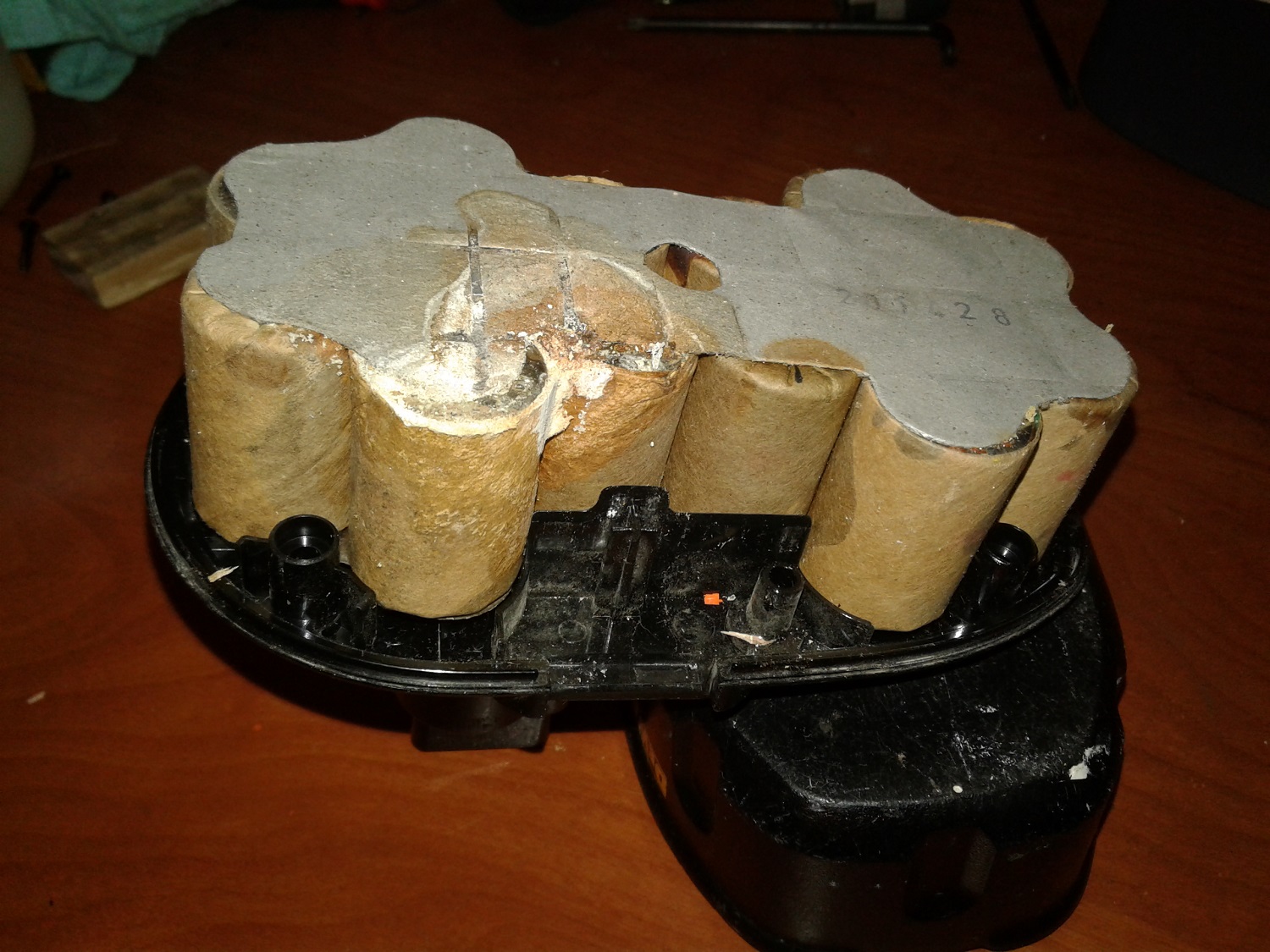

                  those cells are done,
                  are they NI-CAD?
                    If one cell is bad you can cut the strap between two cells, buy new cells with tabs and solder the new tab to the other tab on the existing cell in the pack. most likely the other cells are weak and when you price out new cells (not cheep ones) it could be more than a new replacement battery pack.
                                        Buy the new batttery pack from Dewalt , I suspect it will also come with a (possible 3 year) warranty. look around they may even be on sale.
                                        The cheap ebay ones are most likely crap and won't last
