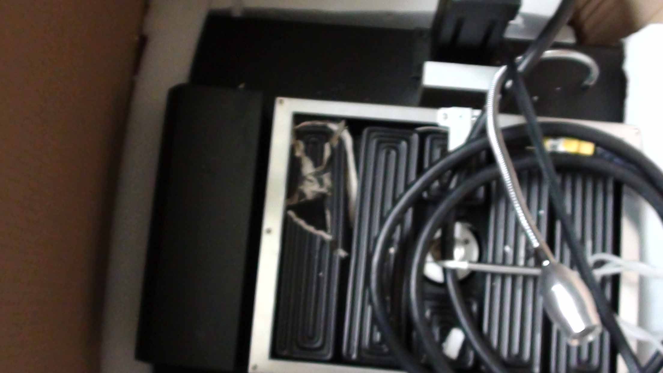

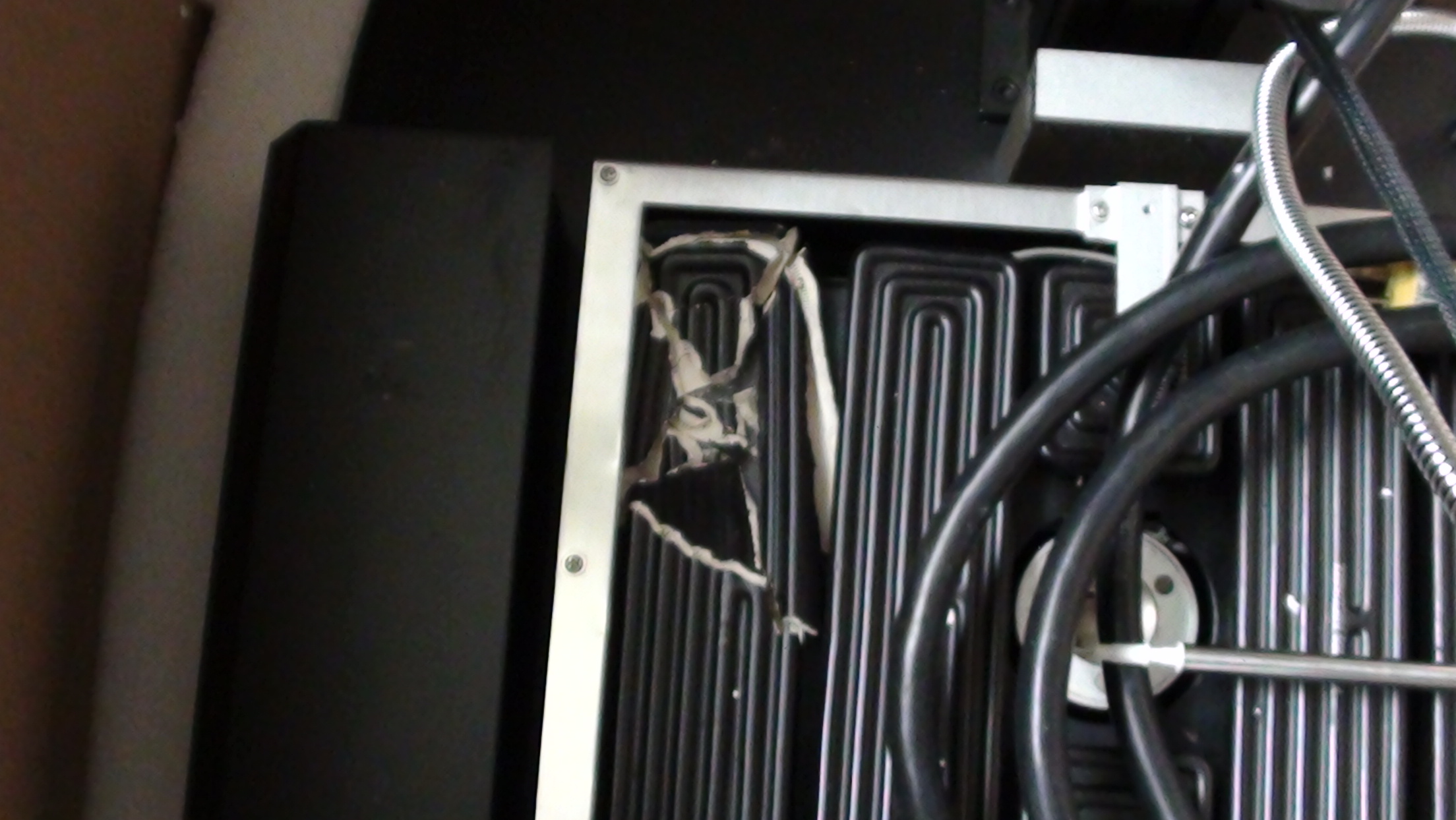

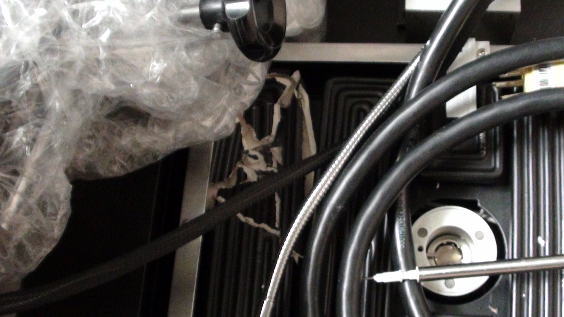

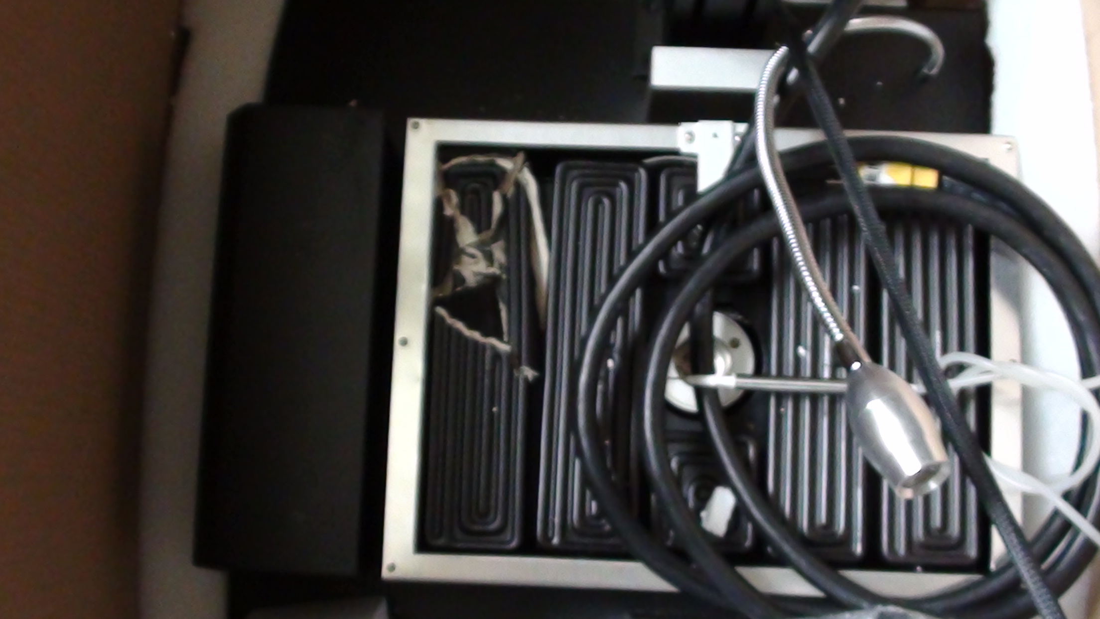

                                  I'm freaking out. Supposedly, FedEx came and knocked on my door today but I didn't hear anyone freaking knock. My mentally challenged brother, who lives next door with my parents, was the only one home there. He went out and said the FedEx man made him sign for the package and help him carry it to the house. When my parents got home, they said this giant package was on the door steps. My dad said it was sideways, it has arrows and shit saying this side up but it was upside down. Anyway, here's pictures of the unit! I just opened it up to make sure everything was there.
                                  I could tell what happened. The top heater was disconnected and laying on top of the IR preheater module or whatever you want to call it. Someone dropped the box or something and that heavy top heater smashed the freaking pre-heater module thing.
                                  I have no idea what to do now. I contacted the seller and let him know via e-bay messages.
                                  I'm thinking FedEx never knocked on my door. I figure my brother seen the truck, ran out there and said he'd take the package. I figure he helped them carry it and he claims he gently set his end down but the FedEx guy just dropped his end. I think if anything, it was the other way around. Or it got damaged in shipping. What the heck do I do??
                                  -- Law of Expanding Memory: Applications Will Also Expand Until RAM Is Full

                                    #97
                                    Re: Replacing BGA components with hot air.
                                    Contact the seller and send them your photos.
                                    Avoid that flux, looks fake to me, buy from a genuine dealer. I buy 4300 and 559 from a genuine seller in 10cc and then I add a needle nozzle(screws straight on) and a syringe as a plunger.
                                    https://ultrakeet.com.au/write-ups/fluxInfo
                                    Looks like its just one heater, but that's poor packaging, my top heater and its mount came boxed separately.

                                      #98
                                      Thanks, I've contacted the seller and sent photos. I'm waiting for his response. I couldn't figure out why he didn't box the top heater separately until I tried moving it.
                                      The top heater has a wire. That wire connects to the top heater and is removable. You just unscrew it and pull the wire out. The other end of the wire screws into the base unit. However, it's a much cheaper plastic connector. If you unscrew it, it doesn't come apart as far as I can tell. The screw part seems to be just for looks! I can send pictures. I didn't want to pull too hard for fear of breaking it. I'm thinking I'm probably going to have to replace that broken ceramic heating element. I'm going to have to tear apart the whole unit to get to it, unsolder it, etc. I won't do anything until the owner gets back to me. However, if I gotta take it apart, I would probably replace some components with nicer ones.

                                          #100
                                          I wouldn't touch it any further until you hear back.
