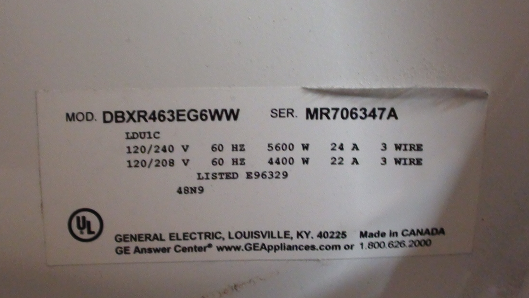

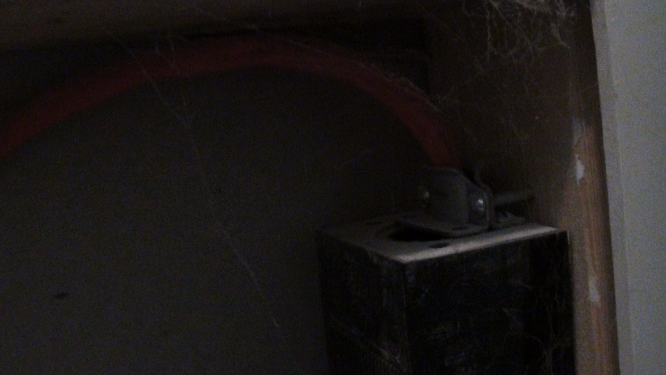

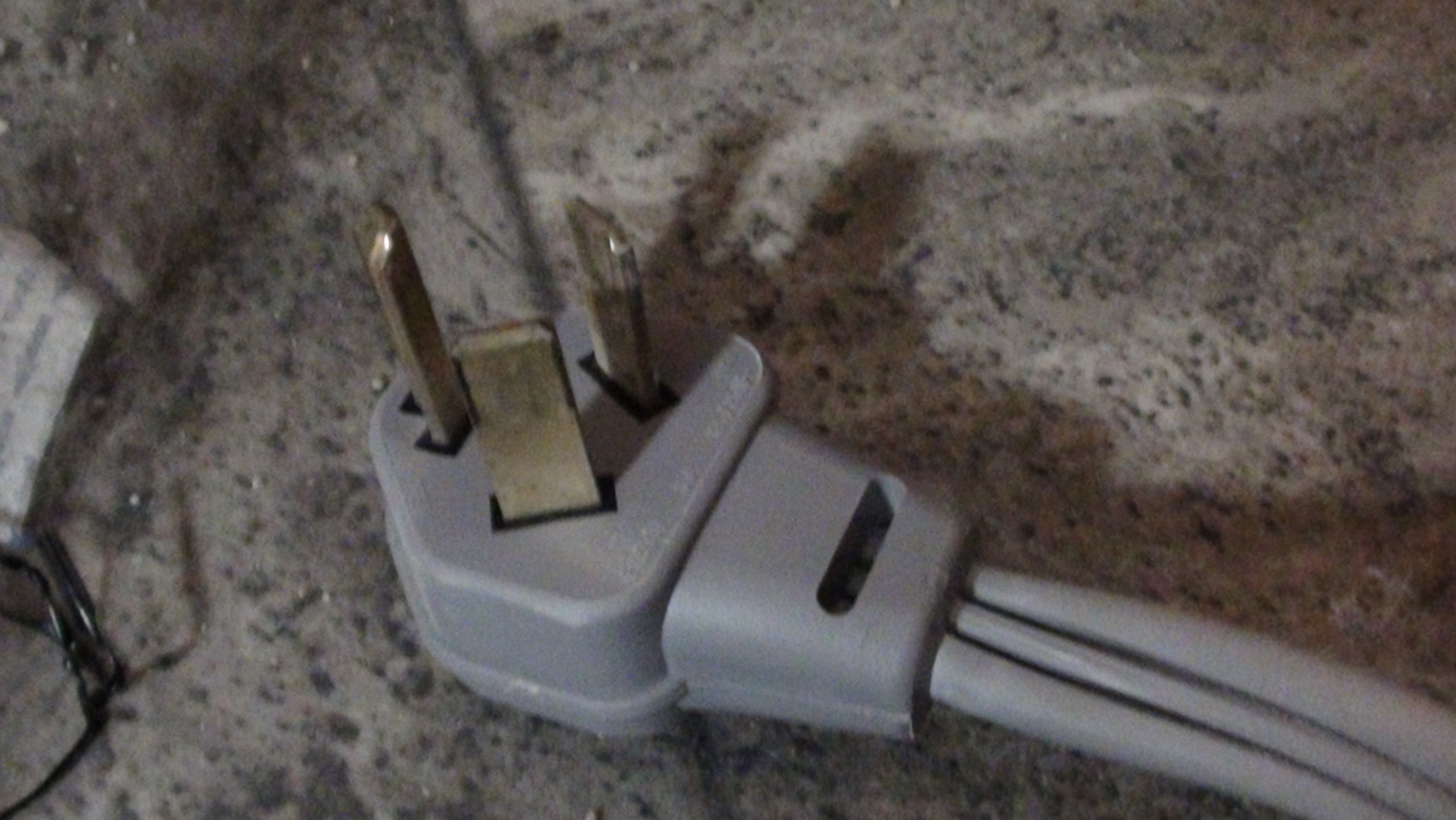

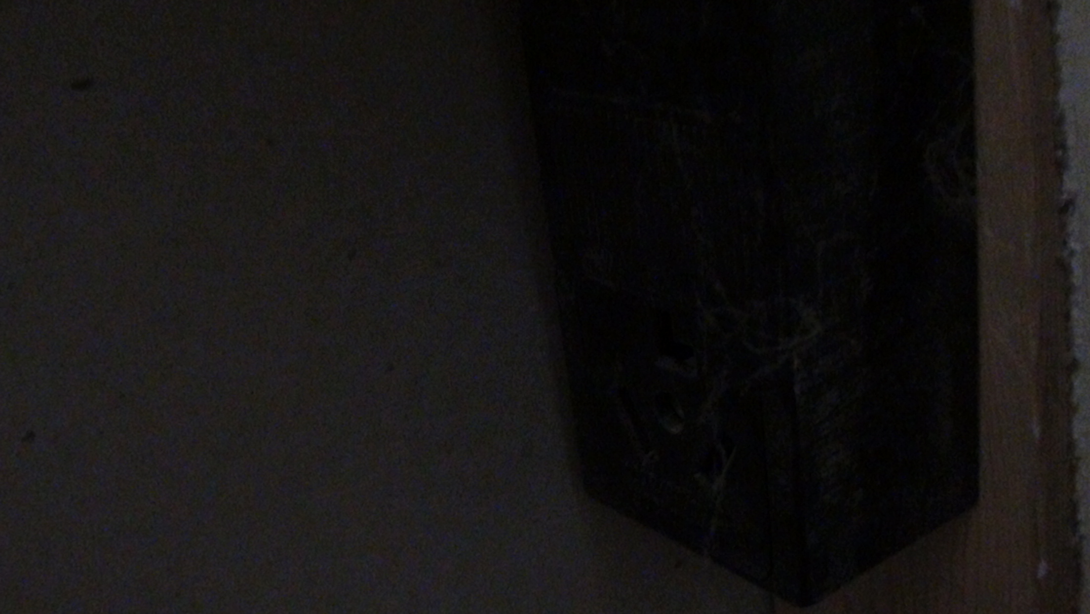

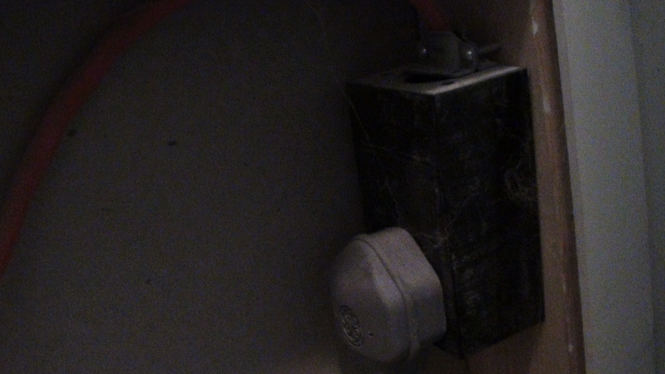

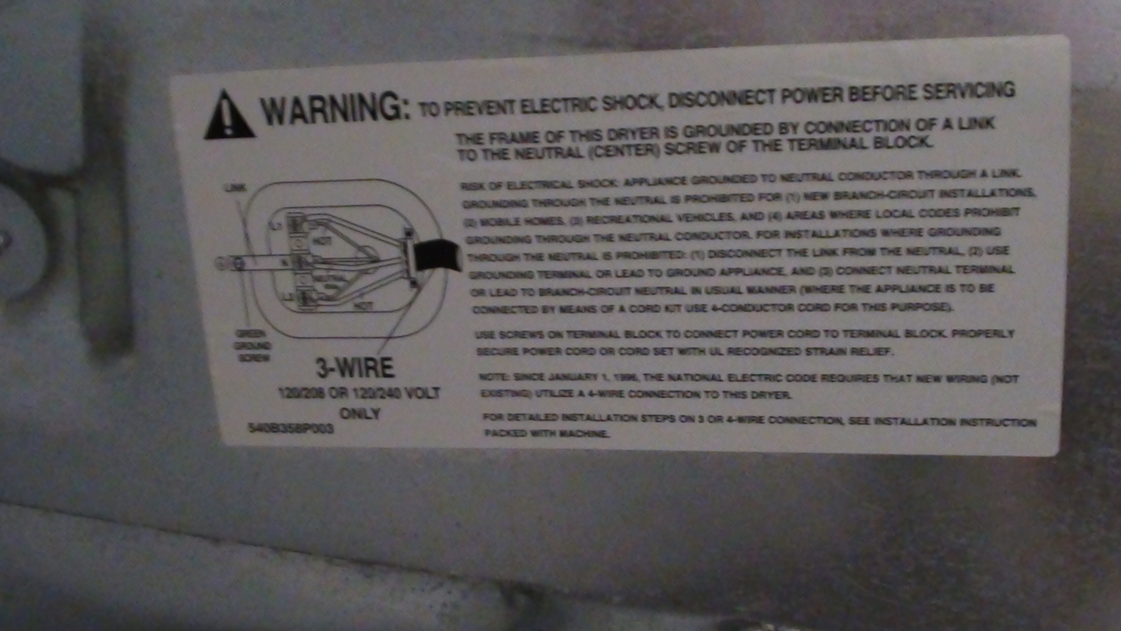

Re: Replacing BGA components with hot air.
higher voltage is better and safer than higher current.
Replacing BGA components with hot air.
Re: Replacing BGA components with hot air.
Okay. Is there a reason you say that? Just out of curiosity.
I've seen a few different ACHI models. Some come with a plug, some just come with wires. I don't know yet if this Scotle just comes with wires that need to be hard wired in (or have a plug attached) or if it actually has a plug on it. I'm probably going to need help hooking it up to electricityLeave a comment:
Re: Replacing BGA components with hot air.
I think I decided. Instead of the ACHI or the Fundar, I think I'm going to go for the Scotle IR PRO SC V5 BGA Rework Station. From what I've been reading, they're similar to the ACHI but just higher build quality. It's a little more pricey. I might use one of those step-up transformers or I might just try hooking up a junction box to the dryer's line. I dunno yet.Leave a comment:
Re: Replacing BGA components with hot air.
I'm also looking into those a little more expensive Fundar FD-6900's. ( http://www.aliexpress.com/store/prod...037971308.html )
I like the touch screen part, but they're more than double, almost 3x as much as the other.Leave a comment:
Re: Replacing BGA components with hot air.
This one appears to be fitted for 120v
http://www.ebay.com/itm/BGA-REWORK-S...YAAOSwQjNW-0SoLeave a comment:
Re: Replacing BGA components with hot air.
no, it needs a bigger gauge so it wont melt your wiring!Leave a comment:
Re: Replacing BGA components with hot air.
I purchased a step up converter like below and ran 12-2 from my panel. Until you purchase your supplies to run from your dryer you'll have about the same invested anyway and you won't have the wife yelling she can't use the dryer because you are playing with your machine
http://www.voltageconverters.com/ite...asp?ic=VC3000W
The $680 new one is the newer model because it does use the K-type thermocouple and it is located in the front. There are 2 thermocouples on the machine, one for bottom heat and one for top. I purchased one of these so I can monitor how even the heat is from time to time, but generally only use the one on the machine:
http://www.ebay.com/itm/4-Channel-K-...QAAOSwsFpWRqxE
I'm confused with the step-up converter. I understand that it can convert 120VAC to 240VAC, but because my 120VAC wire in the wall isn't a very heavy gauge, it can't handle very many amps / watts. Wouldn't the step-up converter need that bigger gauge wire so it doesn't trip a breaker?Leave a comment:
Re: Replacing BGA components with hot air.
This one appears to be fitted for 120v
http://www.ebay.com/itm/BGA-REWORK-S...YAAOSwQjNW-0SoLeave a comment:
Re: Replacing BGA components with hot air.
I purchased a step up converter like below and ran 12-2 from my panel. Until you purchase your supplies to run from your dryer you'll have about the same invested anyway and you won't have the wife yelling she can't use the dryer because you are playing with your machine
http://www.voltageconverters.com/ite...asp?ic=VC3000W
The $680 new one is the newer model because it does use the K-type thermocouple and it is located in the front. There are 2 thermocouples on the machine, one for bottom heat and one for top. I purchased one of these so I can monitor how even the heat is from time to time, but generally only use the one on the machine:
http://www.ebay.com/itm/4-Channel-K-...QAAOSwsFpWRqxELeave a comment:
Re: Replacing BGA components with hot air.
i still need to get the details of the big one from my m8Leave a comment:
Re: Replacing BGA components with hot air.
I was getting ready to purchase a used ACHI IR PRO SC for 850$ (free shipping). But then I decided to look around a bit and I found, what I think is the same unit, new though, for 680$ (both include free shipping).
Here's the 850$ used one: http://www.ebay.com/itm/achi-IR-PRO-.../152033619085?
Here's the 680$ new one: http://www.ebay.com/itm/SALE-Solderi...3D131795974275
Are both these the exact same model number? The guy selling the used one said he paid 3x as much as he's selling it for. Why would the new one be cheaper than the used one? Could they have different hardware inside or something?
From the video I'm watching, it also looks like there's only 1 k-type thermocouple connector. Shouldn't there be more for a good reflow? I should have at least for around the component I'm replacing I figured, and then maybe a couple on the board for the pre-heater...what do you guys think? Should maybe I look for a different one?
Also, on a video I'm watching about the ACHI IR PRO SC, the bottom is 2,000 watt, the top IR heater is 400 watt, giving a total of 2.4 kW, the entire unit uses 2.5 kW. Is that enough? I thought I remember someone saying 4,000 total watts is more normal...Last edited by Spork Schivago; 05-01-2016, 02:56 PM.Leave a comment:
Re: Replacing BGA components with hot air.
Does that mean it's not really 240v? I was going to purchase that ACHI IR PRO SC. Would I not be able to hook up another outlet to that orange wire in the pics and power this thing? Thanks.Leave a comment:
Re: Replacing BGA components with hot air.
take these.
if you power the circuit with the dryer unplugged and stuff a meter set to 600v / 1000v AC in the L1 and L2 you should see 240vLeave a comment:
Re: Replacing BGA components with hot air.
damn, 120-0-120 center-tapped!
i expected 0-240 with a seperate neutral-bonded ground!
you really have shit power standards in that country!Leave a comment:
Re: Replacing BGA components with hot air.
There's no fuses in the breaker box, just breakers. I have no way of tracing the wire to the breaker. I took an educated guess, turned on the dryer, and started flipping some breakers. I figured it wasn't any of the 20 amp or 30 amp's. So, I concentrated on the double's. For example, there's two 50 amp breakers that connected together. You flip both at the same time. There's two 30 amp breakers that are tied together. When I flipped the two 30 amp breakers, the dryer turned off.
I'm a bit confused about the wattage. I'm uploading some pictures. I open the door and look at the sticker. It has two ratings. The sticker says:
120/240 v 60 HZ 5600 W 24 A 3 wire
120/208 v 60 HZ 4400 W 22 A 3 wire
I have no idea why there's two or how to tell if I'm running at 240v or 208v. Here's the pics, maybe you can make some sense out of it, because you guys are more used to 240v than me.
I can also send pictures of the breakers if you'd like, to see what I'm talking about, about how they're tied together.Leave a comment:
Re: Replacing BGA components with hot air.
what wattage is the dryer, what's the cable spec, what is at the other end of the cable - breaker/fuse etc.
conectors - your in the u.s.a. - standardisation would be comunism!Leave a comment:
Re: Replacing BGA components with hot air.
I found a used ACHI IR PRO SC for 850$ or so. Do you think that's worth it? It runs off 240v. And the best part, I found 240v lines in the house!!! The dryer uses them, which is right next to the work room.
The way my dad wired it up, he cut a big square down by the receptacle and boxed the sheetrock in. So, in the bathroom, where the 240v outlet is, I can see the wire that runs to the outlet, I can see the 2x4's (I think they're called studs). I can see and touch the sheetrock in the work room.
I was thinking of unhooking the 240v from the dryer outlet, hooking up some sort of junction box, have the wire that was going to the dryer outlet go into the junction box and then having two wires coming out. Ones that goes to the dryer's outlet and then one that goes into the work room.
I have absolutely no experience with 240v at all. Are all the outlets the same or is there a chance whatever reballer I purchase would use a totally different outlet then what the dryer uses? Also, what gauge is 240v ran with usually? I'd like to know if I can safely use a 4kW reballer while the dryer's running or if I'd need to use one at a time. It wouldn't be a big problem, I'd just like to know.Leave a comment:
Re: Replacing BGA components with hot air.
Has anyone successfully replaced any BGA components using a hot air rework station? I have a broken PS3 there and was thinking of replacing the RSX chip. It's a BGA component and I don't have a reballer. I was thinking maybe removing the old chip, cleaning the pads with desoldering wick, purchasing a stencil, balls and a new RSX chip. Then I was going to try using a k-type thermocouple to monitor the temperature the best I could and try to hold the temps for however long the profile for the chip says. Would this work? Has anyone tried it before?
I've had a little success with these things by just holding the hot air over the chip to the solder melts under it. But the fix never lasts long. No more than a month or so.Leave a comment:
by SMDFleaCommon SPI bios chip programming Questions and Answers
Q: I have a bios request,i can`t post my backup as i can`t read from the chip.
A: If you can`t read from it how do you expect to write to it ?.
Q: Why is my bios chip unreadable ?.
A: The programmer is faulty or has a worn or broken zif socket.
The USB cable is frayed,connector pins worn or some other physical damage.
Not enough amperage or voltage to power the programmer properly.
Bad...-
Channel: BIOS Requests ONLY!
09-02-2021, 04:40 PM -
by barbasHi. In the process of troubleshooting an MSI GE78HX laptop that does turn on (on its own), turns on the backlight on and off in infinite cycle, turns on RGB keyboard backlight and light bar. The CPU gets hot, and its fan spins.
The laptop charges the battery, turns on charging lights, which leads me to think the EC (ITE5571E) is ok. Laptop has no shorts, apparently. Memory is ok, tried it in another machine. Tried 5 different sticks in this machine as well, does the same. Memory connector seems ok, no pins bent.
First, I am going to try to backup and reflash its BIOS,... -
Long story short:
- dad converted Asus Chromebox CN62 into Windows compatible, with mrchromebox BIOS, years and years ago
- gave the computer to his son a couple years later
- son now decided to revert it to Chrome OS, to sell it as original (re-writing BIOS with the backup one created by his dad)
- too lazy to remove the board from the case, thought a voltage regulator was the BIOS chip (you know... it has 8 legs)
(seems like the story was not that short)
He used alligator clips to read the chip. No luck reading it. Removed chip and placed on a SOC-8... -
by TroystainHello, anyone here have updated ezp2023+ chip database in .dat file format.
I need to add w25q256jveq chip but I do not know what data should I type.
I'm using the ezp chip dabase editor posted from here https://www.badcaps.net/forum/troubl...ro-programmers
The currenty unit model that I am trying to detect is HP elitebook 640 g9 which is currently locked on admin bios....11-25-2024, 12:53 AM -
by acedogblastThis is a guide that I am writing for helping others to replace their MEC1503 EC chip if it breaks (or to get around an inconvenient prompt to the BIOS). This forum has been extremely helpful to me so I would like to contribute to help others. I will tell you right now that this task is very difficult to do. You MUST have experience and tools to do precision micro-soldering, BGA reballing, trace repair, and general laptop repair skills.
There are some specialty tools needed to do this task. The replacement MEC1503 chips can be acquired from Aliexpress. Do not buy the bare chips as... - Loading...
- No more items.
Leave a comment:
