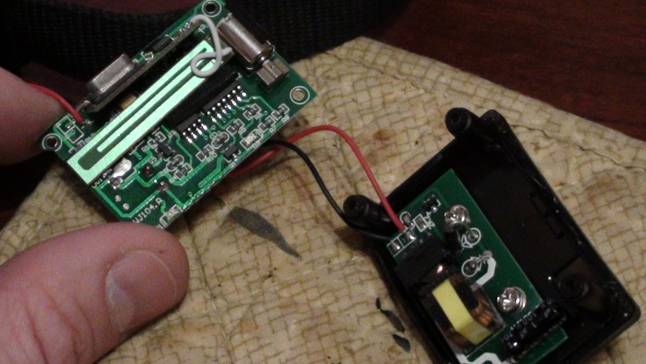

        get it open, lets see the guts.
        it must have a coil or transformer to step the voltage up.
        btw, the police will shoot it on sight if it's loose outdoors.

          Upload good clear pictures of the board.

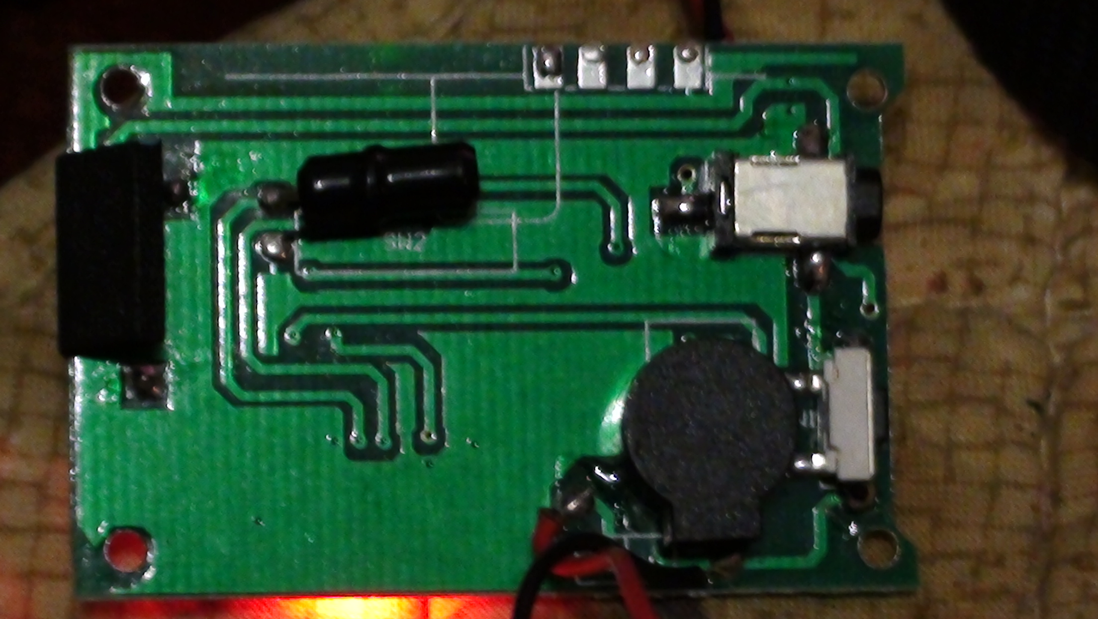

                Re: Questions about modding a "Dog Training System"
                Should I upload pictures of the collar or the remote that controls the collar?

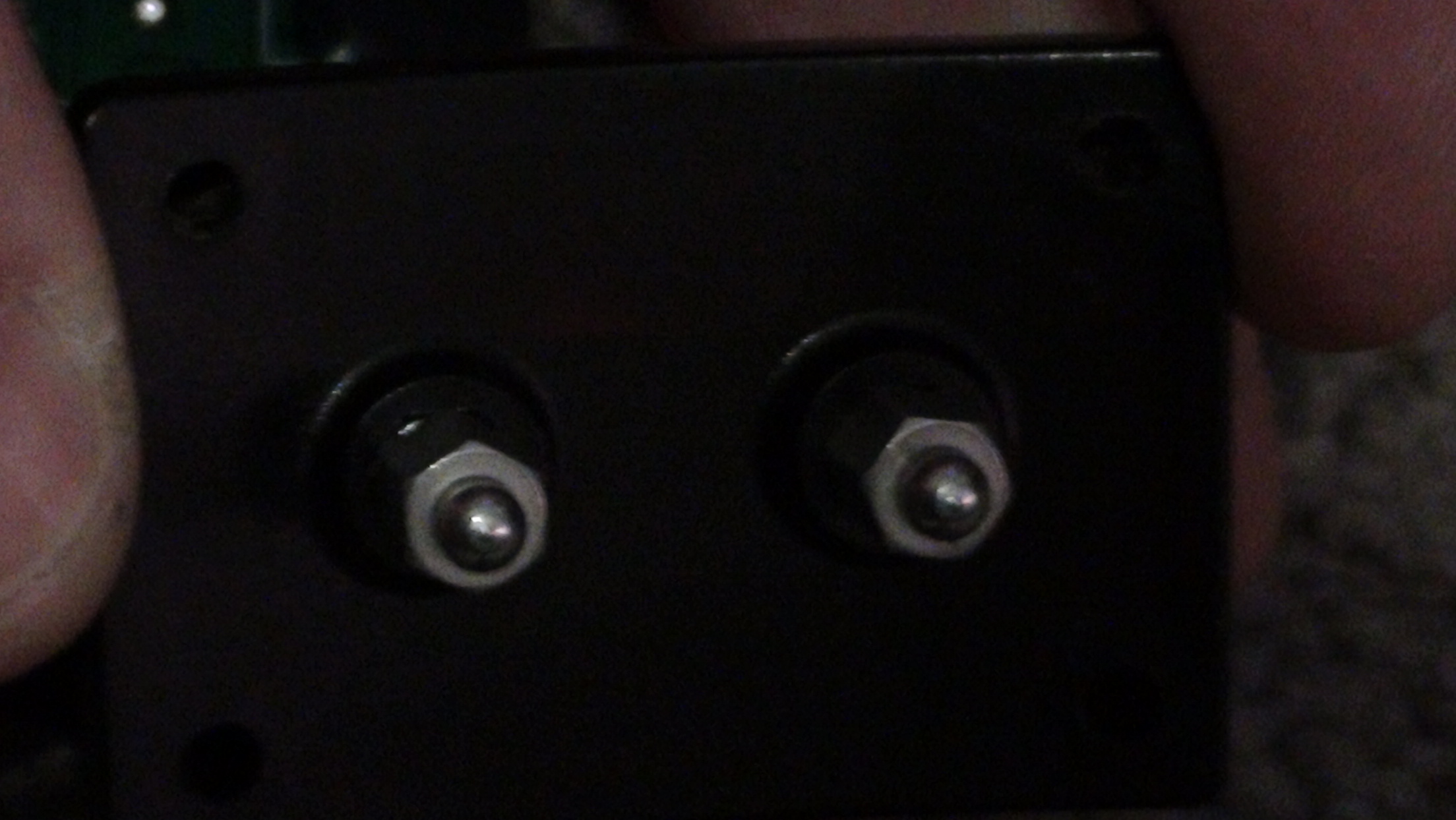

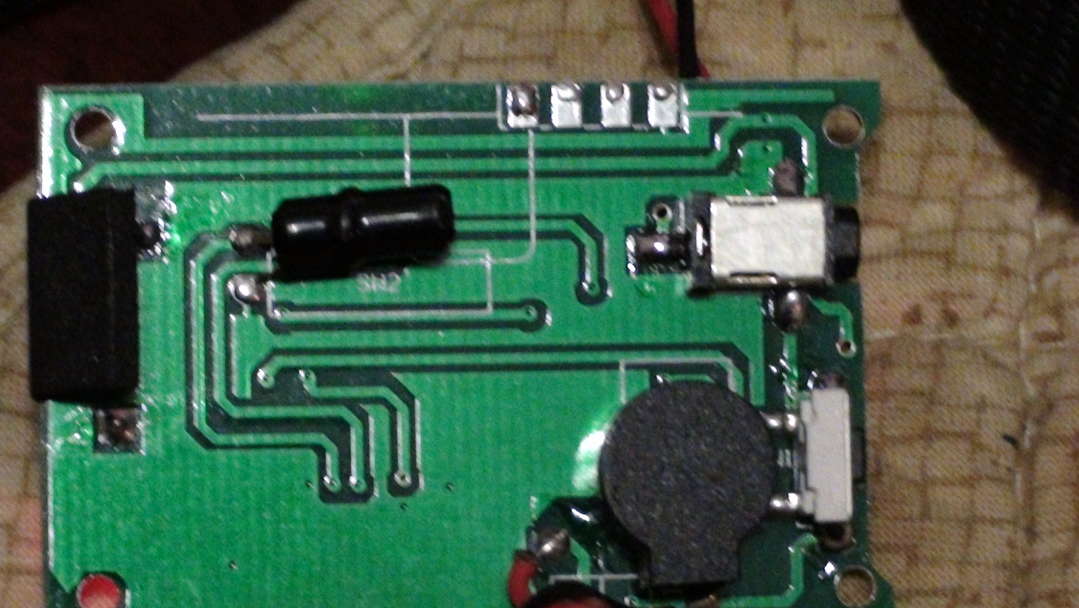

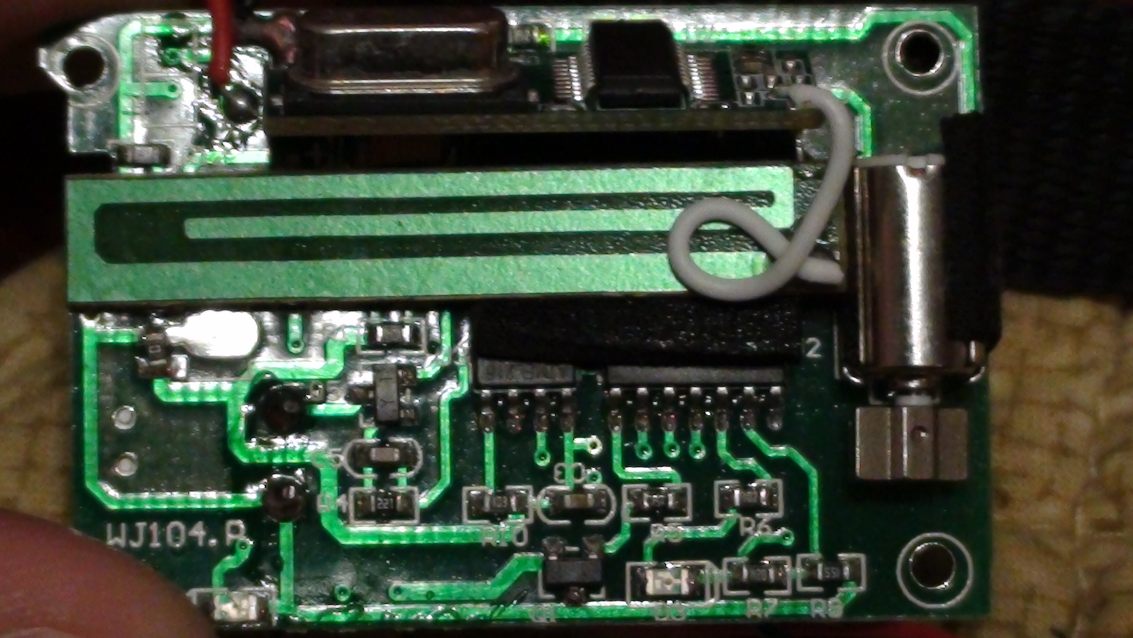

                  I think I figured this out. There's two parts to the collar. There's a battery and then two circuit boards. One of the circuit boards has those metal things that shock. The other circuit board is connected to that board with a red and black wire. That circuit board has the vibrator thingamajig, something that appears to be perhaps the speaker. Not too worried about the blinking LED but I believe that's part of the circuit board without the shockers.
                  I wish there was away to hook the shocker thing up to the remote and if he goes to shock the dog again, he gets shocked instead.
                  I know it's not right to tell on people but I think there's certain times when it's okay. Like if a child is being abused or an animal. Even though some people might disagree with me and call me a narc, I went and told my mum when I heard the dog yelping and her boyfriend laughing about it to his friend. I told her not to tell him that I said anything and just to pretend that she heard the dog. She freaked out and called my sister and yelled. My sister yelled at her boyfriend but it happened again until I stole the collar. He just tried doing it when he thought no one was around watching.

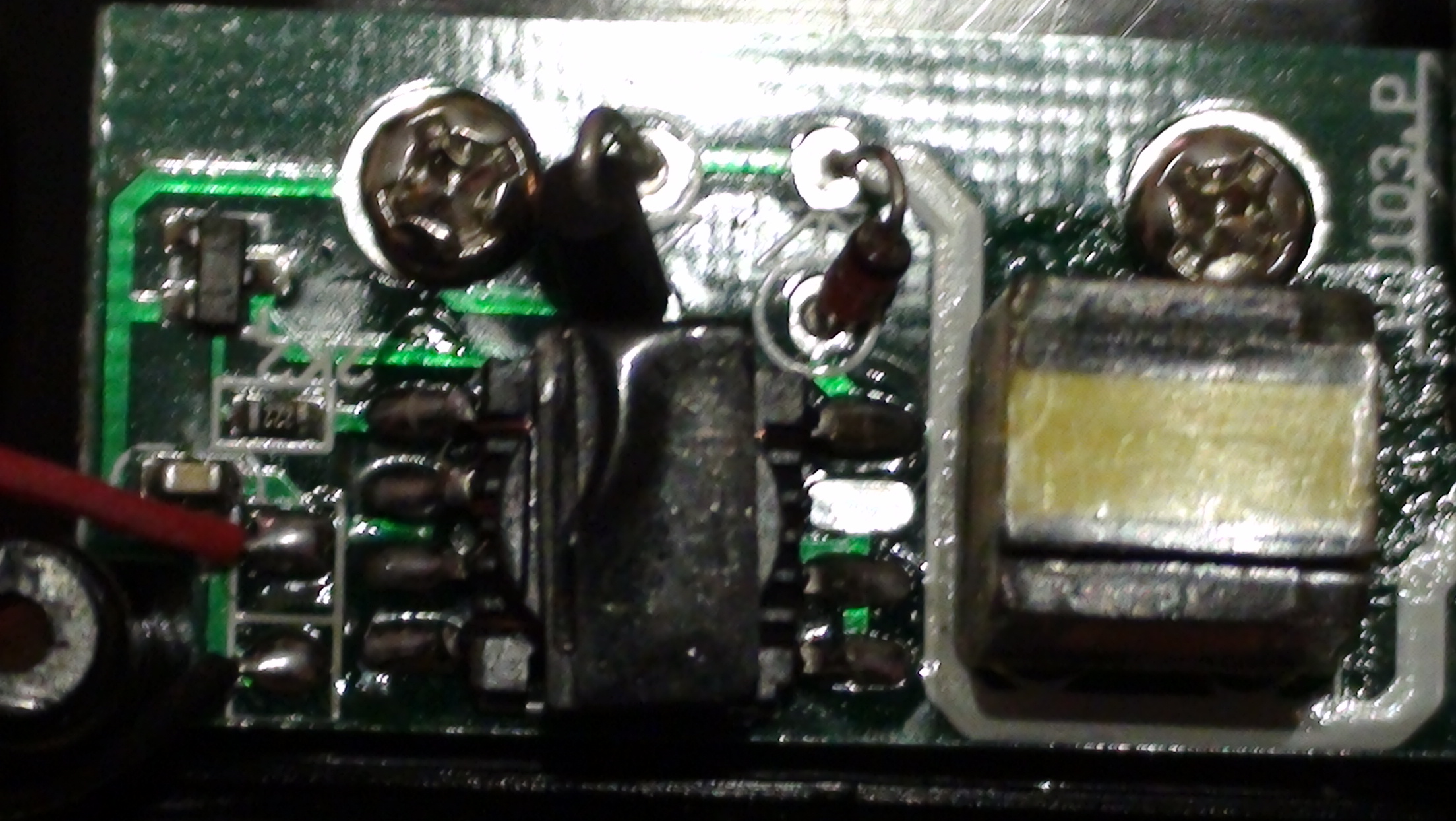

                    The one with the transformer looking device and the two screws is the one that has the metal prongs that shock. I think if I just unsolder the red and black wires, I'd be good. What do you guys think?
                      yea, it looks self-contained.
                      remove the pcb with the transformers on it - put the screws back after so it looks untouched on the outside.
                      while your at it, put a volt-meter and/or scope on those wires and see how it's powered at each shock level - so you can re-use it for something else.

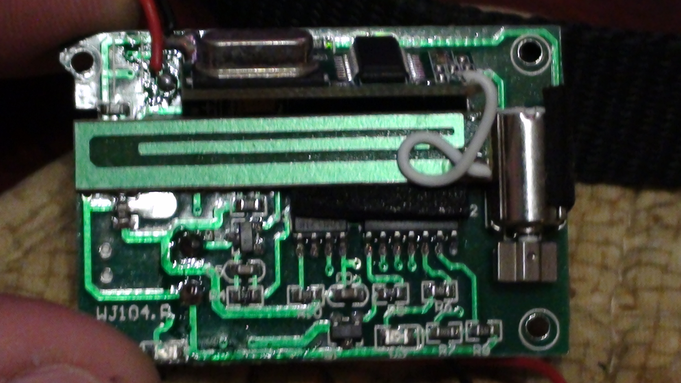

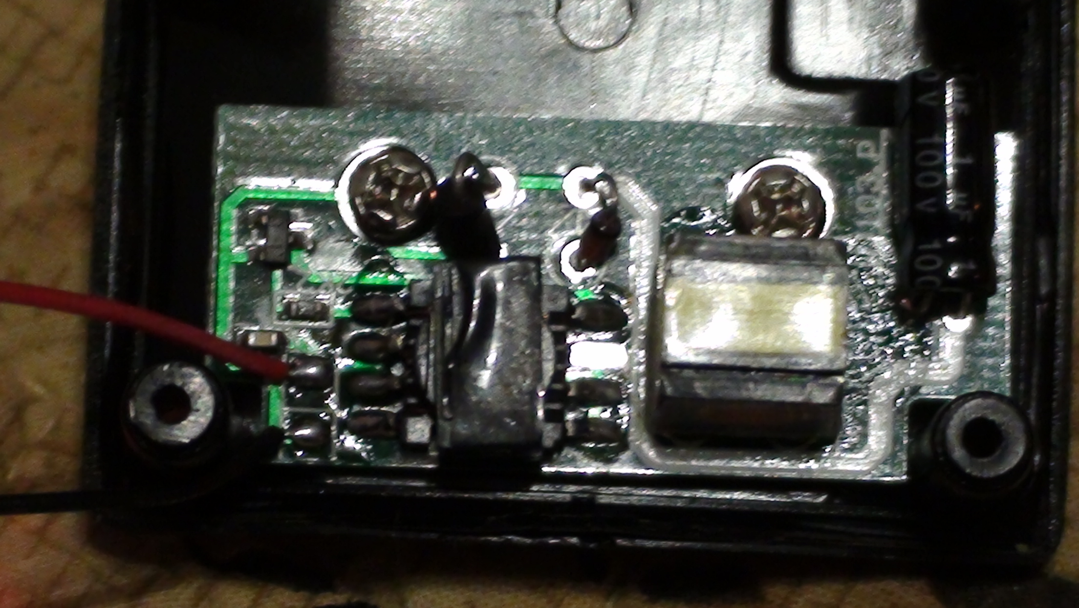

                          Success! And you can't even tell I took it apart, minus the fact it won't cause physical pain to the dog or anyone anymore! I do have to admit, this is the first time I took something apart to break it!
                          Thank you for all the help guys! I just unsoldered the red and black wires and removed them completely from the collar. Vibrate still works, sound works, and of course the blinking light. Just no more shocking.
                          For the voltage levels that go to the shocking board, at the lowest level, 1, it's 1.7VDC. I left the shocking board in there, just unhooked. I measured it out though. This is what I got:
                          Code:
                          level voltage
                           1  1.7VDC
                           25  2.2VDC
                           50  2.7VDC
                           75  3.2VDC
                          100  3.7VDC
                          The voltage was bouncing a bit. I figure every 5 levels, it's going up .1VDC. Every 25 levels, it appears to be going up .5VDC.

                            Well, if you had removed the board you might be able to install it in the remote so he shocks himself.
                            sigpicThe Sky Is Falling
                              • 31015
                              i was thinking it could be built into a small flashlight or something - micro-stungun for free!
                              it's possible those voltages arent dc though, it could be pwm drive or something.
                                I was trying to figure out how they were sending different voltages to the unit. With PICs, I know you can change some of the I/O pins to input / output, stuff like that. But I don't think you can say stuff like like I/O pin 1 = Output, 1.5VDC. Then I/O pin 1 = Output, 1.6VDC, then I/O pin 1 = Output, 1.7VDC, etc.
                                -- Law of Expanding Memory: Applications Will Also Expand Until RAM Is Full
                                  • 31015
                                  you can if the chip has D-A convertors in it.
                                  what pic is it?

                                        I don't know if it has a PIC. I gave it back today. I can look at the pictures tomorrow and see if I see anything on there that resembles one. I just know a little bit about PICs and didn't think it was possible, from what I've learned, with PICs. Good to know that PICs with D-A convertors can produce varying degrees of output voltage. Maybe we can discuss this more in a private message so the thread doesn't get off-topic? Or maybe we could create a new thread to share the info with others.
