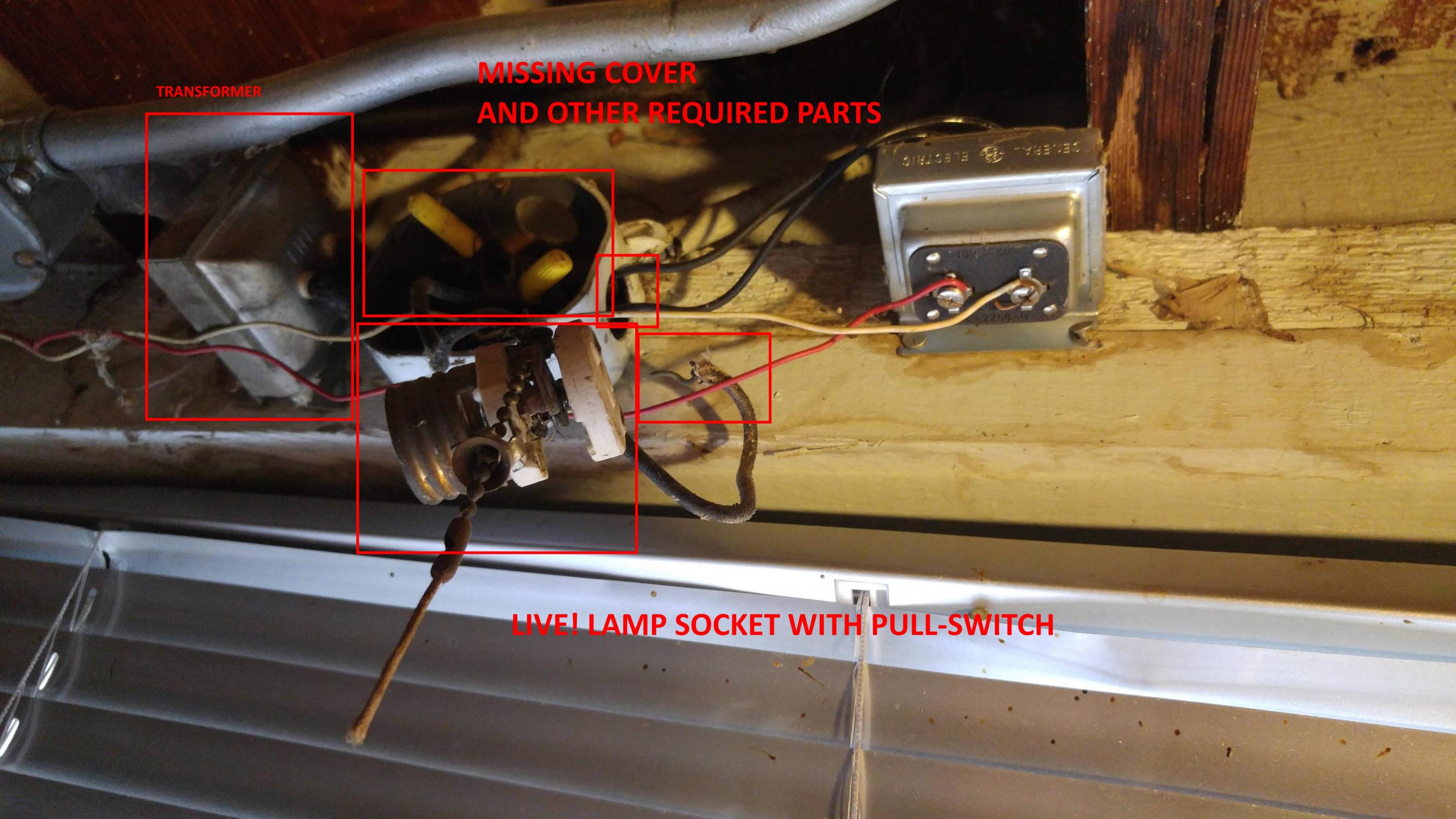

              Re: Doorbell Chime and Doorbell Button wiring
              A few pictures taken earlier today as I only visit the garage once in a blue moon since the garage door opener doesn't work so we never opened the garage door yet in the 7 years we've been here:
              This is what the top of one of the windows in the garage looks like:
              What is that thing all the way on the left? The transformer itself appears to be a General Electric, think it says 10volts but not sure what the current is unless you can see it on the picture.
              This is where the chime is supposed to be but the house did not come with a chime:
              and this is the outside where the doorbell is supposed to be except the doorbell is missing too so only the wires are there:
              So atleast it would seem the red wire we know is hopefully connected to the transformer at where the chime is as it's the same type of jacket which is different than what's outside where the doorbell is.

                Had to look at the transformer closer today and it appears to be a 10V 5VA. The thing on the left seems like another transformer as basically it has terminals on the other side without wires attached, it was probably the previous transformer used. In any case, all the chimes sold at hardware stores I have seen requires 16V 10VA, will it still work at 10V 5VA except not be as loud?
                    FIRST thing I would do is to get the Certified Professional Electrician to clean up that area before you get yourself killed.
                      Now you know why I want to do it the other way as the existing house will be gone in one or two years since everything will be torn down as part of the rennovation that will expand the house both vertically and horizontally as there will be a floor added and the house will be longer in length. The other way is less risky and all I really need is the wire, transformer, a grounded plug for the 120VAC side to the wall and the resistor, the resistor is the one that I want to get something that is good and also small in size.
                      Just looked at your comments, and I agree with you 100%, that's one reason I had not even try to touch anything in that area and used another light that plugged into a AC outlet instead as it seems dangerous.
                          Even if you are going to renovate the house in a couple of years I would not let that exposed hot wires and socket sitting like that, who knows what else was done wrong like no circuit breaker for that branch, or wrong hot and neutral wiring, etc. and you may end up with burnt down house.
                            Good point, I'll deal with that one separately but for now, have to get the ring.com doorbell hardwired. And you are actually right, lots of things are wrong because the person that bought the house in 2004 got foreclosed while remodeling in 2006 and the person who bought the house at a auction got foreclosed in 2008 before I bought it on the open market. The external hose faucet has no water. The only hose faucet is inside the garage right next to the water main shutoff. All the AC does have reverse polarity. That's why I said it's not easy to fix without tearing all the walls apart because even the telephone demarcation point is inside the sealed walls that even telco won't touch as they just cut off the wire on the outside and mounted a new box instead. Contractors and electricians all said to not fix it and just let the renovation take place as everything including plumbing and electrical will need to be completely redone.
