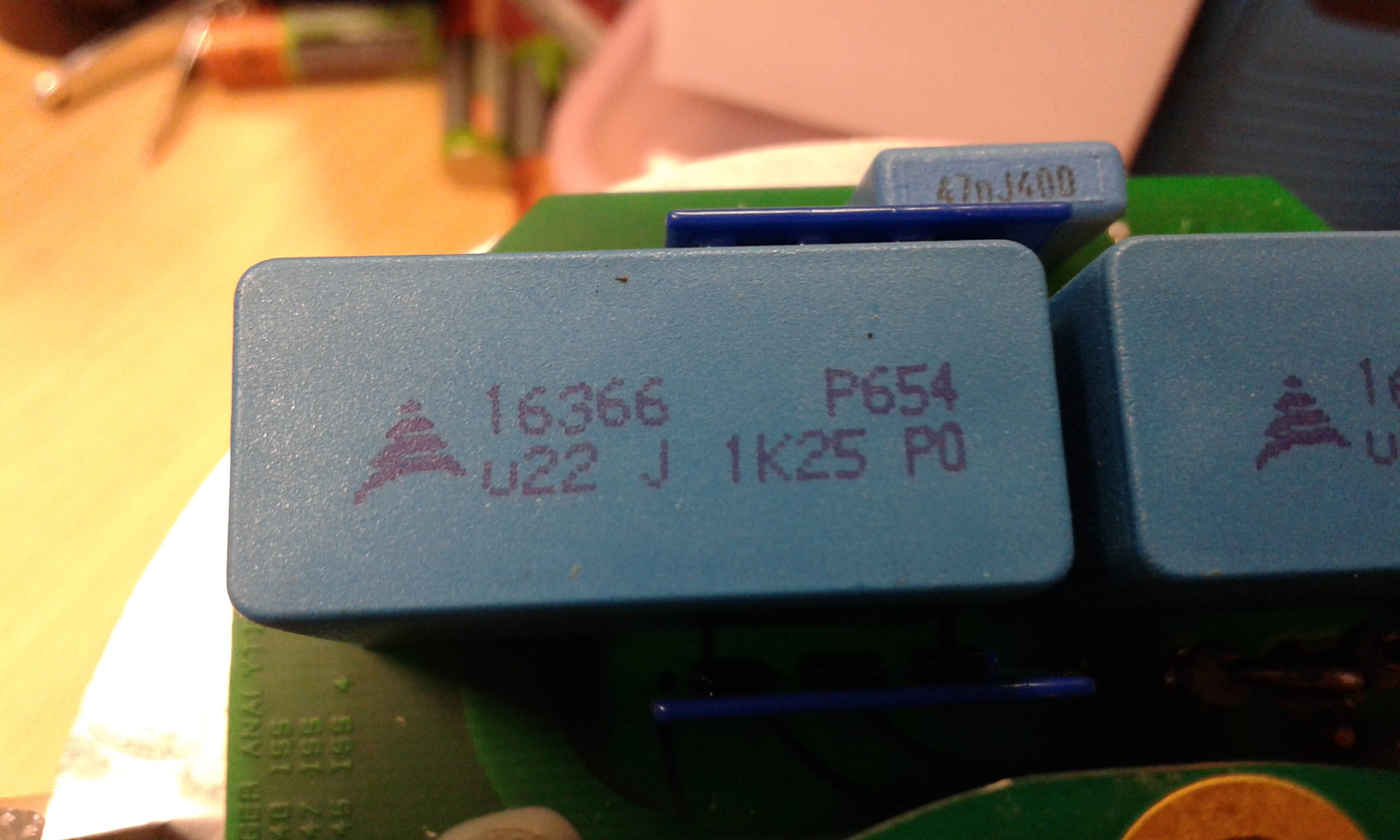

    I have a doubt about these two caps and I need your help...
    47n = ? Capmeter measures 47nanoF
    v22= ? Capmeter measures 221nF ...
    I dont think its right.... At least the 2nd one...
    Regards, thanks in advance...

    u22 is probably 0.22uf
    aka 220nf

      1K25 means 1250 V ?
        • 31139
        Re: component Cap identify
        probably not,
        i suspect the letter J relates to the voltage.

          Nothing printed on the side?
          It looks like EPCOS/TDK capacitor.
          Pictures of the whole board top and bottom sides?

            J is the capacitance
            K is the voltage
              http://www.tdk-epc.us/
              Nothing printed on side... Never seen any like these...
              I'll take some fotos of the board, tomorrow at work.
              And, yes I've followed the link you gave, and the symbol matches the one printed on the capacitor. I ll go browse deeper Thks

                Looks just like this
                http://uk.rs-online.com/web/p/polypr...itors/1908652/

                  I recognize the logo as Epcos/TDK.
                  They all start with B32xxx part number for their film caps. Newer parts are laser marked instead of this mess.
                  I believe it is a 0.22uF 1,250VDC polypropylene film cap. These caps rarely fail, they are self-healing and pretty tough.
                  u22 = 0.22uF or 220nF
                  P654 = B32654 series
                  1k25 = 1,250VDC
                  J=+/5% tolerance
                  Part number might be: B32654A7224
                  Check the dimensions/size, but it's high-voltage low leakage, high frequency cap for your analyzer.
