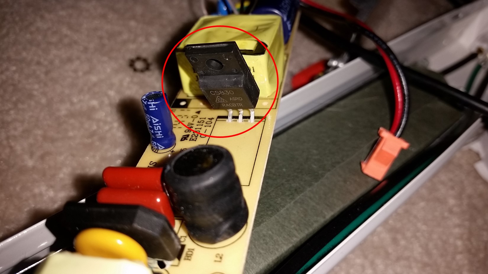

Please find the enclosed picture. In the picture i identify an electrical part outlined with a red circle. Can someone tell me where i can get the data sheet for this part or a suitable replacement part?
Need help identifying replacement part
Re: Need help identifying replacement part
CS830 N-CH MOSFET.
What is the board not doing?Attached FilesNever stop learning
Just type in CS830 in the search engine.Never stop learning
http://www.badcaps.net/forum/showthread.php?t=24809Comment
I use Google's filters:
To reduce the number of hits, I use a search term which usually appears in datasheets but not in other documents:
Edit: The "CS830F A9RD" plastic version (TO-220F) has a power rating of 30W. The "A3RD" version has a higher rating of 75W.
(CS830F A9RD, TO-220F)
(CS830 A8RD, TO-220AB)
(CS830 A4RD, TO-252)
(CS830 A3RD, TO-251)
http://www.crhj.com.cn/cn/product.php?p=8Comment
Wuxi China Resources Huajing Microelectronics Co., Ltd
http://www.crhj.com.cn/cn/index.php
http://www.crhj.com.cn/cn/images/logo.png
http://www.crmicro.com/Home/Comment
