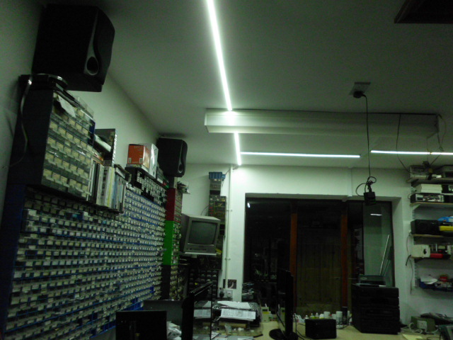

      Here are mine stuck to the ceiling on pvc trunking, you will notice the fluorescent light on the ceiling, as my place is 1700 sq ft I dont have them on any more the whole place is lit with LED s put 12 volt to each end of your strip because if you dont the voltage will be lower at one end and the led s wont be as bright due to voltage drop , my first psu blew as the main reservoir cap dried out so I would replace this as well.

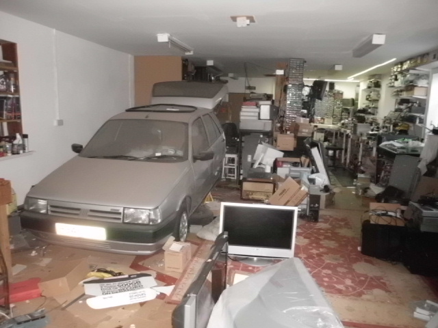

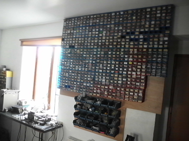

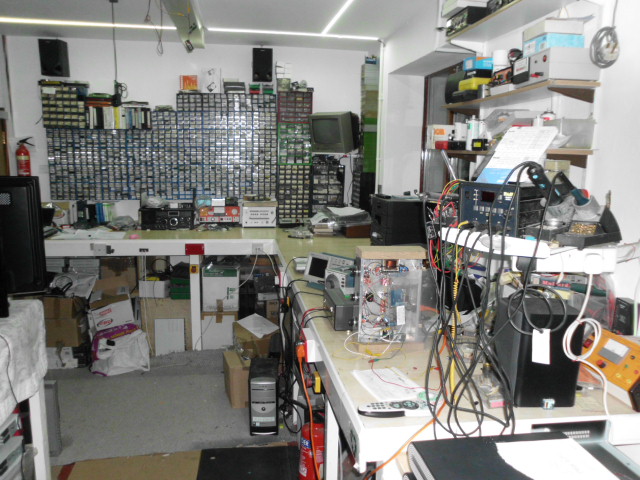

                  Yeah, nice shop Michael, look at all those storage drawers
                  What you see is just a tiny part , I can park 3 cars inside , 4 if I tidied up a bit !
                  Got more semis than a component wholesaler, the back room has no place left on the walls for any more draws !
                  I will post some pics tomorrow .

                                  Oh wow, i always get a nice warm glow when i have the components to hand and don't have to order. Must be cool to have just about everything you'll ever need....and more
                                  Might be easier to drive to you than RS in future lol.
                                  Take a look at this , I have to stand on a chair to get to the draws next to the ceiling !
