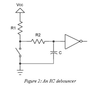

    Purpose of the cap in this RC Debouncer circuit...
    I'm trying to learn how to debounce my push-button switches. I'm looking at the hardware way of doing it right now. I've attached an image but I'm curious as to how the cap is actually working in this schematic.
    When the switch is closed, wouldn't VCC just travel through R1 and R2 to the NOT gate?
    I know that electrolytic caps block DC voltage but allow AC voltage to pass through and I understand why. So, in this diagram here, the cap would charge up and if the circuit was broken, the cap would provide DC and pass it through the NOT gate, right? But the circuit with the cap never gets broken, right? How does the cap actually help to do away with the bouncing effects of a switch?

    Re: Purpose of the cap in this RC Debouncer circuit...
    I think I might understand now. I was forgetting about the anode / cathode on the cap. When the switch isn't closed, the circuit is broke, the cap can never charge, right? VCC can't go through the caps anode terminal and then down through the cathode terminal to get to ground, right? The cap would only charge up when the switch is closed, is that right?
      Uh...
      Analyze this way: Treat the inverter's input as mostly an open circuit, so basically ignore the inverter for now (not exactly the right model, but close enough). The voltage across the cap is what is fed in the inverter.
      The key to this is that the voltage across a cap cannot change instantaneously, unless it is a BAD CAP.
      Now case 1: switch is open (not pressed). Basically you end up with two resistors in series and capacitor. The capacitor will eventually charge up to VCC, no questions about that. When the cap voltage rises above the flip point of the inverter, the output goes low.
      Case 2: the switch is pressed. In this case R1 is shorted to ground and does nothing except eat power. R2 is now parallel with the capacitor, so it also starts discharging the capacitor. Capacitor voltage will go down and eventually hit GND. When the voltage drops below the trip point of the inverter, the inverter will flip high.
      The reason for the cap? The cap is there to make sure the amount of time that the switch is bouncing is shorter than the amount of time to charge/discharge the cap so that it's hidden in the scheme of things.
        Okay, thank you eccerr0r. So the point of R1 is just so VCC isn't connected directly to ground when the flip is switched? It's just a load that drops the voltage before hitting ground? R2 and the value of the cap is what determines how long the inverter stays high? Longer bounce, different values, right?

          I'm looking at a formula, here: http://www.ganssle.com/debouncing-pt2.htm
          that shows the formula on how to calculate how long it takes to discharge a cap. They rearrange the formula so we can calculate what resistor value I need to do away with the bounce. The formula, rearranged is:
          Code:
          [FONT="Courier New"]
          R =  -t
          C(ln(Vth/Vinitial))
          [/FONT]
          t is the time of the bounce, in seconds. To be generous, we put 20 milliseconds, or 0.02 seconds.
          C is the value of the capacitor, in farads. They use 0.1 uF, or 0.0000001 farads. Vth, they say, is the input hysteresis I think. I'm having trouble finding out how to find this number. In their example, they say the 7414 hex inverter has a Vth, worst case, of 1.7V. Vinitial is the voltage we supply to the circuit, in this case, 5V. Solving the equation, we get:
          Code:
          R =  -0.02
          0.0000001(ln(1.7/5))
          R =  -0.02
          0.0000001*ln(0.34)
          R =  -0.02
          0.0000001*-1.07880966137193
          R =  -0.02
          -0.000000107880966137193
          R = 185389.515093569483385678265672
          or roughly 185K.
          [/FONT]
          Any idea what they mean when they say Vth and where do I find that information in the datasheet? I believe they're using the 74AHCT14 inverter.
          -- Law of Expanding Memory: Applications Will Also Expand Until RAM Is Full

                I think maybe Vth might be the Logical Threshold, where the input and output voltages are equal. Just gotta find where this information is located in the datasheet. I found an old article saying you could calculate it by hooking the output of the inverter up to the input of the inverter and measure it.
