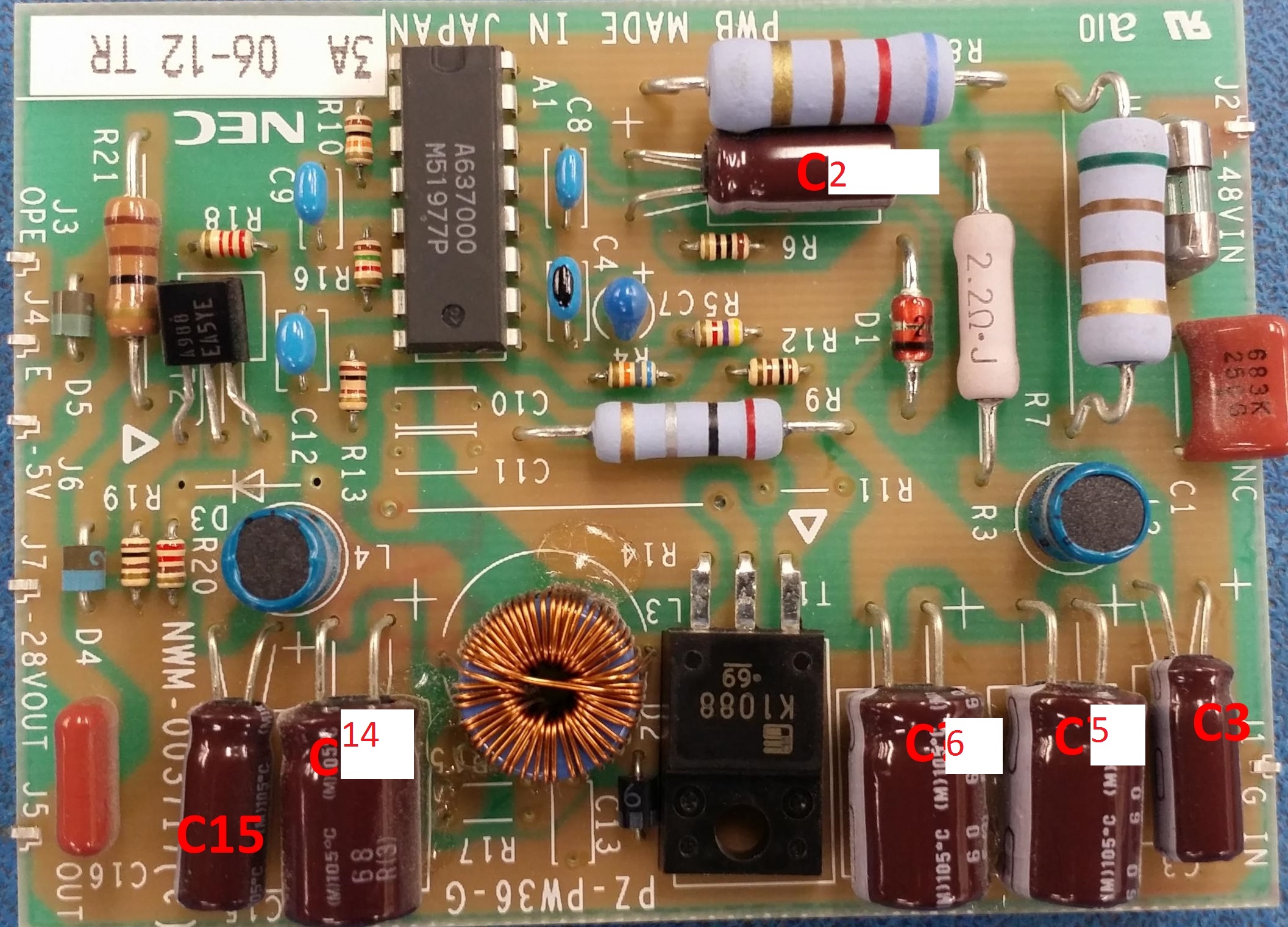

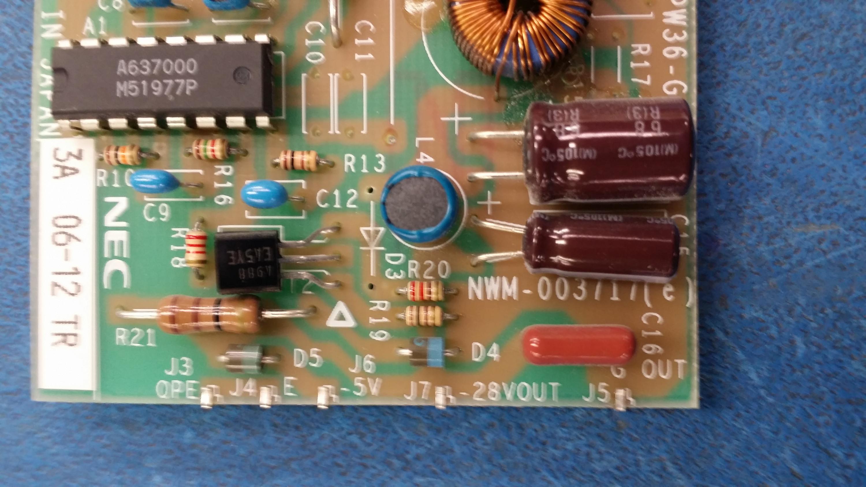

Hey Guys. I have about 10 NEC PA-16LCBJ cards that are dead. The source of the problem is a resistor and a diode on the power daughterboard. I have found the resistor no problem but am having a hard time finding the diode. The following readings is the same diode off of a good card:
It is a Glass diode (hole through) with the markings "301." along the anode side.
It has a forward biased voltage drop of .677.
The body dimensions is 1.85mm W x 2.15 mm L (Anything close could work of course). Here is a pic
