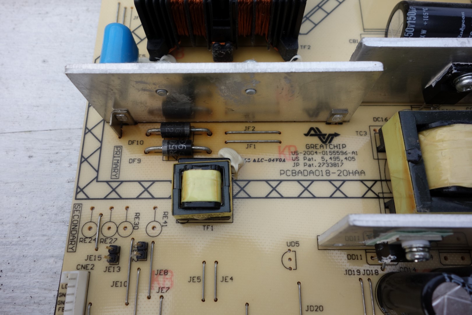

    On an LCD TV, the power supply board works EXCEPT one area with burning signs, in that area there are 4 diodes all tested OK off board, as well as 2 transistors marked K4112, these tested OK only on 2 pins, so, they are BAD.
    I have on hand very similar K3596 transistors, and wondering if this is safe to exchange these two?
    I'm planning to just replace and see if that area of the board puts out the marked 24VDC, and if not, find the exact K4112 transistor..
    Any tips ? how do I find the exact differences (visually they look the same)
    Thanks in advance.
    Stormy

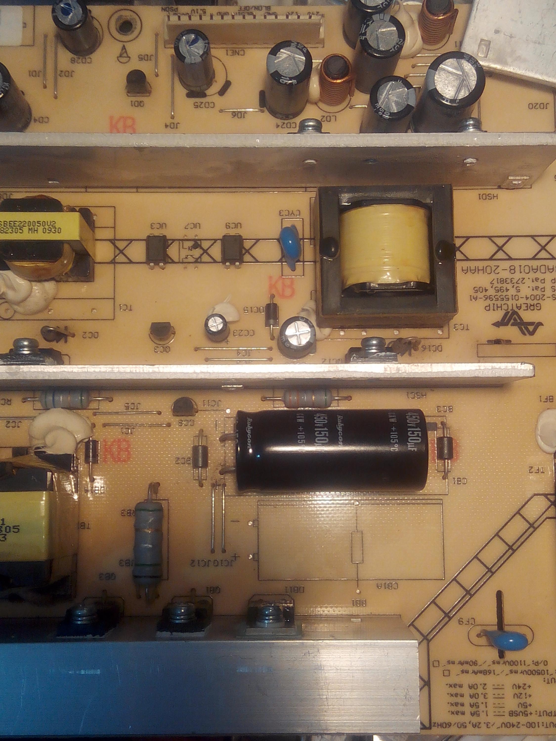

      ok, thanks Steven!!
      I now see it, in that case, I must've tested the K4112 incorrectly, maybe it is good after all...
      Can anyone say? I have no clue how to read the data sheet/specs
      Multimeter in Diode position:
      1) Positive lead on Source (right most), Negative on Drain (middle) => Reading: 470
      2) ALL other combinations show an Open circuit, EXCEPT, see #3
      3) Negative on Source, now TAP positive on GATE (left), and put quickly on Drain, the meter drops from ~1600 down to zero and then open circuit..
      Does this mean this is a good transistor?
      aside from that, not sure what could be wrong, there is the HUGE coil (top left of this photo)
      ( this is not MY board, but looks identical, near the diodes / top left on my board its a bit brown/ burnt)
      Thanks for any tips!!

        Actually, this photo looks more like my board (see brown area on the left side):
          Re: Transistor Replacement K4112 => K3596
          That section is the high Voltage Inverter section for driving the CCFL. there are two POWER MOSFETs mounted on the heatsink.
          So those two MOSFETs do not have low resistance readings between S and D pins, right?

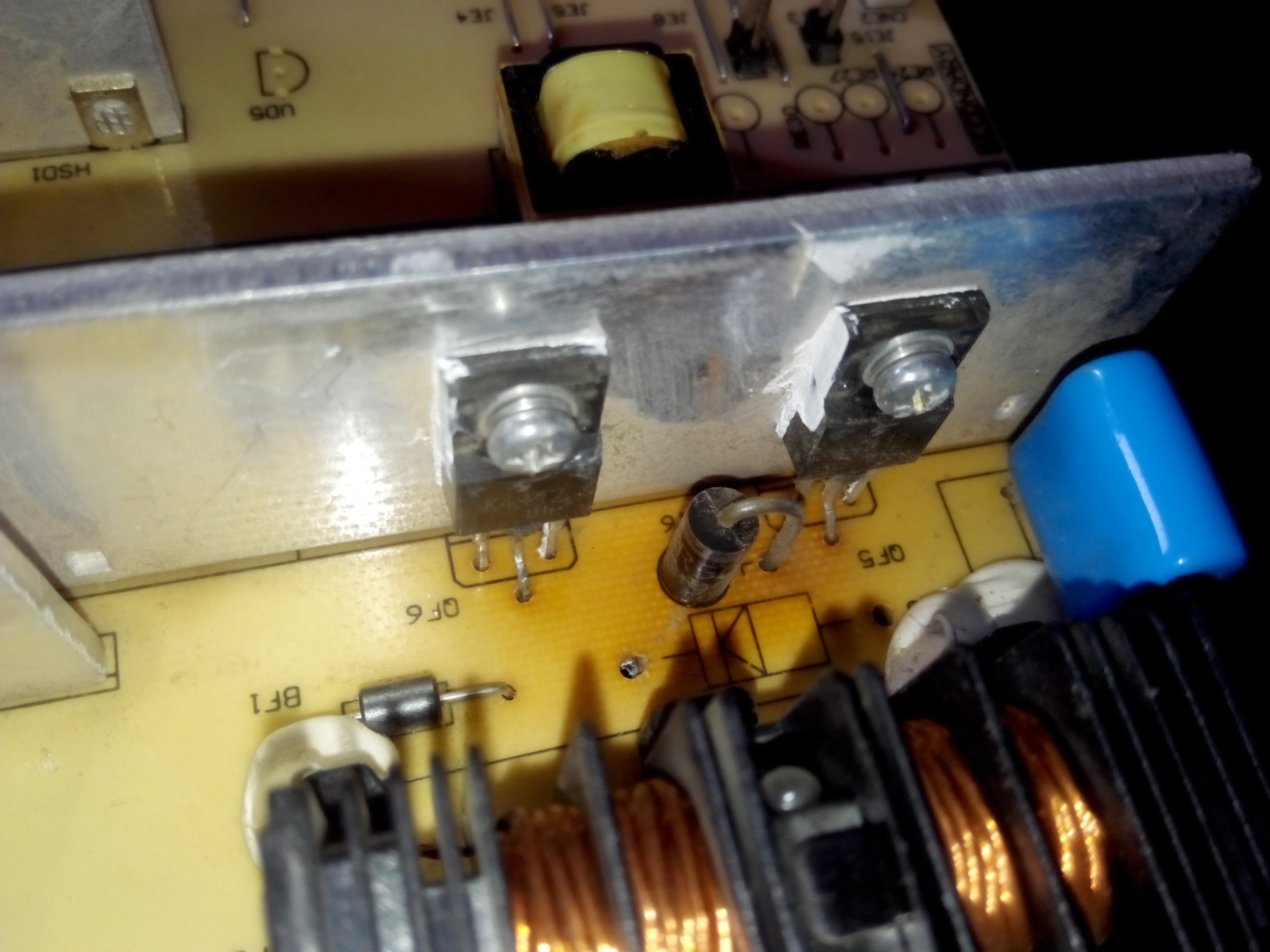

                have you tested that BF1 fuse, (assuming it is a fuse)

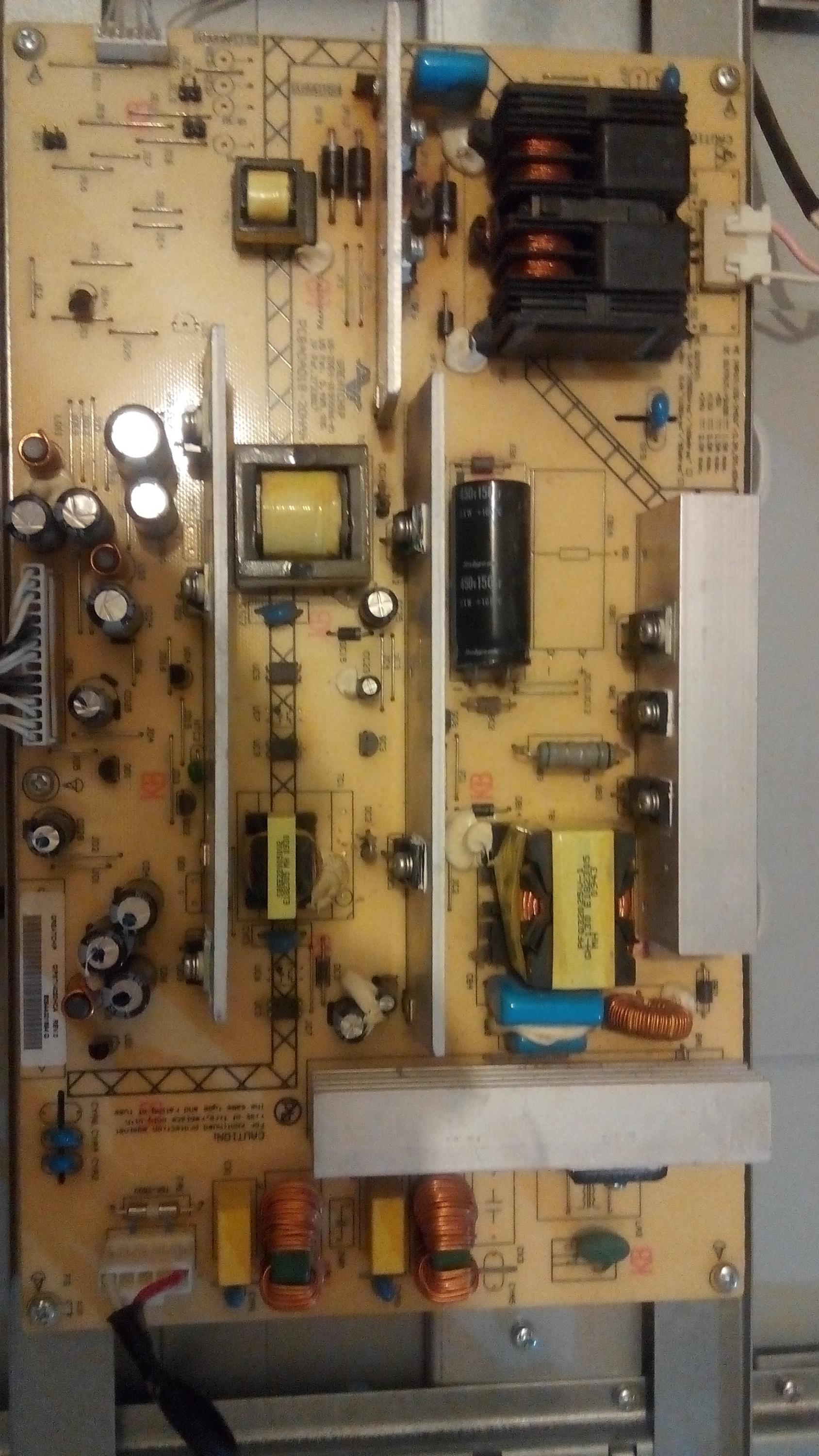

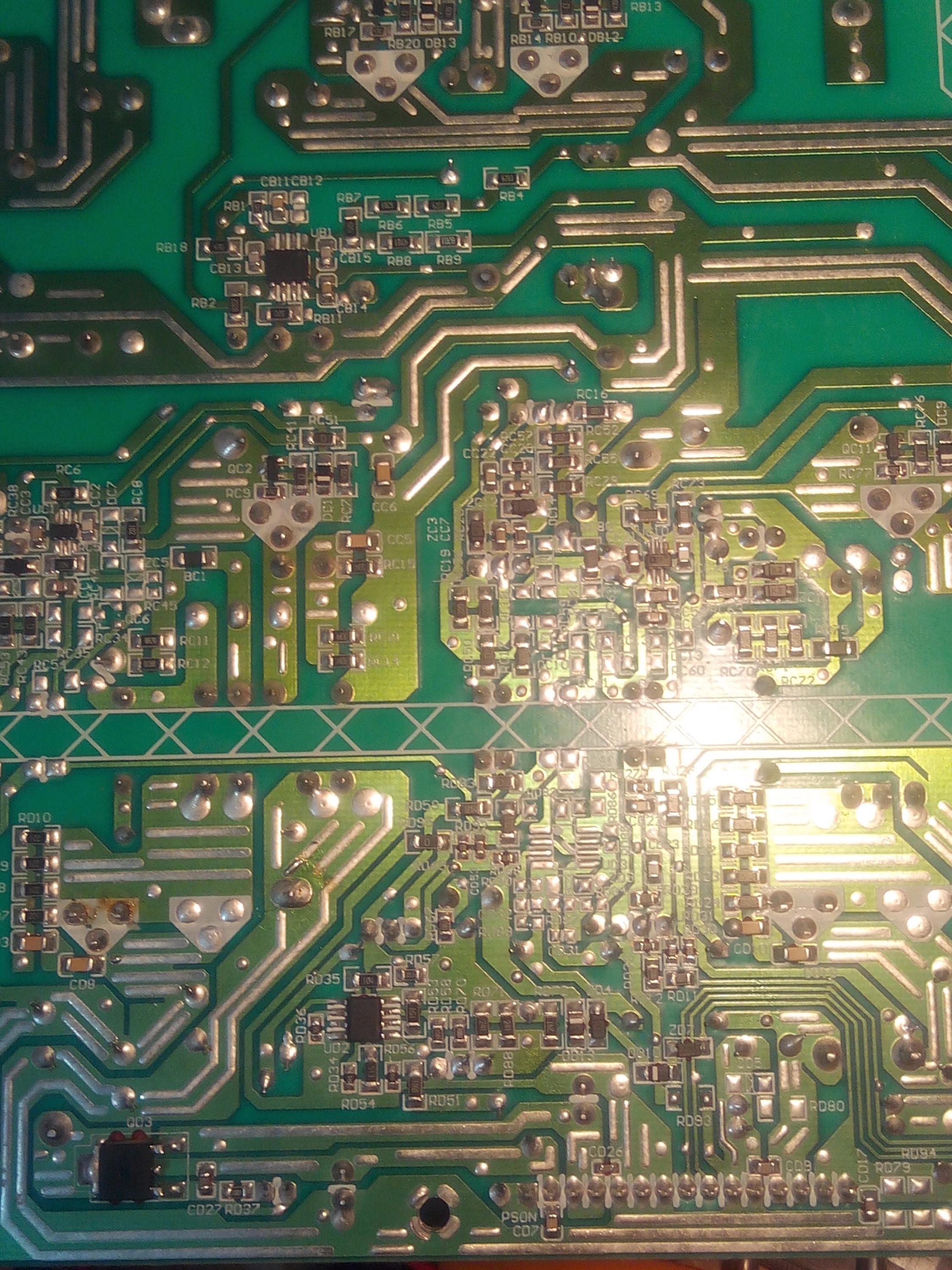

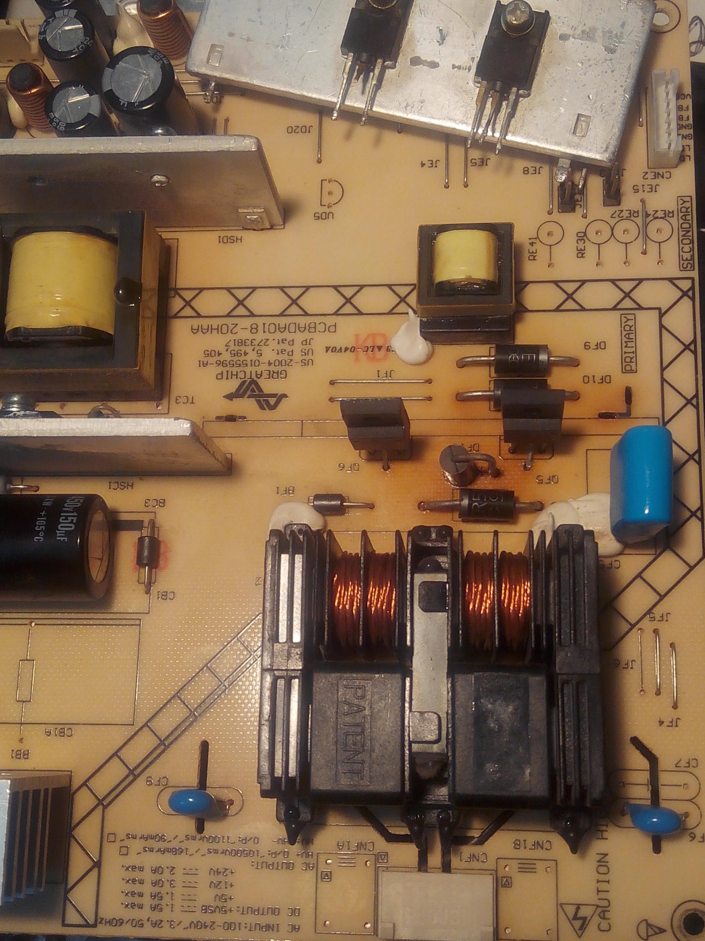

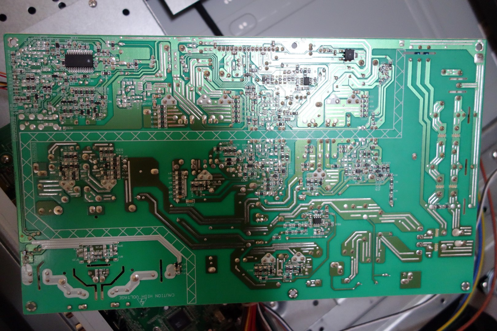

                      Re: Sansui LCT40SD powers ON, but NO backlight
                      I'll try to reply to all changed subject line to reflect revised topic

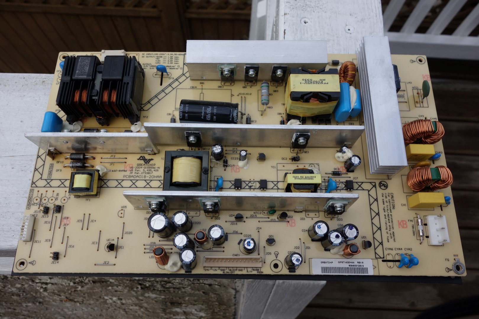

                      1) This is a Sansui 40" LCD TV, model LCT40SD "Sakura", it powers on, but no back light, audio works fine
                      2) BF1, I have no clue what it is, on Diode mode meter BEEPS showing connectivity, same goes on other similar items, like BC3, BC2, externally appearing similar component, if they are fuse, there is connectivity through them..
                      3) I've uploaded a few photos, seems the website reduces the size, but it should still be good enough. the photos are:

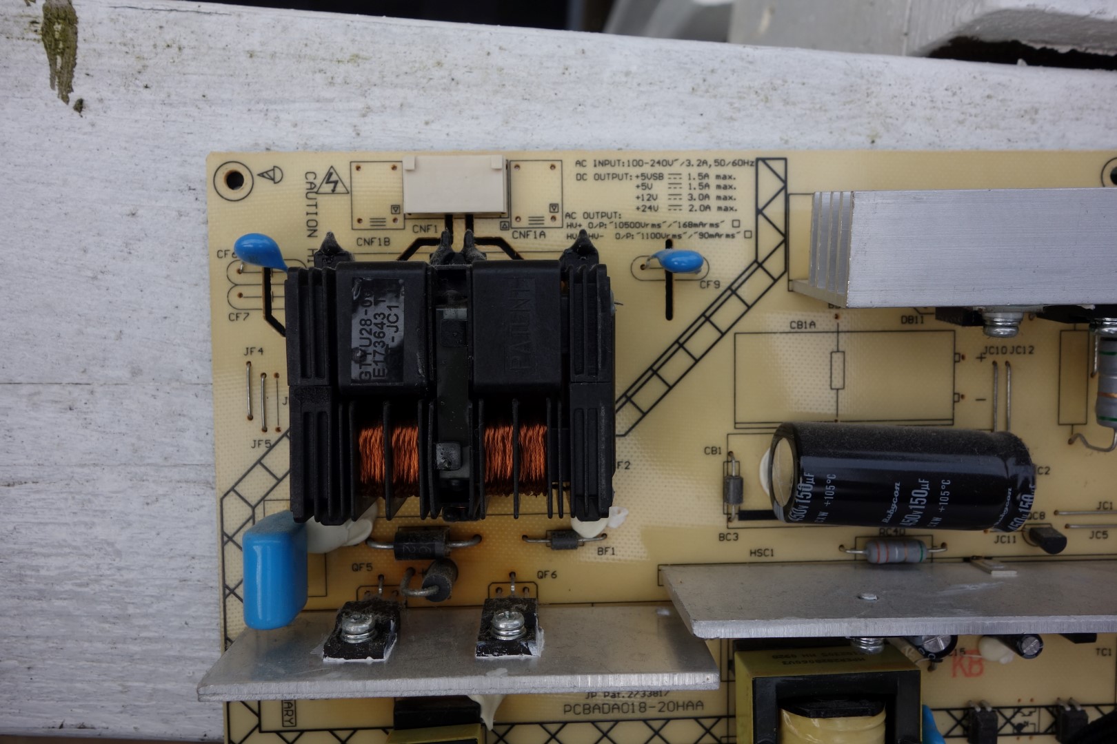

                      3.1) Entire board, with burnt area close to the power inverter (huge black square)
                      3.2) Close up of that burnt area, the diodes and transistors all seem to test OK.
                      3.3) a photo with the original heat-sink + transistors removed, and "similar" transistors in place, i've now removed these, b/c they are incompatible.

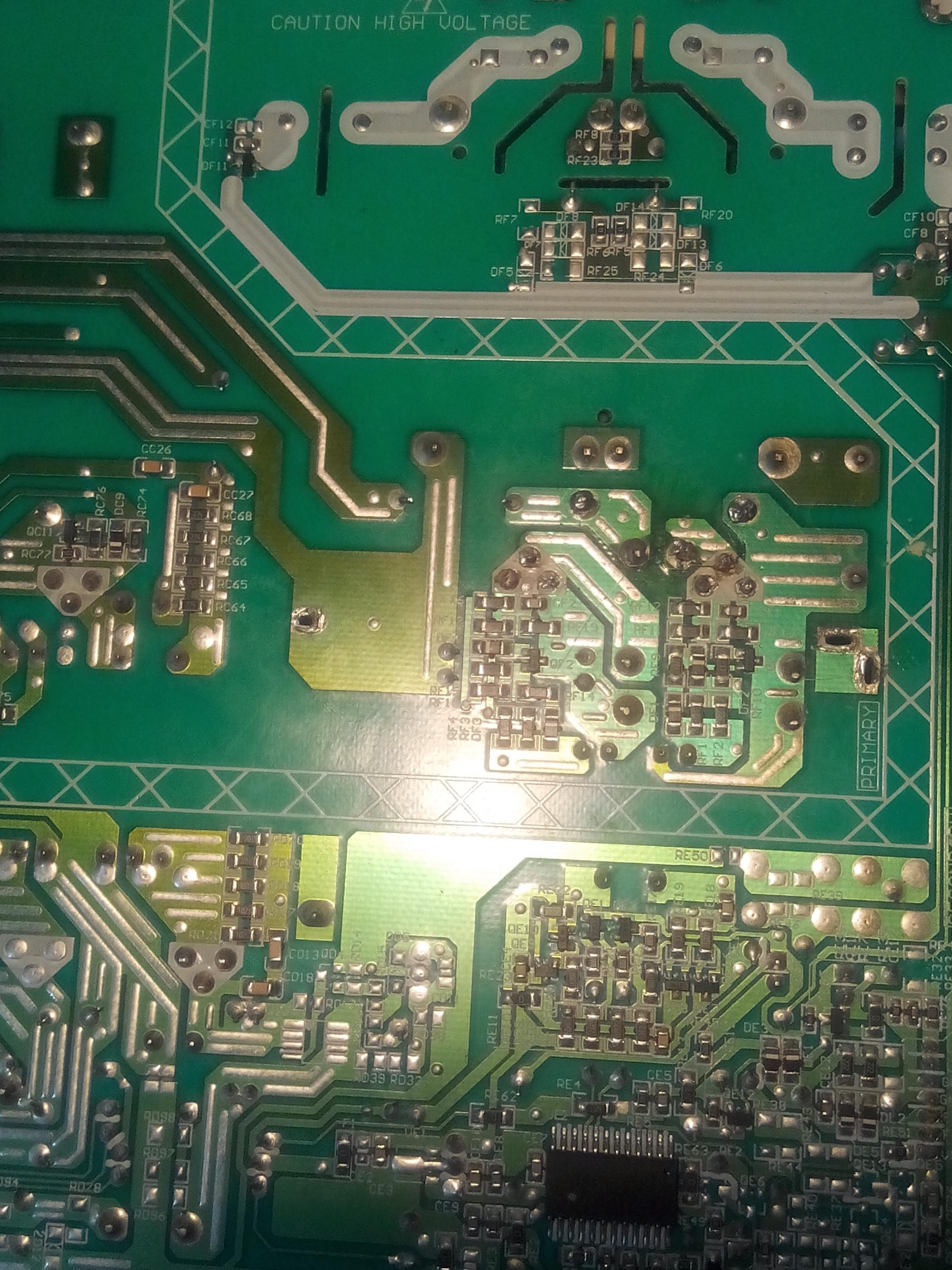

                      3.4) other area of the board... with large capacitor
                      3.5) back of board...
                      4) The CNE2 seems to put out 11.8V (I think only 4 wires are actually connected), so I think that area is OK.
                      5) The CNF1 puts NO VOLTAGE at all, despite TV in ON with green light in front lit.
                      6) I'll post the CNE1 measurements shortly.
                      Thanks.

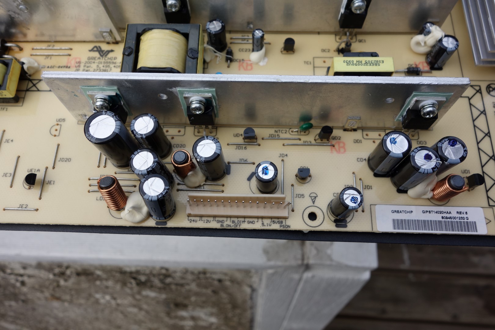

                        CNE1 has 15 pins, with power connected and TV On, the stand by light is NOT on b/c CNE1 15 pin connection is disconnected, for measurements, the voltages are:
                        LEFT most pin marked 24V, comes at 12v, and drops down as I measure, went down to 6V, and probably more, i just kept going..
                        Marked:
                        24v pin 1 - 12V dropping...
                        24v pin 2 - 0v
                        12v pin 3 - 0v
                        12v pin 4 - 0v
                        GND pin 5 - 0v
                        GND pin 6 - 0v
                        BLON/OFF pin 7 - 0v
                        BLDIM pin 8 - 0v
                        GND pin 9 - 0v
                        GND pin 10 - 0v
                        GND pin 11 - 0v
                        5.1V pin 12 - 0v
                        5.1V pin 13 - 5v
                        5USB pin 14 - 5v
                        PSON pin 15 - 0v
                        I'm thinking of getting a use board, but cannot find the EXACT same one..
                        Mine is marked: pcbada018-20haa US-2004-0155596-A1 GIPST14020HCA Rev.0
                        I can only find "GIPST14020HAA" or "GIPST14020HBA", these look very similar, with exception of one small extra yellow capacitor at ZNR1 near the power source, between the two coils, and , the connector for CCFL, in the GIPST14020HCA it is in CNF1 (wide), in the GIPST14020HAA & GIPST14020HBA that connector is in CNF1A (narrow)..
                        For example, an "HBA" board claimed to be working, despite the burnt signs
                        Do you think I can exchange the CNF1 connector from my bad board to one of these used boards?
                        Thanks for any tips.

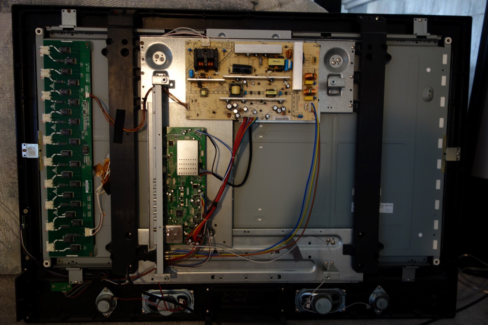

                                    Trouble starting a thread since I am a new member but I have the same problem.
                                    TV is Calypso model CLP-40LC1 40" LCD backlit
                                    Power supply is Greatchip GIPST14020HAA Rev.6
                                    When TV is powered on, indicator LED goes from red to green and backlight flickers on and then shuts off (protection circuitry?)
                                    There is a scorch mark on the white/pink wire from the power supply board to the inverter and the high voltage circuitry on the upper left corner has discoloration. All electrolytic caps are not bulged and look ok.
                                    From this thread, seems like I should replace the transisors mounted on the heatsinks and test the diodes in this area. I have a $15 ESR meter from ebay on the way.
                                      That big long board on the left is the Balancer Board.
                                      You have power supply/inverter board combination.
                                      The pink/white wires carry high Voltage, 1500~2000V.
                                      Which picture show the scorched mark?

                                        The scorch is on the full picture of the back where the high voltage wires are taped down(now burnt off) probably from the heat from the wires. There is a burnt electronics smell with the tv on. The FETs I would like to replace are marked K3569 so 2SK3569. Looks like there are various versions of this power supply board.
