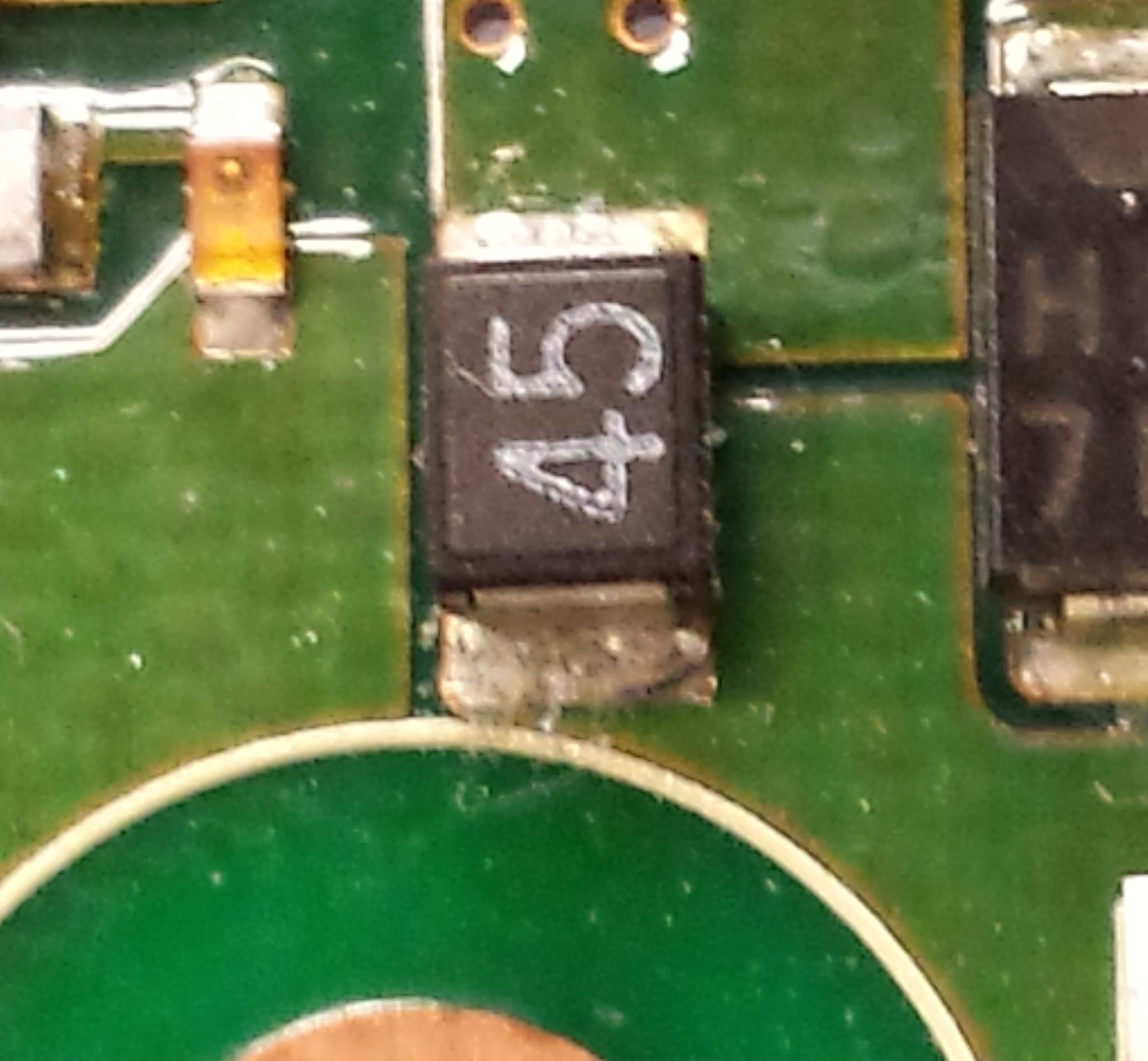

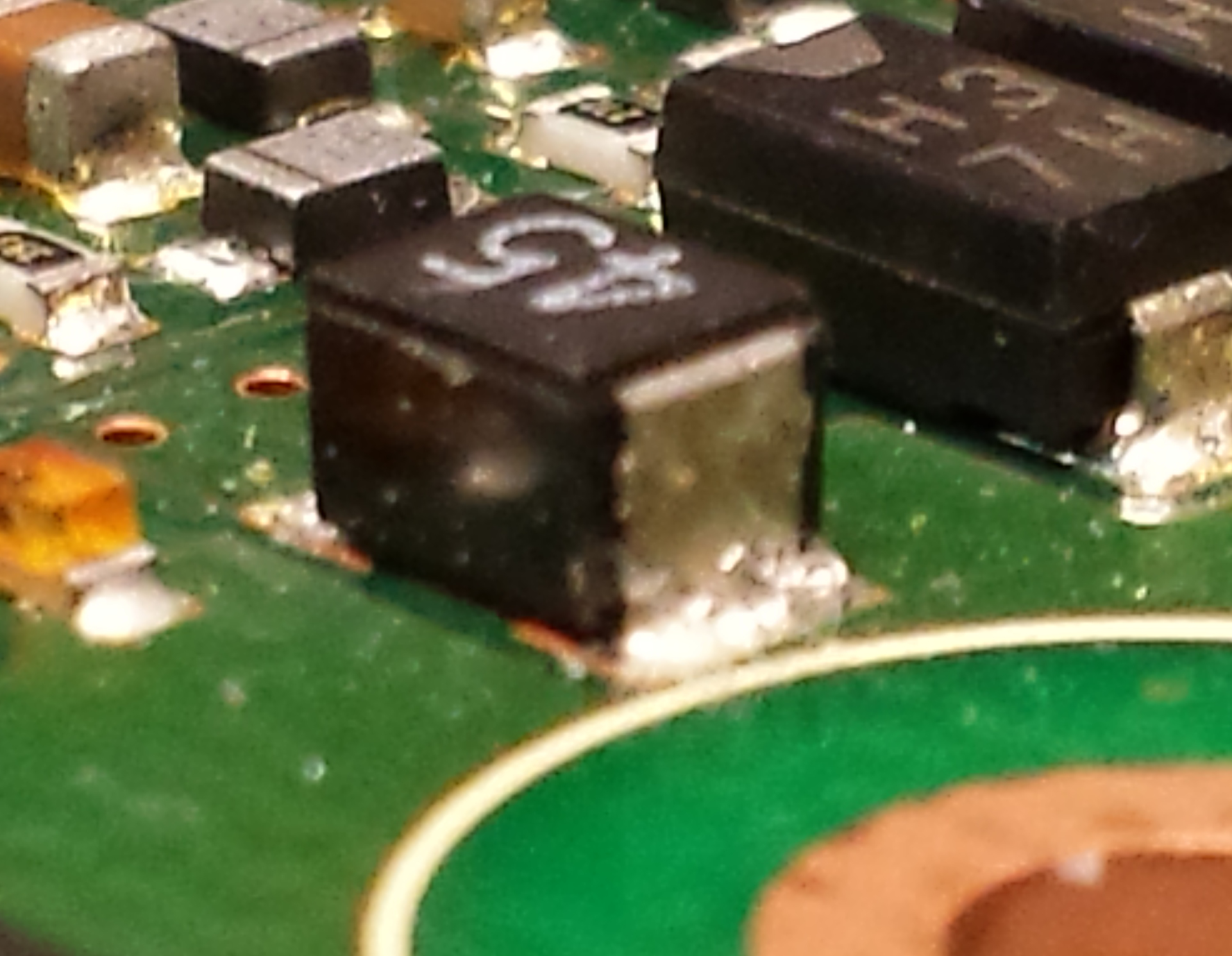

what is this component ?
  • pakcomputers
    • May 2014
    • 6
    The board is an inverter for 4 bulbs on a 15" screen.
    The board is a TDK PCU-P154E inverter.
    The device is marked "45", and it is 2.8 x 2.4mm
    I believe this is a fuse, perhaps 4.5A ???
    It is connected directly to the Vcc into the board and it is open.
    The board draws 1.7 amps, and it seems to function normally when I
    bypass the device.
    Any thoughts on what it is ?

    Re: what is this component ?
    it may be a circuit protector.
    if it is then it's NOT the current on it - you need a datasheet to decode the numbers.
      I just repaired one of these inverters, the current when operating was about 1.8 amps
      Looks like it could be made by KOA, series CCP2 B or E. [45] looks like 2.5 amp current rating, fusing cuurent is 4.5 amps.
      http://www.koaglobal.com/product/fuse
