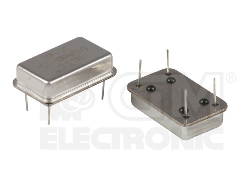

          So, when I take this 12MHz crystal:
          http://www.gme.cz/krystal-hc49-u-q-12mhz-p131-012
          ...and solder it on the legs 2 and 3 (while separating them from the mainboard first by cut & bend up), I should be good to go?
          No difference of witch pins go where? I keep asking just to be absolutely sure.
          And Amiga used this:
          It does not look "all that different" to me?

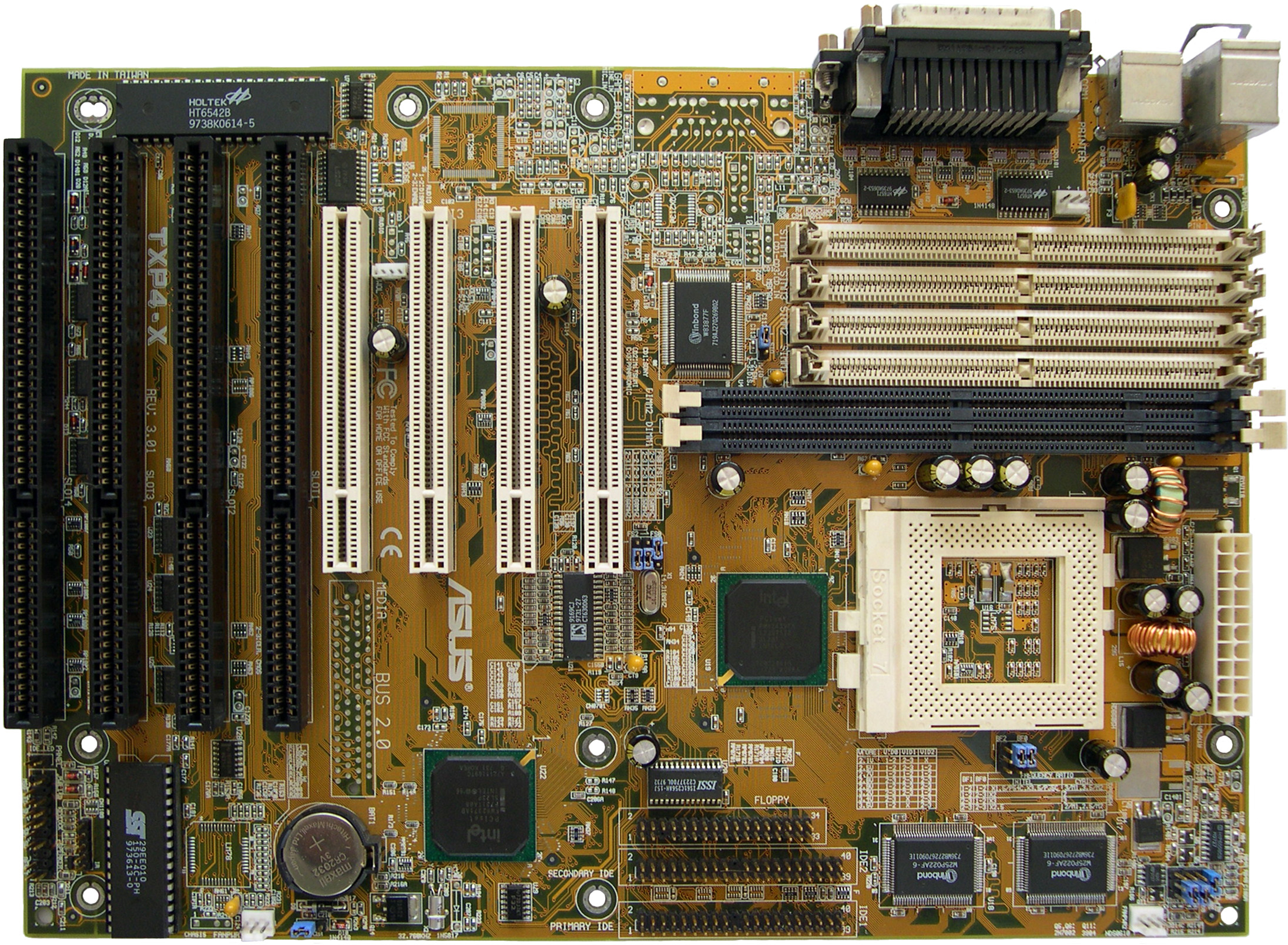

            where is it on that motherboard?
            • fzabkar
              • Mar 2009
              • 772
              Re: 12MHz clock generator for the Holtek HT6542b
              The motherboard has an ICS9169CJ-27 clock generator at U21.
              https://cdn.badcaps-static.com/pdfs/...149ae0f3bd.pdf
              This chip derives the CPU, BUS, 48MHz and 24MHz clocks from the 14.31818 MHz reference crystal. I suspect that the HT6542B's 12MHz clock is generated from either the 24MHz or 48MHz clock via a simple divider in the Intel chipset.

                  Where is what? You gotta say what do you mean by the "it." If you mean the 4 legs crystal I posted, then I mentioned that such things are used on Amiga Blizzard 1260 card:
                  last time I worked with crystals was overclocking on Amiga. CPU accelerator from Phase5 Blizzard 1260 got crystal with 4 legs - Amiga used this:
                  So if you asking about the Blizzard 1260 CPU card for Amiga 1200, then it was there:
                  http://amiga.resource.cx/photos/gall...zard1260-4.jpg
                  If you asking about the mainboard - no, there it is NOT. There is only the 14.3MHz reference clock crystal and the small crystal for the clock near the battery. No more crystals. You can see that on the hi-res picture.
                  But I plan on adding one on the top of the Holtek chip... if you confirm that the pins not matter, then I solder and glue that thing on the microcontroller, so the board will have 3rd crystal

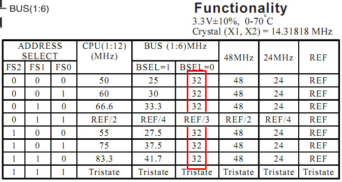

                  Indeed. And since there is no way to software control of the chip:
                  do not have a System Management Bus connection or the FSB could not be set via System Management Bus. So there is and will be no program that supports these PLL's!!! There is absolutely no chance!
                  http://www.cpufsb.de/FSB.HTM
                  ...then what makes me wonder is this:
                  If I understand that right, then it is possible to lock on the PCI bus to 32MHz regardless of the FSB clock. That would allow me to overclock into 83MHz FSB w/o problems (unreliable IDE controller) on the PCI bus...!
                  Selecting BSEL = 0 could be pretty cool mod and I cannot understand, why Asus did not do it already. When using PLL chip that can do PCI lock - it is almost a crime not to utilize that...!

                                  Reporting sucess! I desoldered the complete PS/2 controller Holtek HT6542b from the board, bend up pins 2 and 3, soldered it back and soldered a 12MHz crystal on it, gluing it later to it by epoxide:
                                  (preliminary pics, I did cleared the excessive amounts of tin meanwhile)
                                  And the keyboard & mice worked nicely on all the FSB settings the board can officially (50,55, 60, 66, 75, 83MHz) offer and - what is most important - it does work nicely on the ref /2 superslow 7.14MHz FSB clock!!!
                                  As great bonus, the computer seems to work *MUCH* faster on the superslow clocks. And what is even more important, the 83MHz settings is working well stable for SuperPi 1M: http://hwbot.org/submission/2970070_
                                  ...and it is currently running the SuperPi 32M test at around half and it is therefore pretty stable (SuperPi 32M total run time is about 14-15h (it was 17h on 112.5MHz), so 7h under 100% load stable...
