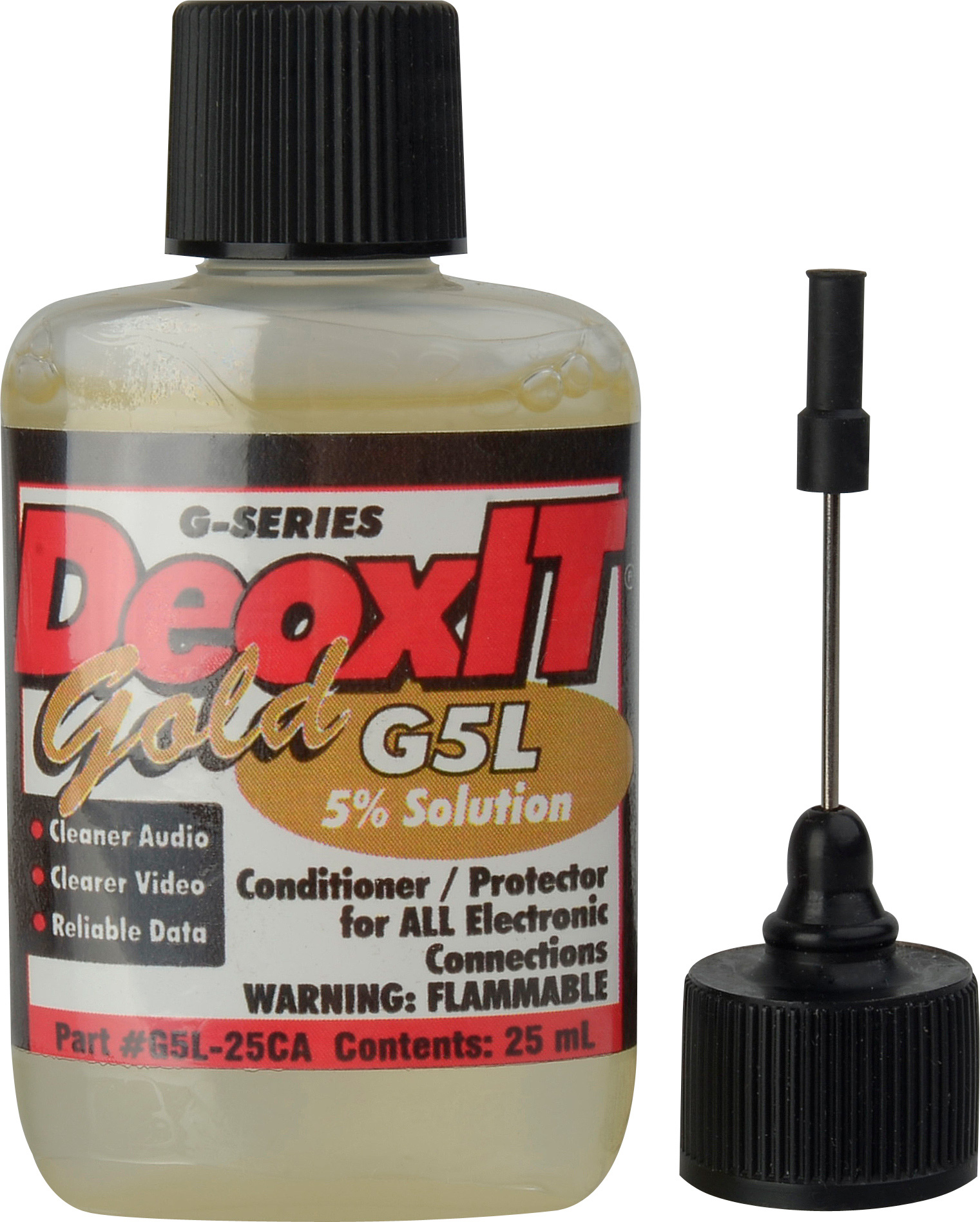

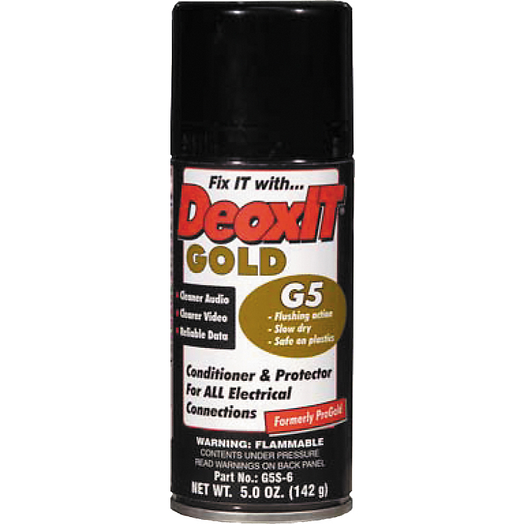

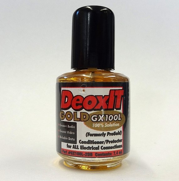

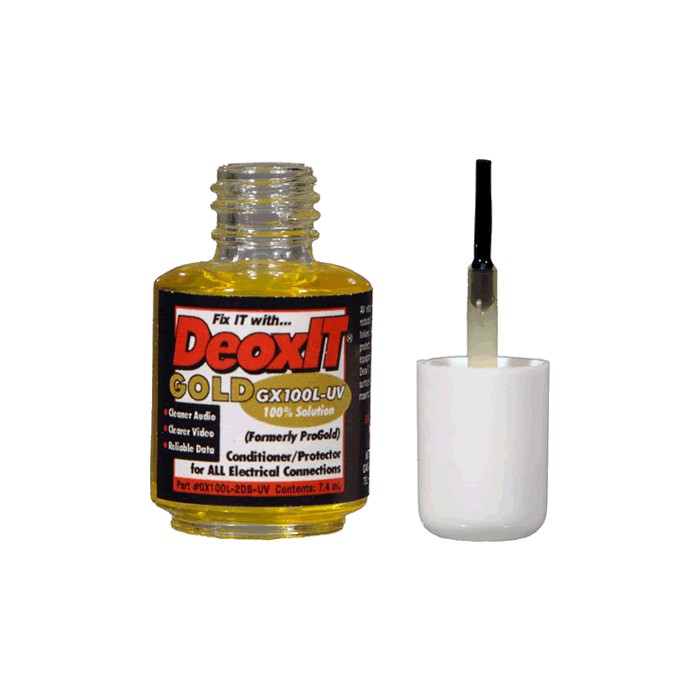

                                        Re: Bad contacts problem. How you deal with it?
                                        This works best for me. Comes in a variety of containers and applicators. I have several switches I cleaned with it 5 years ago and haven't had to clean them since.
