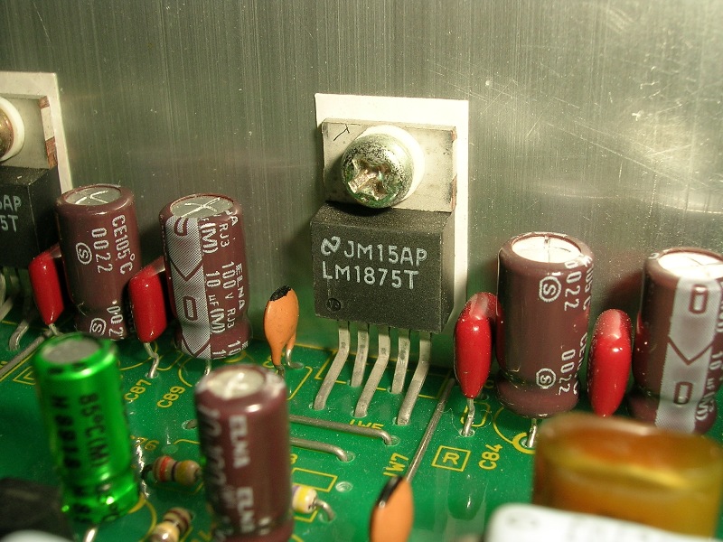

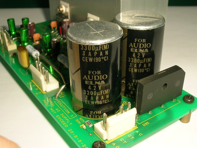

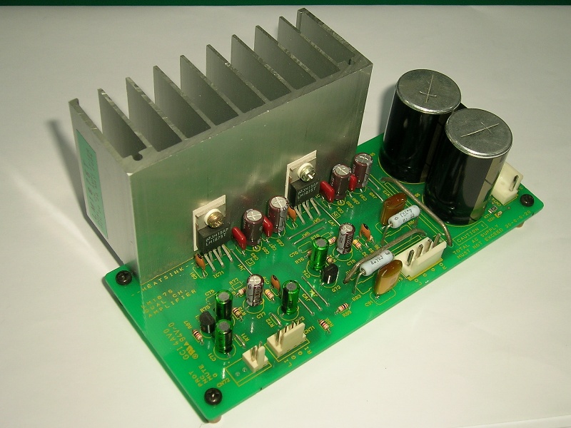

      This is the sound quality e-cap elna made for customer like Kenwood. It is TONEREX series if i remember correctly. Quite good sound... I've built some amplifier module using these e-cap as smoothing capacitor in the rectifier.

        Thanks Brian. Looks the same as the one I saw the other day except for the top part. Still puzzled why ELNA does not print the part number on the cap. I cannot find it in ELNA's catalog. Are you aware of any clone ones on the market?

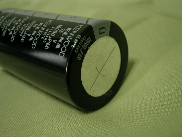

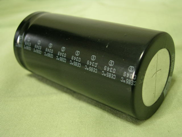

          Re: ELNA Cap Identification
          The top part used to be same as urs. I trimmed the top part of the plastic sleeve as it may improve the sound quality (advice from a friend of mine). ELNA do not print part no. on the cap because it is customized part requested by customer.
          Not sure about clone one. Few things on genuine Elna e-cap.
          (1) Elna E cap safety vent " -)-"
          (2) Date Code: 0349 means year 2003, week 49

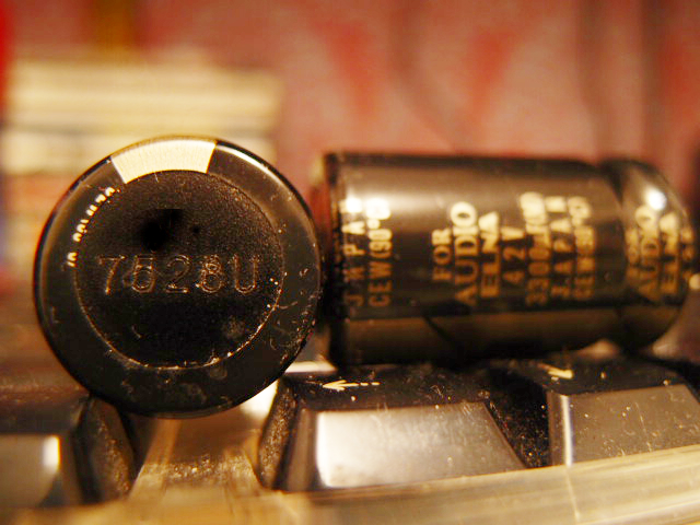

                            I have the same caps, but no signs of date.
                            Only a code: 7528U

                              28th week of 1975 - in other words, fakes.

                                Oh!?
                                But I took them from inside a mini Kenwood system similar to that below...

                                  Oh, in that case, those letters don't represent the datecode... I got confused because Capxon does put date codes on big snap in caps like that on the top...
