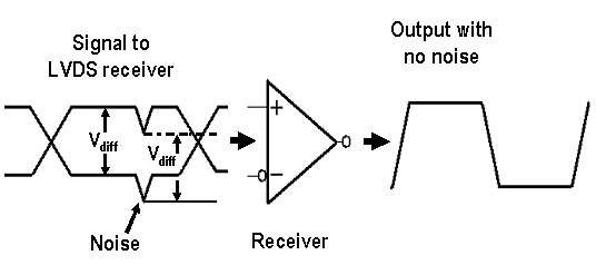

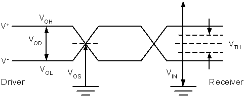

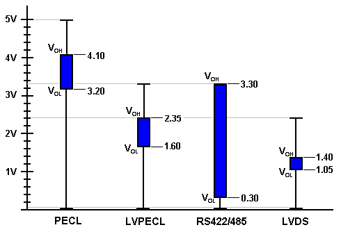

    Figure 1 illustrates a typical LVDS transmitter. This transmitter consists of <<<<<<<<<a current-mode driver, which provides around 3.5 mA of current through the transmission lines of the differential pair. >>>>>>>>>>>>At the receiver, a 100 Ω termination resistor is used to match the impedance of the transmission line that connects the receiver to the driver. Closely matching the impedance of this termination resistor with the impedance of the transmission lines reduces harmful signal reflections that decrease signal quality. The termination resistor also provides a path between the complementary signal paths of the system. The high input impedance of the receiver causes the 3.5 mA current coming from the driver to flow through the 100 Ω termination resistor, resulting in a voltage difference of 350 mV between the receiver inputs. As the path for the current within the driver changes from one path to another, the direction of the current flowing through the termination resistor at the receiver changes as well. The direction of the current through the resistor determines whether a positive or negative differential voltage is read. A positive differential voltage represents logic-high level, and a negative differential voltage represents logic-low level.
    The standard defines the input voltage range of the receiver, VIN, to be 0 to 2.4 V. This input voltage range is significantly larger than the range of expected voltages from the driver. This difference provides the ability to absorb and reject common-mode noise, noise that is present on both lines of the differential pair, and allow for offsets between the driver and the receiver
    reference:
    http://www.ni.com/white-paper/4441/en/
    This is the one..... we gonna use....
    a current-mode driver, which provides around /////////3.5 mA///////// of current through the ////////transmission lines ///////of the differential pair.

      Differential signal sending and receiving is nothing new, it has been used in other application for decade, in this case for TV, it is just LOW VOLTAGE DIFF SIGNAL.
      In case you did not study the basic of signal transmission and receiving, differential signaling is used for noise immunity in Ethernet, RS-485, CAN and USB. It is also used in professional audio system. OP-amp has diff input.

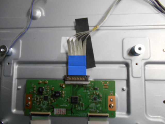

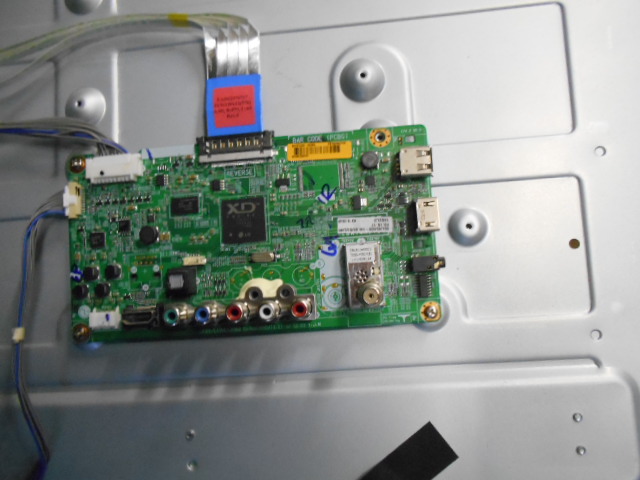

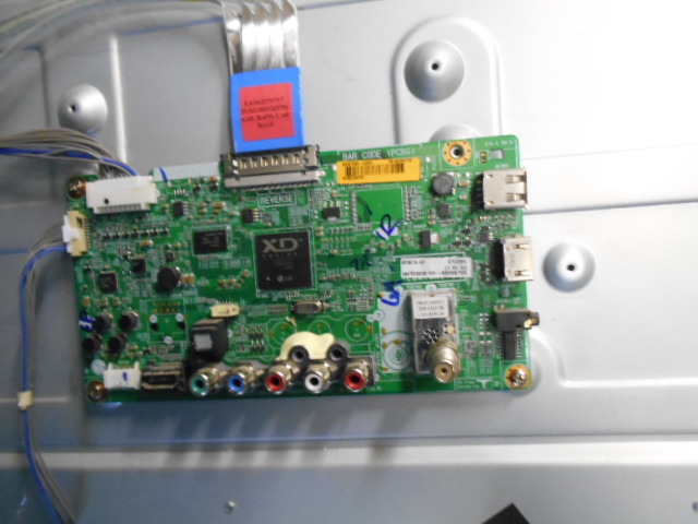

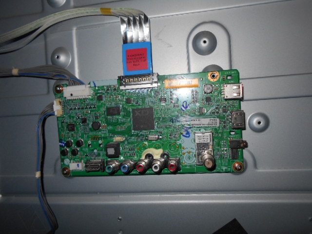

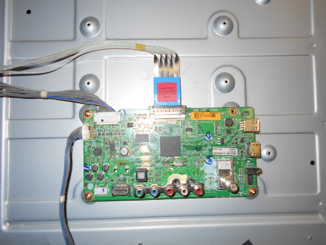

                this one has 5 pairs LG_50PC5DC_50PC5D_PA-73E
                but..... now I work on LED LCD LG 55ln5400 has 10 pairs LDVS (51Pin LVDS Connector) 10 bits (10 pair signals) on flat cable ..... Tom only have this one newer LG_LA21B_55LS5600-UC_[SM].....................over Page 34
                Which I try to do is ( look the mother board is small.) just use as a test Jag
                I will make adapter to switch to Samsung or other brands.....I think newer LED LCD screen all has at least 10 pairs LVDS signal...Hard to find any Data....I don't want burn any screen again.....
                http://www.ebay.com/itm/NJYMST6M30-V...-/271123027434
                http://www.ebay.co.uk/itm/FI-RE51-LV...-/271204538983
                A 5 pairs B 5 pairs then switch because some tester say 55' can display only half the screen..
                I would like to test each one as Ur suggestion.
                Don't worry, I will find older 32' TV and find out ...

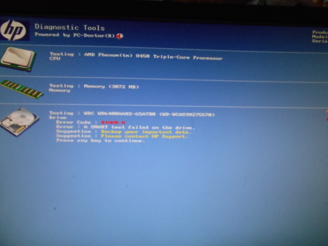

                The last picture ...we need to change HDD for customer HP desktop (windows 7)

                  Re: How to make LVDS test under 99 cents
                  LG_LA21B_55LS5600
                  P703 LVDS connector FI-RE51S-HF-J-R1500
                  (Vcc) 48 49 50 51
                  (ground) 52 46 45 44 43 42 37 34 26 21 18 11
                  8 pairs LVDS signal (10 bit)
                  same pinlay out to
                  pinouts of LC470WUD-SBT1 LCD panel:
                  This type LVDS cable is suitable for panels ≥ 26”, for resolution 1920*1080 HD LCD panels.
                  Compatible with LG, AUO, CHIMEI, Sharp panels.

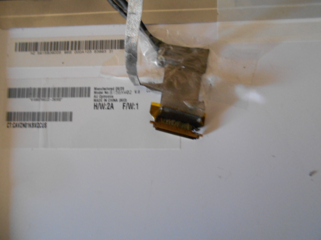

                      Compaq laptop LVDS test report:
                      background music:
                      https://www.youtube.com/watch?v=rNsgHMklBW0
                      Panel No: B156XW02 V2
                      a TFT LCD panel,
                      a driver circuit, and LED backlight system. The screen format is intended to support the 16:9
                      HD, 1366(H) x768(V) screen and 262k colors (RGB 6-bits data driver) with LED backlight driving circuit. All input signals are LVDS interface compatible.
                      (EDID).......Extended display identification data
                      is a data structure provided by a digital display to describe its capabilities to a video source (e.g. graphics card or set-top box). It is what enables a modern personal computer to know what kinds of monitors are connected to it.
                      reference data :

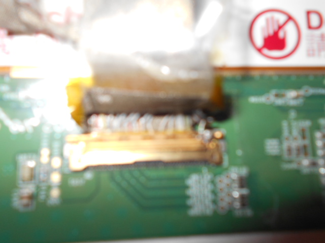

                      Sorry , my LVDS connector fired (burned)( and only have DC12v).....I can't do it .....any more.....Wuu....(*^(%^(^%)*..........If this is 120' TV at customer's home .....they call 911 right away....
                        "Sorry , my LVDS connector fired (burned).....I can't do it .....any more.....Wuu....(*^(%^(^%)*..........If this is 120' TV at customer's home .....they call 911 right away...."
                        Did you verify the VCC and GND pin out first?
                          I did and I copy the AUO LVDS pinout held in my hand ,VCC PINs38...39..40 on right corner which has a big hole now. Don't worry. Wanna lean gonna pay for tuition.

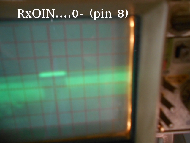

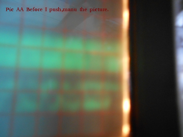

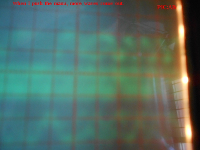

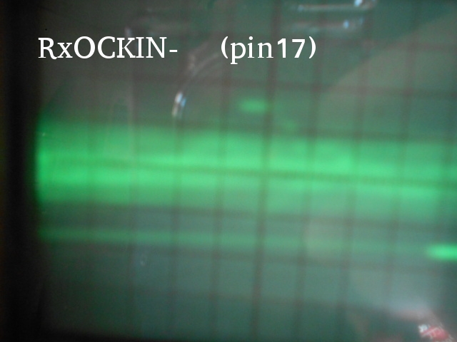

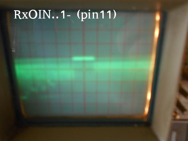

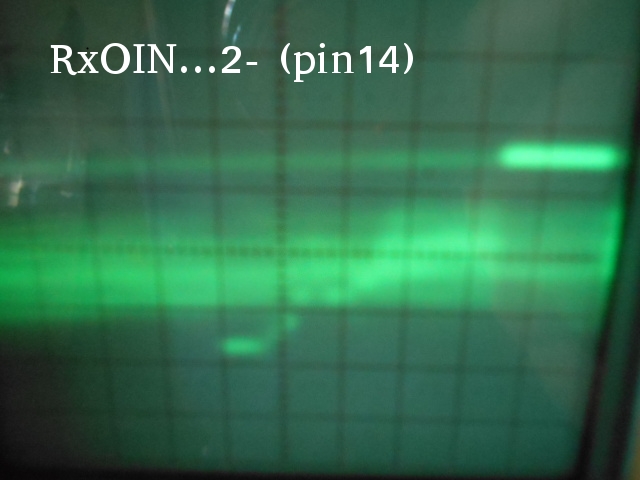

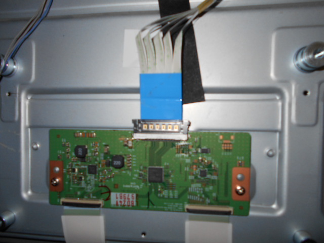

                              I did come to office Sunday afternoon.
                              Do the lab but pictures real bad,because I look like monkey one hand on scope other hand on camera and need to push the menu button.
                              RCA 40LA45RQ
                              panel No.:V400H-L10 Rev c8
                              http://www.ame.cz/LCD-panel-40-V400H...379_10699.aspx
                              I did have some harvest (Look the pics) when I push the menu button... the waveform change....the waveforms more dense.
                              What I'm Trying To Say: By that diffidence waveforms....... can we detect and invent (The non contact LVDS waveform tester).
                                  When you use the scope, since we have high Voltage for the CCFL that radiate noise like crazy and you scope will easily pick up the high voltage, and the signals we are trying to see is in mV range, you should look at the signal when the backlights are on and then try it again without having the backlights on (by either disconnect the cable to the inverter board or disable the BL-ON signal).
                                  Also use the video source that changes the scene all the time instead if still image, look at the score and the image on the screen then you should see the change on the scope when the Video images change.
                                  BTW, the scope probe Ground lead should also be as short as possible.
                                  You can try connecting the scope probe GND lead to the tip of the scope probe and move the probe around, you will see that the scope will pick up the radiated signals, that little loop will act as an antenna loop, that is why the GND lead has to be as short as possible.
                                  http://emcesd.com/tt070199.htm
