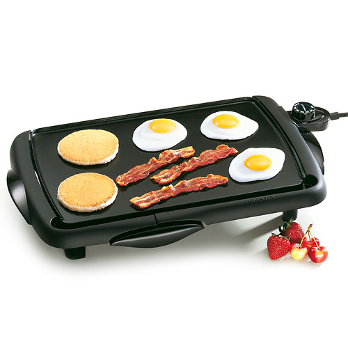

    My bottom heater is a Griddle (i know it's getto it can get about 120c for bottom heat )

    I assume you bought a "Presto" griddle from Wal-Mart? And put screws in from the bottom to mount the motherboard? If so, you may need to move the motherboard closer to the surface of the griddle in order to hit 150c. (again, top of the board, near the target chip, not underneath the board). I'd advise abandoning the griddle as soon as possible and getting a proper preheater.

      I was coming to the same conclusion about not having enough bottom heat. The griddle is only good for about 120c that only when i have it closest to the griddle.

      6. a presto griddle (wow how did u know?)
      I will try to give as much information as possible for my process. I leave the griddle on max with the motherboard on top while sitting behind the window fan. This heats the motherboard to 120c. I take the readings from the thermocouple. Also i have noticed that the hot air station does not produce the amount of heat that it says. That's why i don't really pay attention to that . I used to use only one of the wires from the thermocouple but on my last reball process i used both. I think i will stick to using both from now on. I stick them on top of the chip i am trying to reball.

          I have seen people use Hot air station's for reballing. I actually want to succeed with hot air before i even think about spending big money on better equipment. For right now the only thing i want to change from the setup is the griddle. Btw a griddle is something you cook pancakes on .
