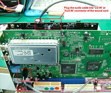

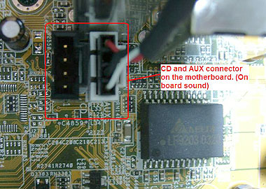

            From what I can understand, you want to use your normal speakers as an internal PC speaker? In that case you can directly connect the internal speaker header on your motherboard to another header on your soundcard. If you use a built in soundcard on the motherboard, then you have to connect it to one of the audio connectors on the motherboard.
            On very old soundcards, there was a special input for a PC Speaker I believe. However now I believe that those connectors have disappeared. Therefore I would connect it to the auxiliary input. With this arrangement, your main external speakers will be used as a PC Speaker as well. And it should be amplified by the sound card.
            Hopefully that would work out.
            Good luck!
            Edit: Found some nice illustrations of the audio connectors on a motherboard as well as on a soundcard.
            These were taken from: here
