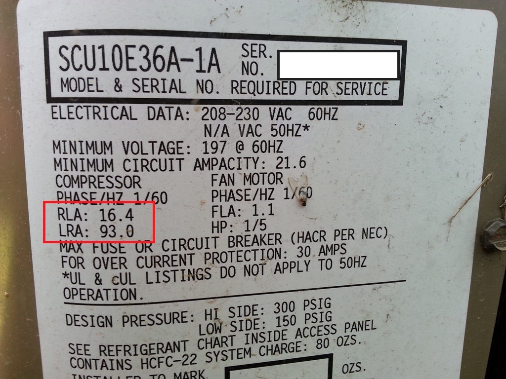

                                      Re: Refrigerator induction motor: peak current draw
                                      Is there a LRA (locked rotor amp) rating on the compressor? It will be several times higher than your running amps. The LRA will be in the circuit for the first second or 2 during start-up.
                                      For example. I attached the data tag of the outdoor unit of my 3-ton a/c system. At 93 amps, the LRA is 5.5x more than the RLA of 16.4 amps (running loaded amps). The thing to remember is motor loads are inductive and have short-lived high current start-ups.
