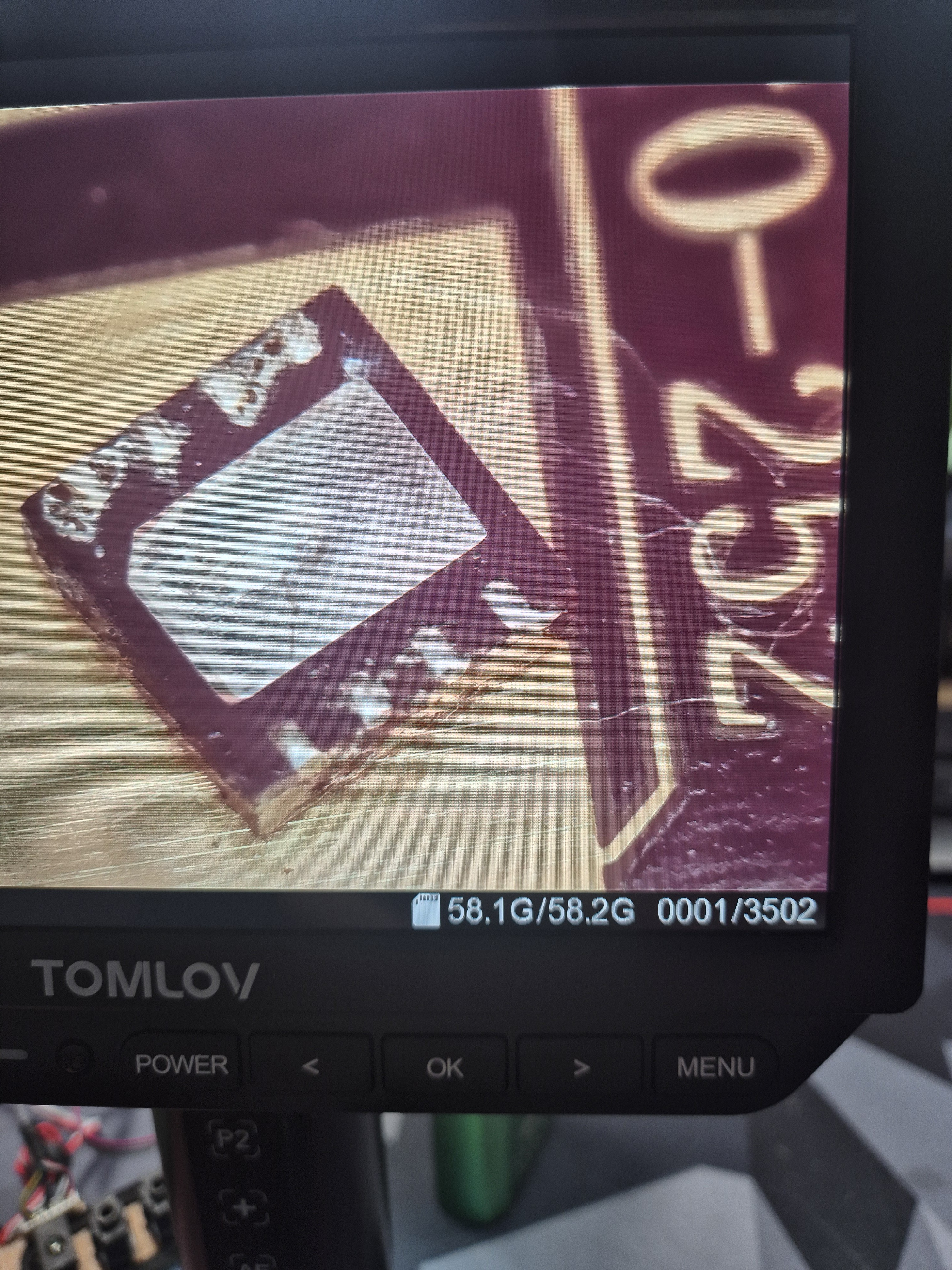

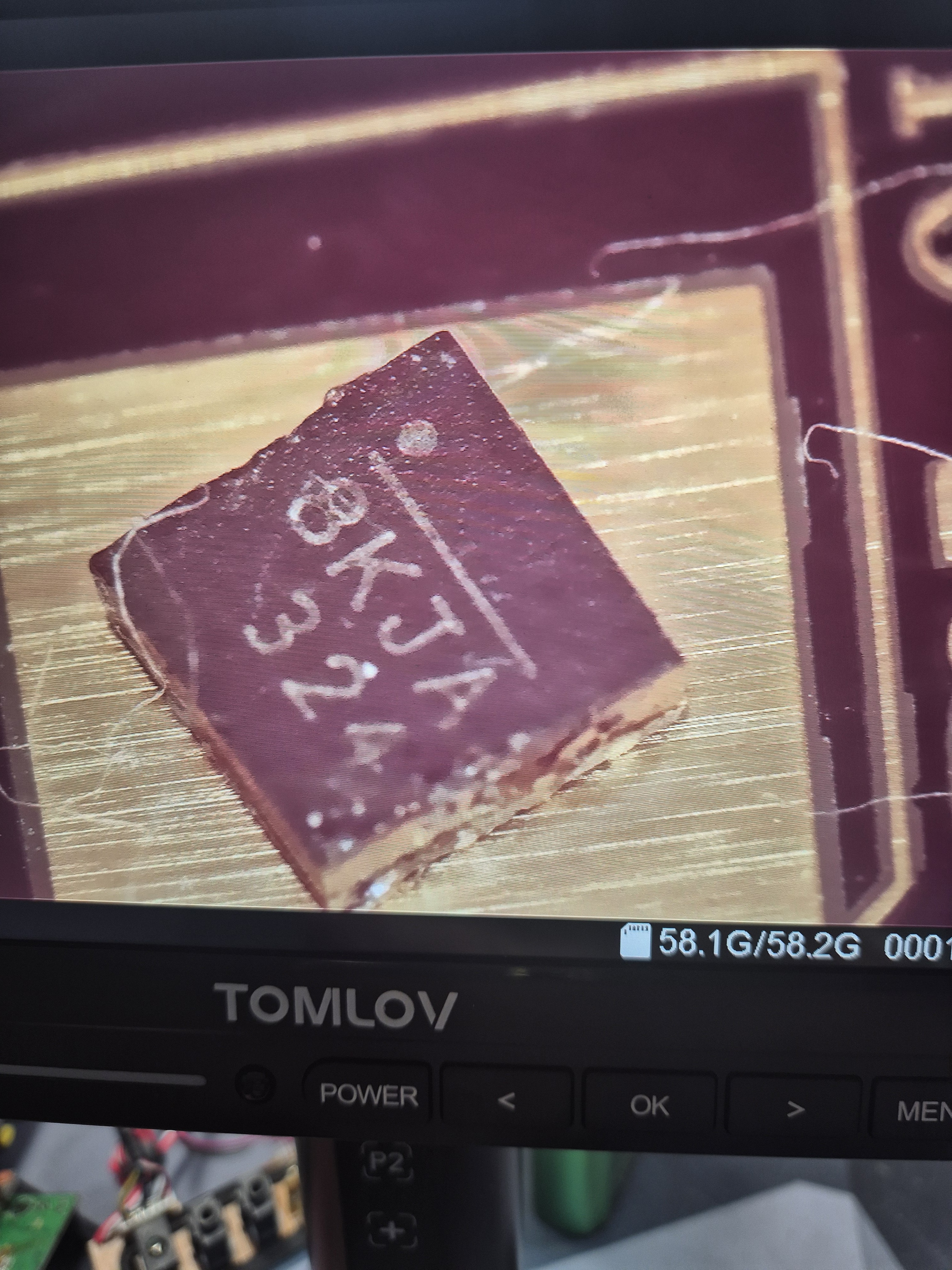

    Hi there, i purchased a faulty pure dab radio from ebay and after some testing i found that this ic i believe is possibly a mosfet? has failed and caused a short on the board. I have typed the numbers in google but cant find any info at all. I am very new to electronics but i am learning. would anybody have any idea what it is and if there is an equivalent component i could try. With the chip off the board i get 5.4v on pin 1, pin 3 is ground as is pin 6, and on pin 8 i have 4.5v. i know this is quite vauge but im hoping someone could help. Thanks

          It`s made by Monolithic power but don`t know what it is yet - https://www.badcaps.net/forum/troubl...20#post1482820
          Is that first character an eight or a capital b B

            It is a 8

              Show us a photo of the PCB. If the IC is a switching regulator, there should be an inductor nearby.

                Here is the best picture i can take with my phone at the minute. You can see the empty pads where i took the chip from. i believe there is an inductor just before the ic marked l204

                    Looks like it could be MP20045DQ
                    https://www.monolithicpower.com/en/mp20045.html
                    Datasheet https://www.monolithicpower.com/en/d...ument_id/1201/
                    Marking 8K**
                    Package info
                    https://www.monolithicpower.com/en/s...formation.html
                    https://media.monolithicpower.com/cm...%20MARKING.pdf

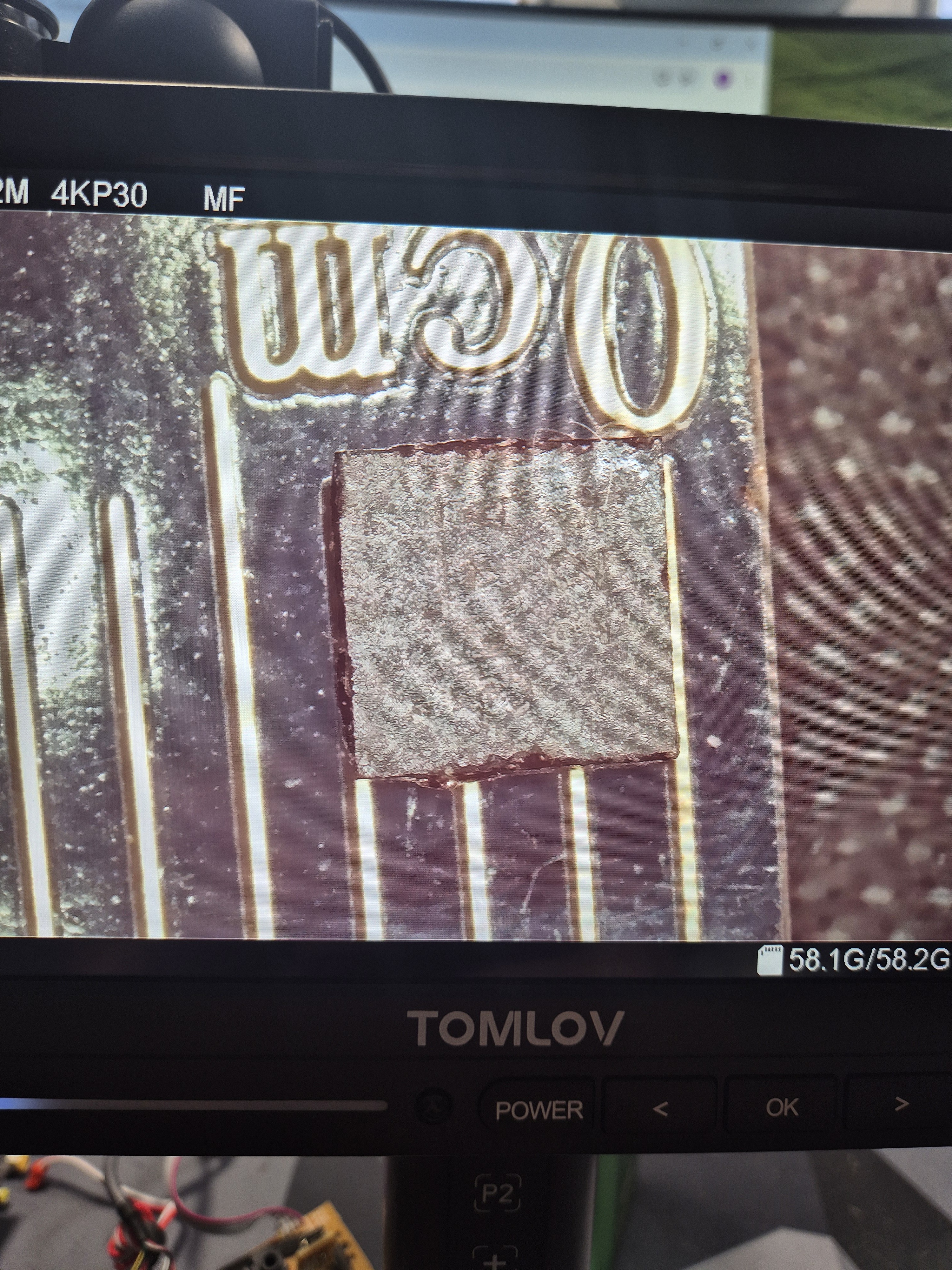

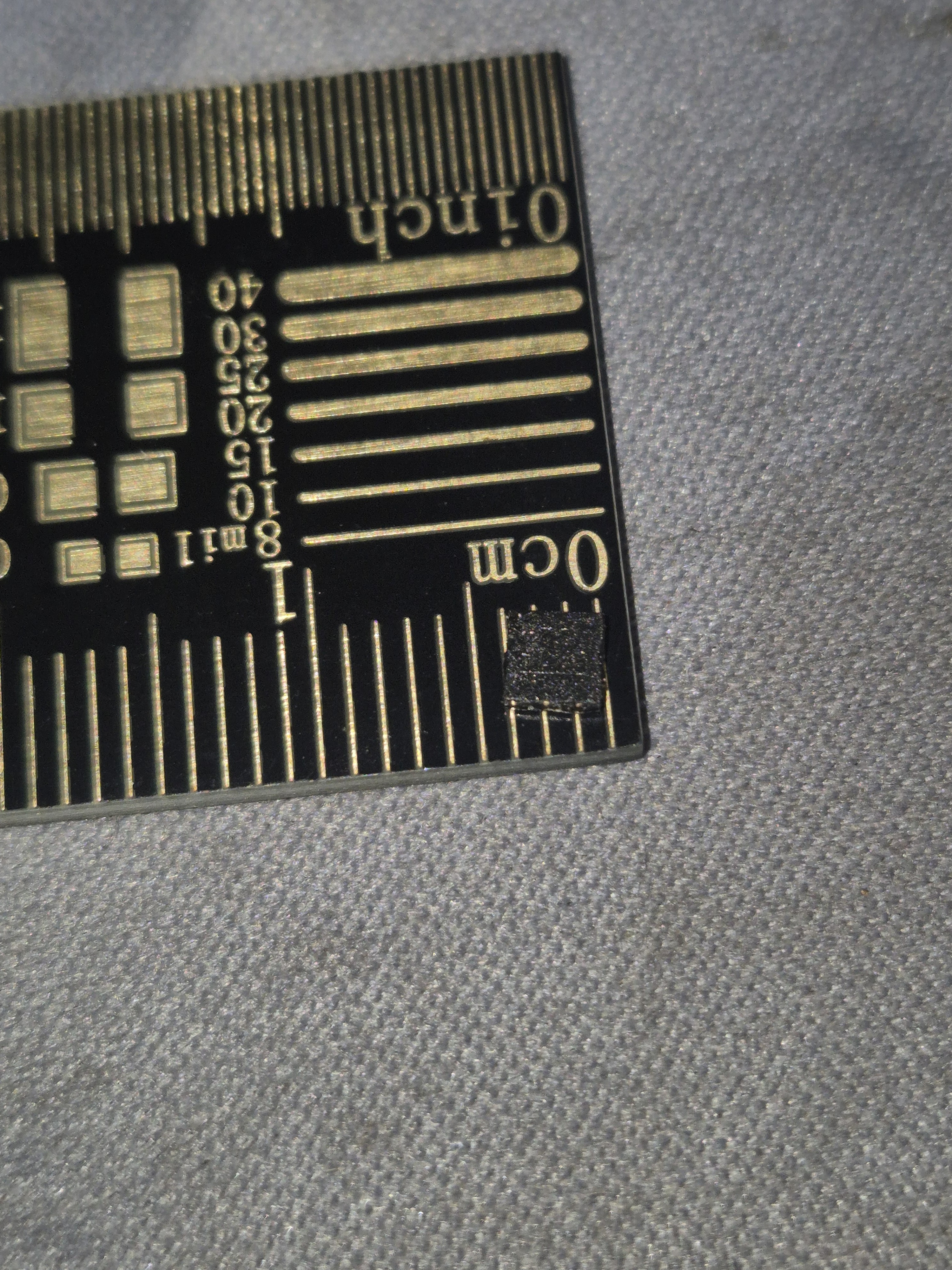

                      That chip has only 6 pins and is 3mm×3mm. My chip has 8 pins and is 4mmx4mm. 🤷‍♂️ Unless im looking at the wrong one. I did check all the 4mmx4mm chips in there list but they all look like bga chips too me. But again I might be (and probably am) wrong. 😁

                        MP20045DQ has 8 pins, plus the pinout matches the circuit. And it's a linear regulator, not switchmode.

                          You are right I do apologise, I just downloaded the data sheet and it indeed has 8 pins. All I saw was the initial image on the screen which showed 6 pins.
                          this is looking very promising. I really appreciate your guys help you are all very knowledgeable and I can learn a lot from all of you.
