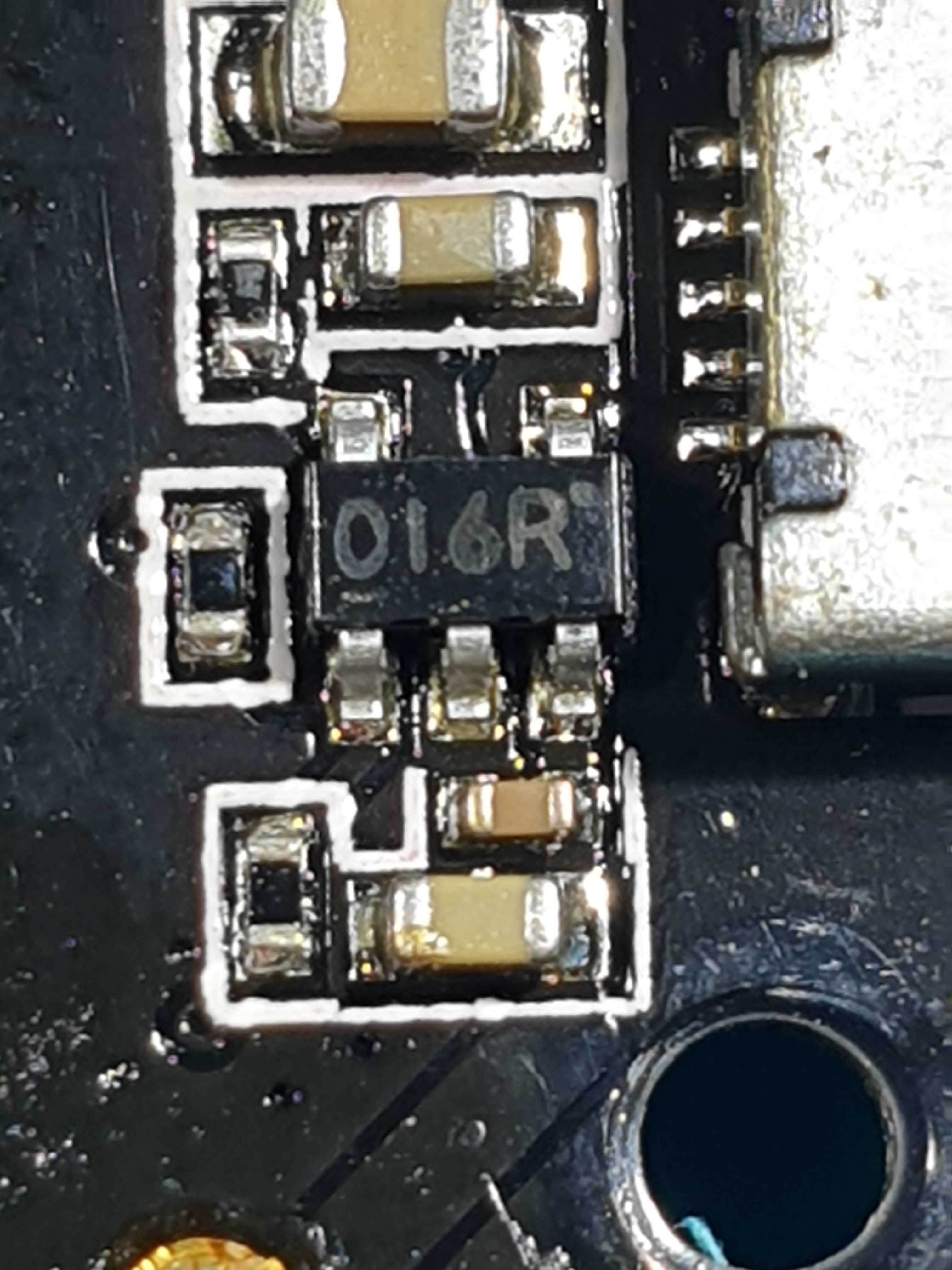

    What is this component?
    Can someone tell me what this is? Ive seen it a LMC7101 but apparently theres an A and a B version, will either work? Its for a car GPS thats powered from a 3.7v battery if thats any help, thanks in advance!

    SE9016
    http://seawardinc.com.cn/Site/defaul...6-20230525.pdf

      Same with EC49016
      And SD8016

        OK thank you guys for your help!
