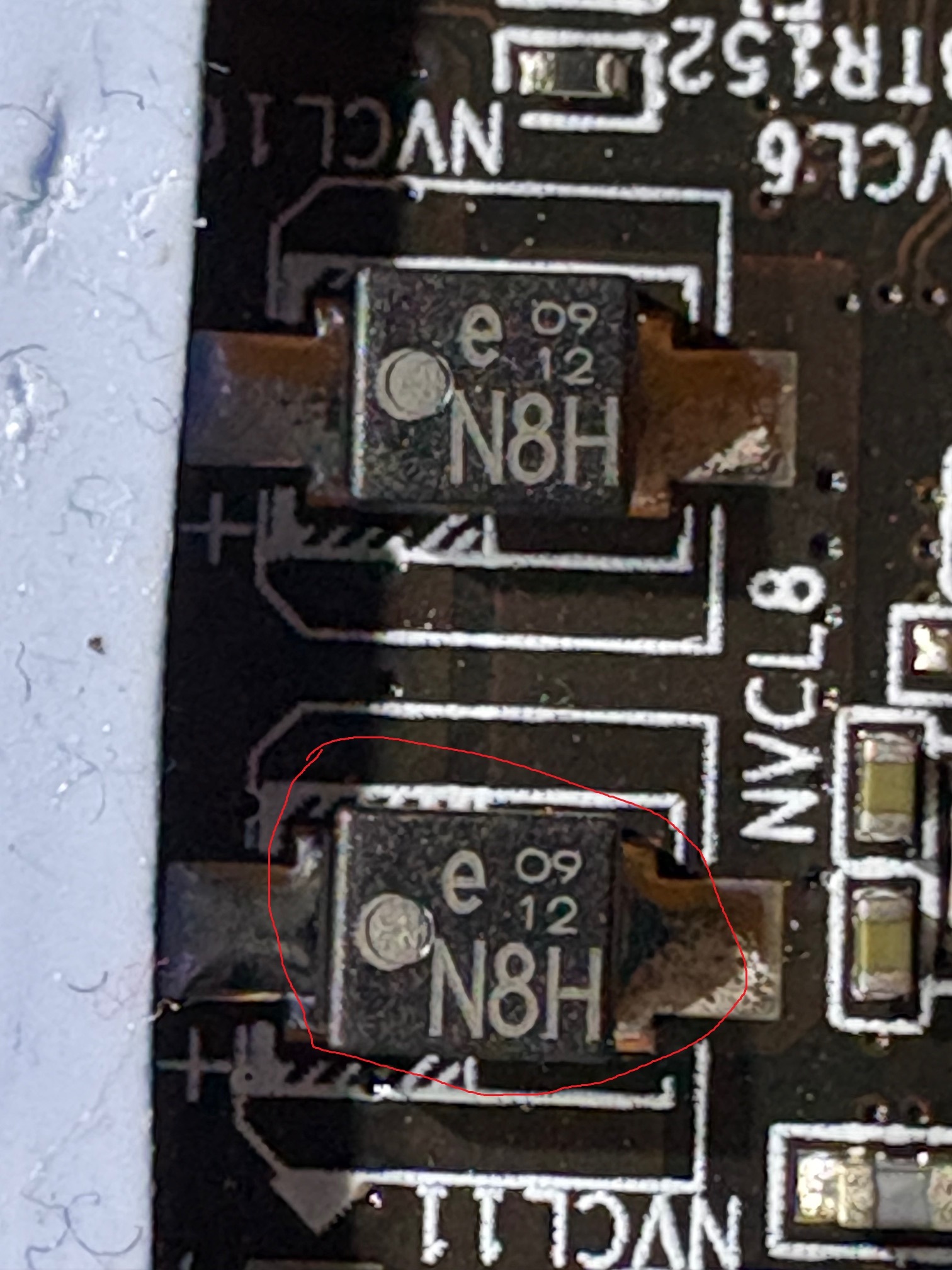

    Hi, I need help identifying this component below from a gigabyte aorus 5 laptop that’s marked n8h. I’ve searched everywhere but couldn’t find anything. Thanks

    • 20492
    What`s the motherboard model number
      It is a GA-RX5MSE4. I tried searching everywhere for a boardview but had 0 luck.

        FWIW, Google Images turned up this image ("Panasonic TDC and TLE Series POSCAP capacitors"):
        https://assets.content.na.industrial...rs%20Photo.png
        https://mm.digikey.com/Volume0/opasd..._POSCAP_DS.pdf (TLE datasheet)
        N8 = 330uF, H = Lot No.
        e = 2.5V
        • R_J
          • Jun 2012
          • 9534
          Seems to be Panasonic Conductive Polymer Tantalum solid capacitor (POSCAP) TPS series
          e = 2.5v, N8 = 330µf (see page 16)

            Thanks, much appreciated.
