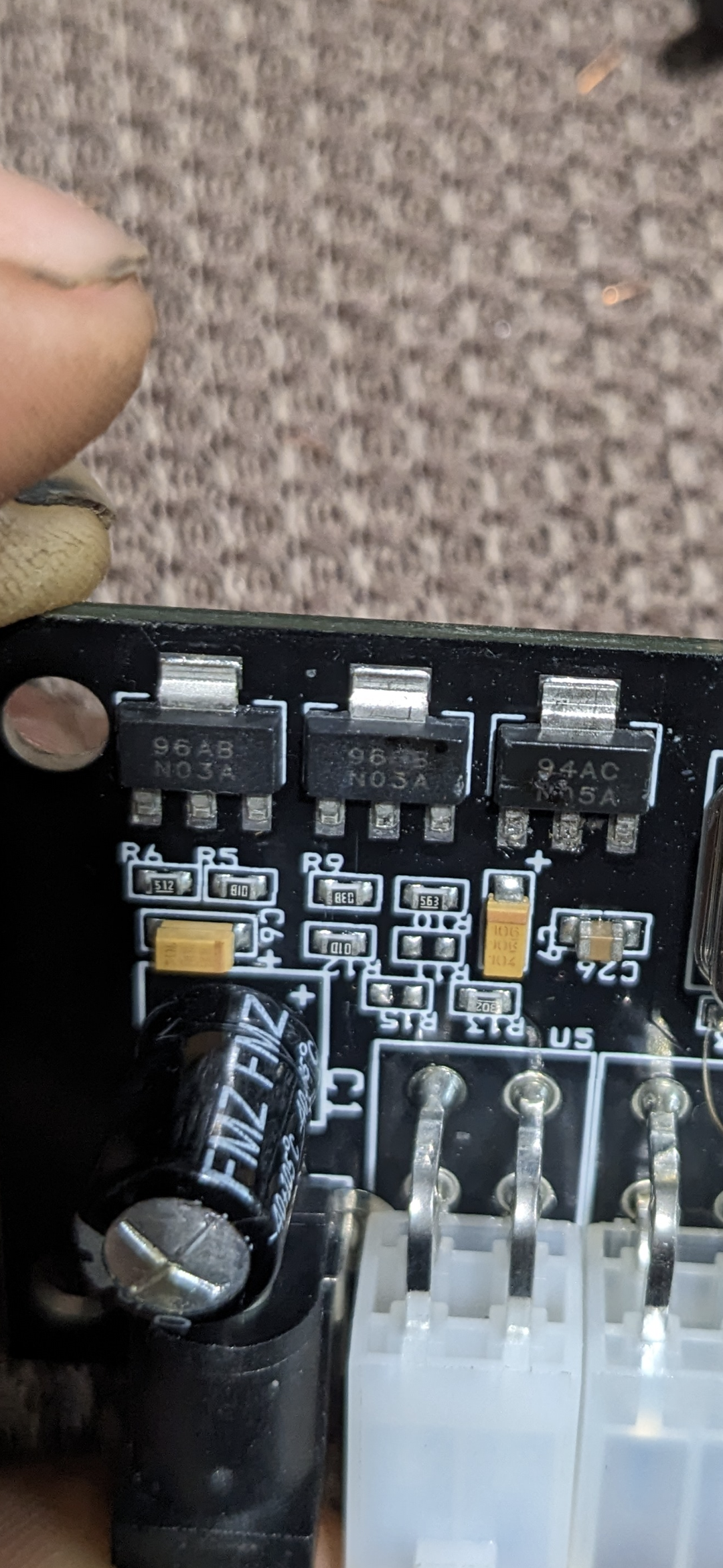

    ID SOT223
    Well, I managed to let the magic smoke out. I need help identifying some what I think are sot223 voltage regulators. Two say 96ab on first line no3 on second line. One says 94ac on first line no5 on second line. I dont know if they are pnp or npn? It appears power is on right leg so npn? Any help appreciated the internet has no info I can find.

    http://markingcodes.com/search/c/n03a (LM1117MPX-ADJ, adjustable 800mA Low-Dropout Linear Regulator)
    http://markingcodes.com/search/c/n05a (LM1117MPX-3.3, fixed 3.3V, 800mA Low-Dropout Linear Regulator)

        Great site and I thank you very much!
