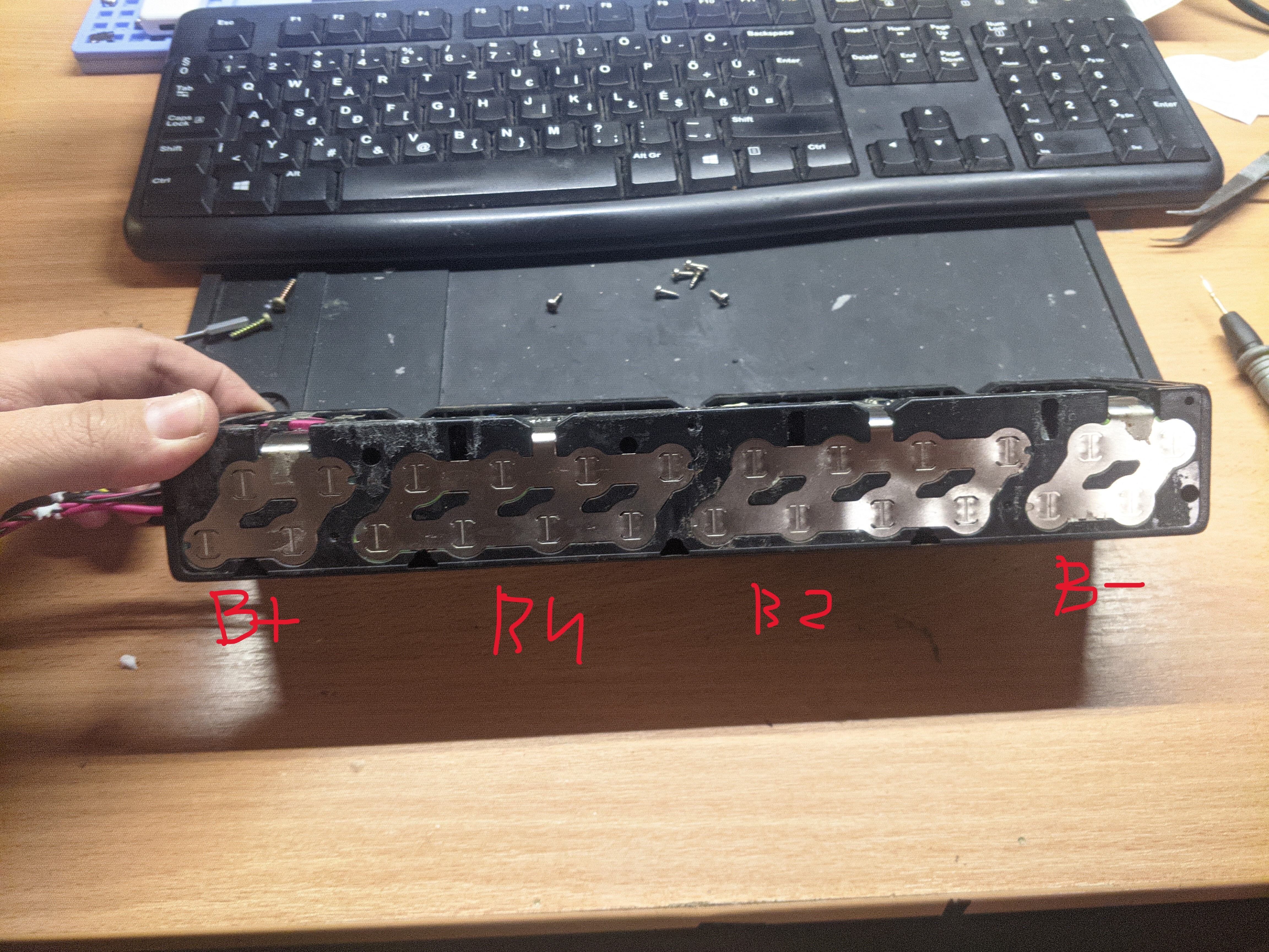

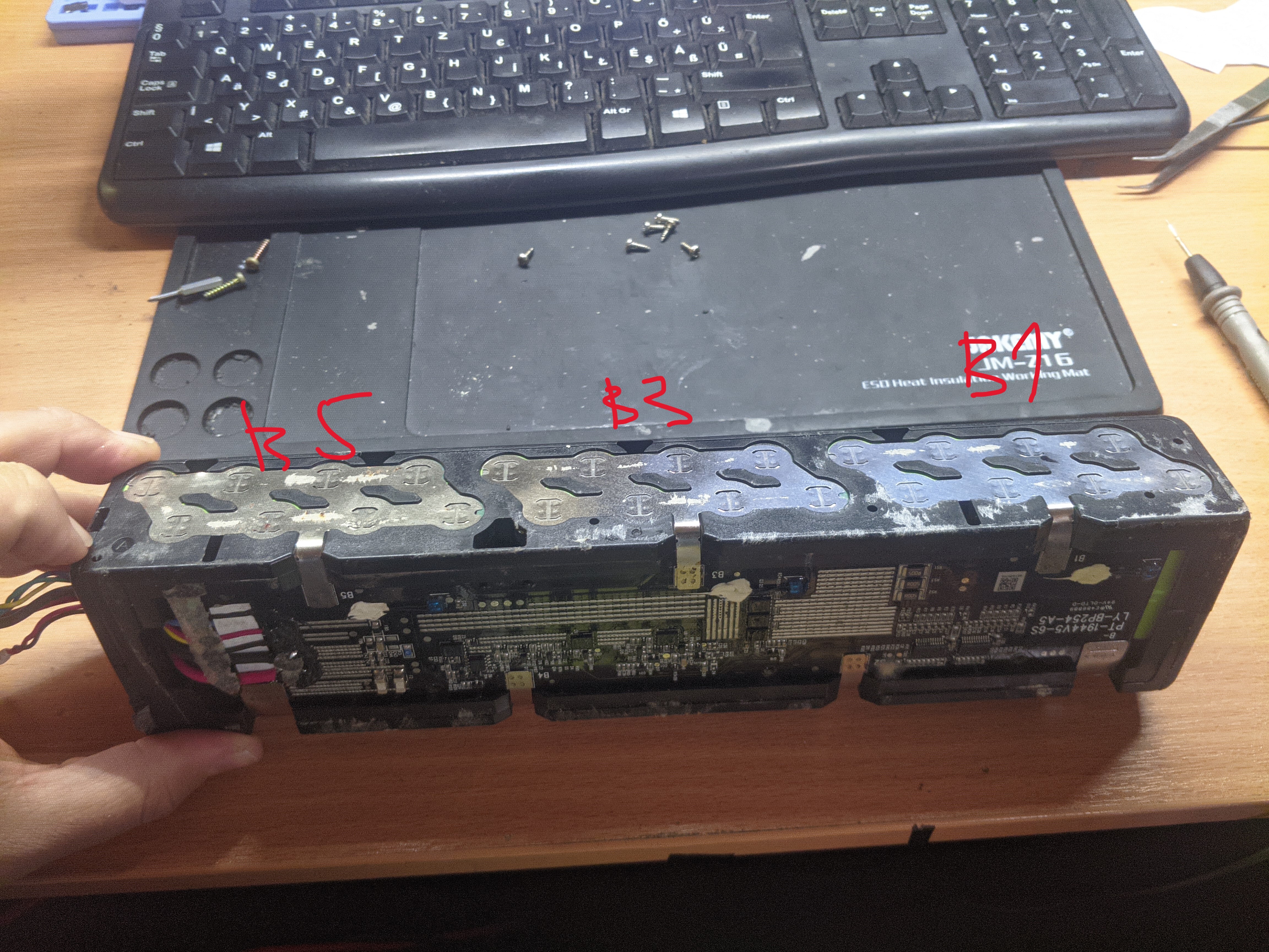

            So the battery charge is at 16% now according to the display.
            I disassembled the battery pack, the output plug has 15V on it.
            Here is the top and bottom side of the battery pack:
ID:	3496784 Click image for larger version
            How should I measure these banks to get the correct values?
              • 31260
              you have access to all the battery tabs so just meter the 6 groups of 4 cells and see if they match or are close to each other
              now lets talk numbers.
              it has 6 groups so 6x 4.2v is 25.2v fully charged.
              15v divided by 6 meaans you have 2.5v per cell right now - witch is potentially below the safety threshold of the protection board.
              if they all match then forcing them upto 18-20v will probably get it working on the original charger again.

                  The battery charger rated output amper is 1.5A. That measn I can safely charge the battery pack with 1.5A trough the discharge plugs. no? Or should I use 1A just to be sure.
                  The battery packs current voltage is 14V.
                  I measured the tabs in the following order:
                  B+ - B5 = 3.5V
                  B4 - B3 = 3.5V
                  B2 - B1 = 3.4V
                  B- - B1 = 0.0V
                  Based on this I assume B1 is dead, which causes the pack to become inbalanced so the BMS disables charging.
                  What do you guys think?

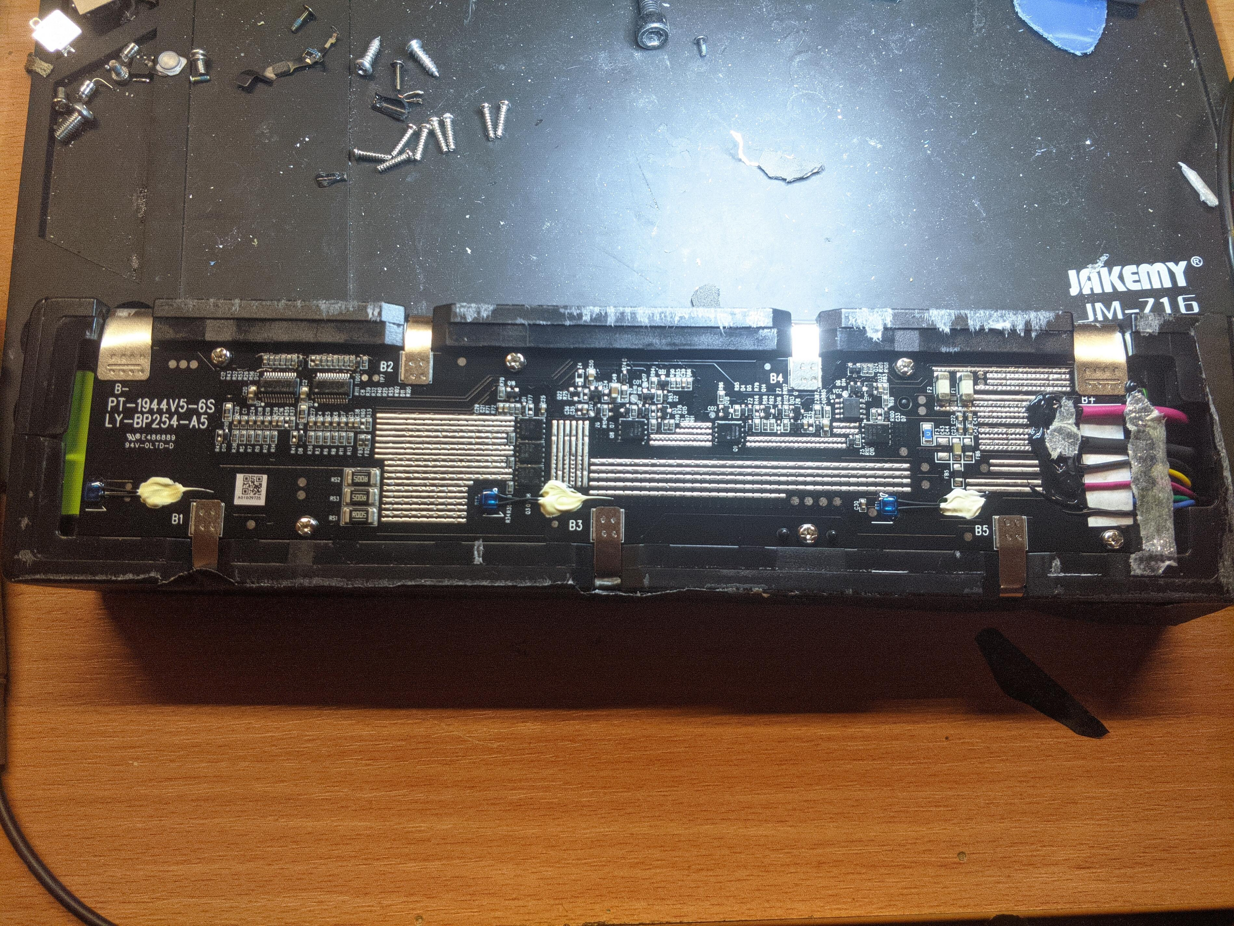

                                    Also, I think I must remove all the metal tabs from the BMS, since I cannot open up the plastic case. I removed every screw yet the two part wont seprate. I guess The tabs are holding it together.
                                      • Jul 2011
                                      • 6070
                                      You more than likely will have to remove the battery tabbing to get to the battery cells that you need to replace anyway so that why I mention about just replacing all of them that are more or matched hopefully
