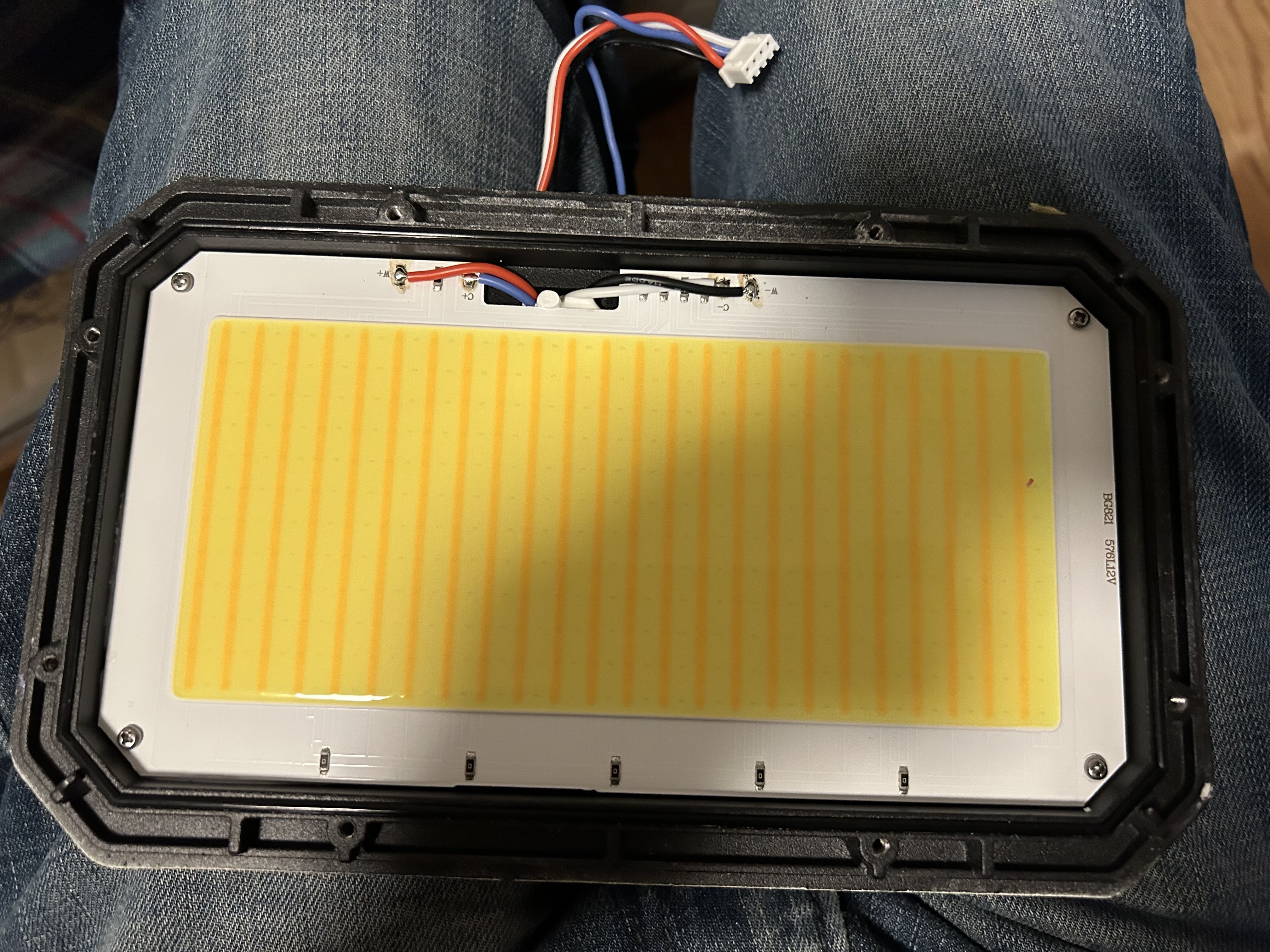

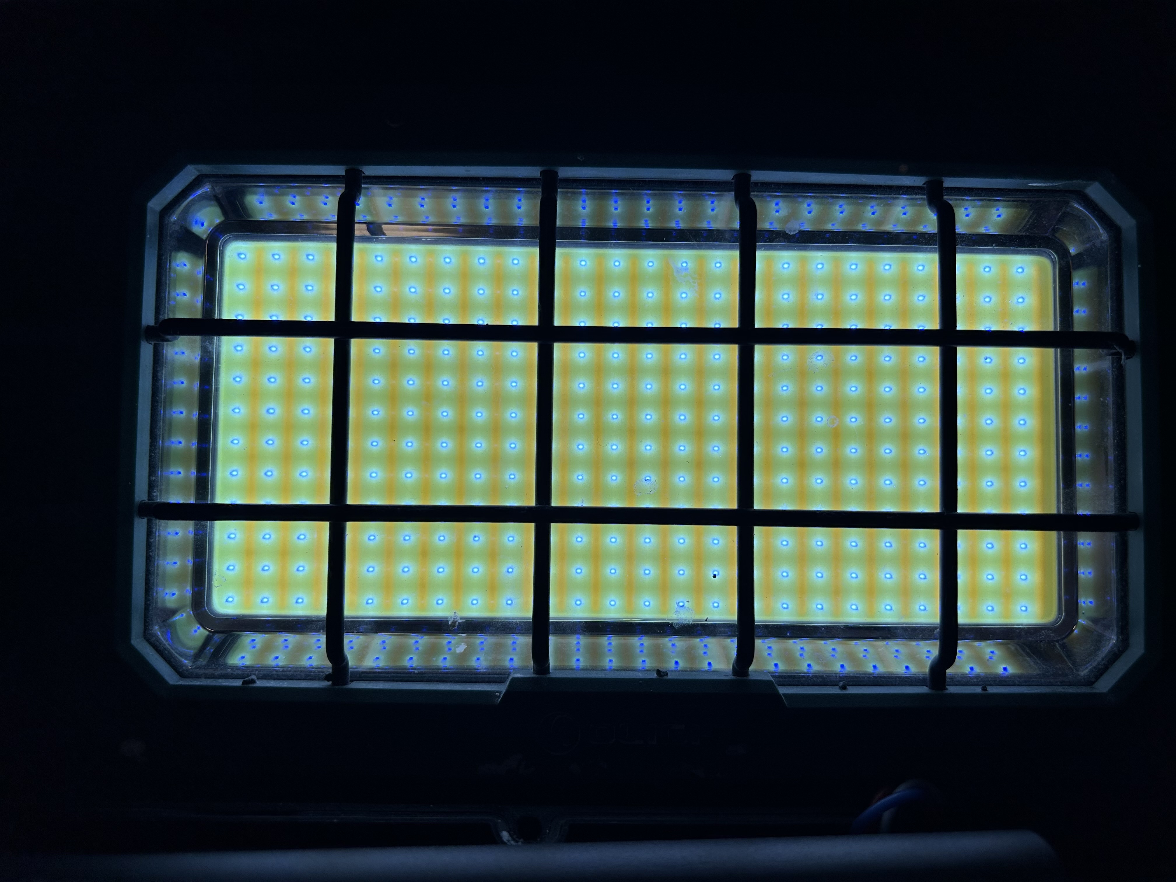

    Hi, I'm trying to fix my buddies rechargeable led work light made by olight and the model is odiance. For some reason now after a couple years of no issue, when powered off now, the led is faintly lit on 3 of the orange rows but as you can see from the first pic that's not where the leds are. The part that is faintly lit is beside the leds? Anyone know how that is possible? Is there small voltage still coming in somehow? The third pic is with the cover off.
    • 31204
    interesting, so it has 2 colour modes.
    white and something else - red?
    the resistors on the led panel look like they arent properly soldered.
    that doesnt explain it not turning off though!

      Sorry I’m mistaken, there are led’s where the orange lines are. There’s a knob that lets you adjust the light to a white/orange color as it turns on both the white and dim orange leds. But yeah I don’t know why when powered off the orange ones are still lit on 3 of the rows.

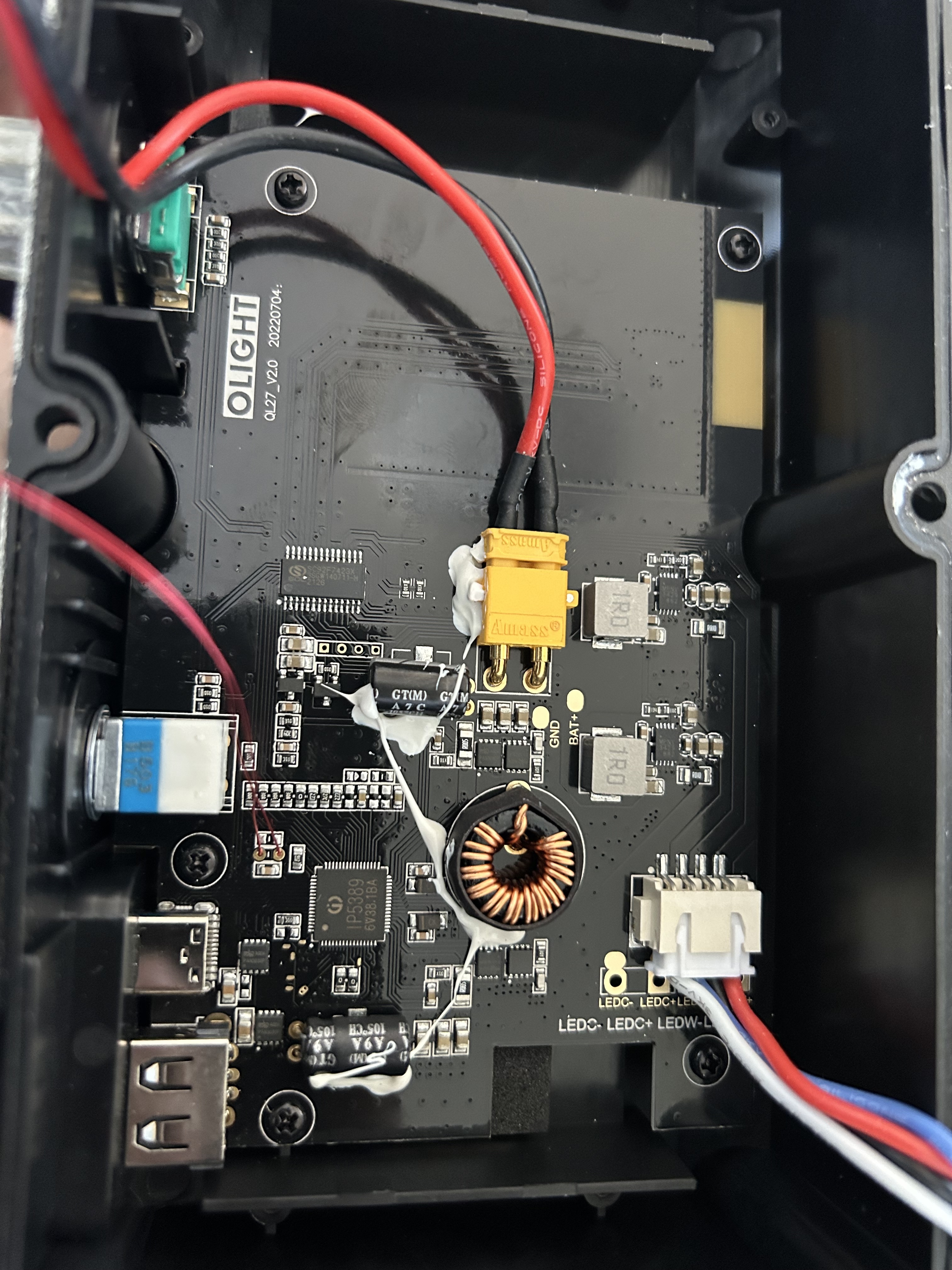

          here is a picture of the board.

              i see it has 2 boost convertors to drive the leds,
              they must be powered by fets but that fucking black soldermask makes it impossible to see the tracks

                    Those chip numbers are the correct numbers shown on my chips. I also have 6 chips on the board labeled pan3030p as shown in pic below.

                      PAN3030P would be the MOSFETs in the battery charger circuit.
                      http://www.jg-semi.cn/uploads/admin/...6/PAN3030P.pdf
                      Are there any components on the underside of the PCB or anywhere else? I would think that there must be a MOSFET switch, or physical switch, between the battery's positive terminal and the Vin pins of each of the MP3429 boost converters, otherwise the battery would drain through the LED strings.
                      Perhaps the two MOSFETs at the USB ports are configured as ideal diodes to prevent the battery from back-feeding into the ports? In fact they appear in the simplified application schematic on page 2 of the datasheet.

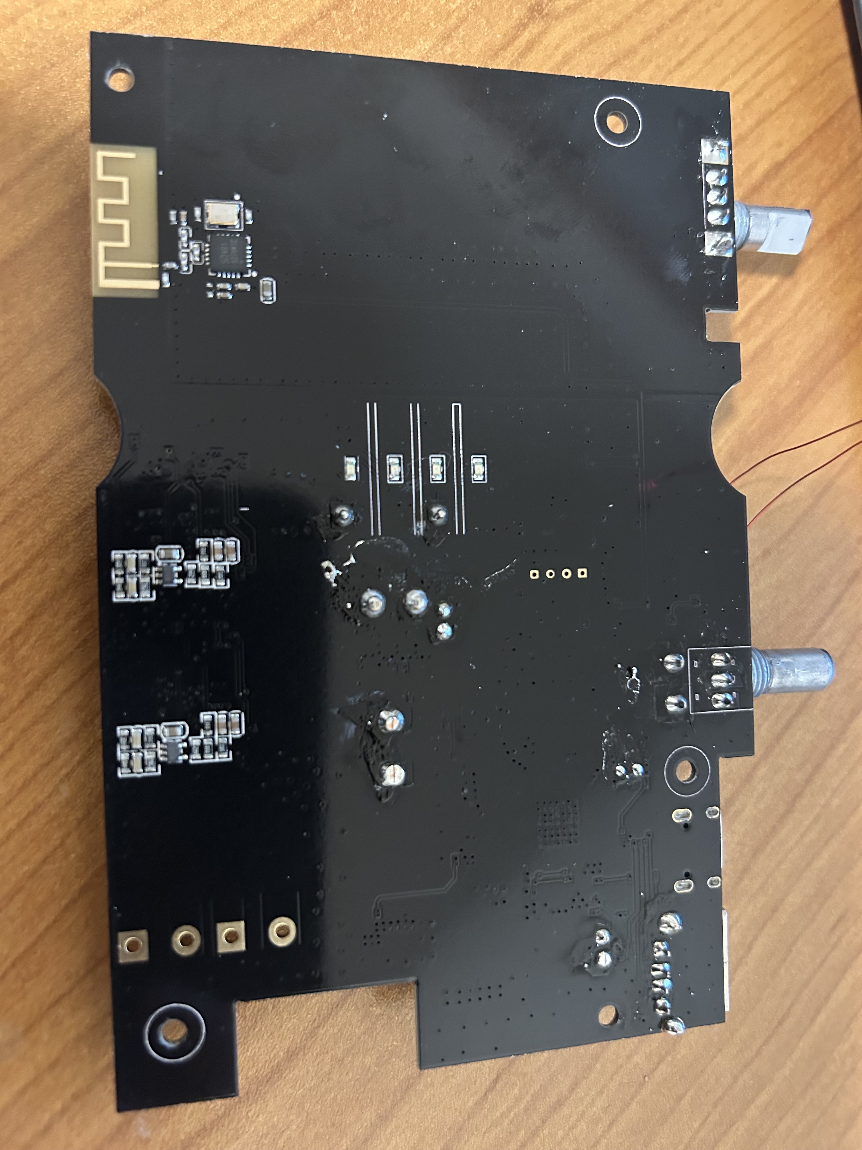

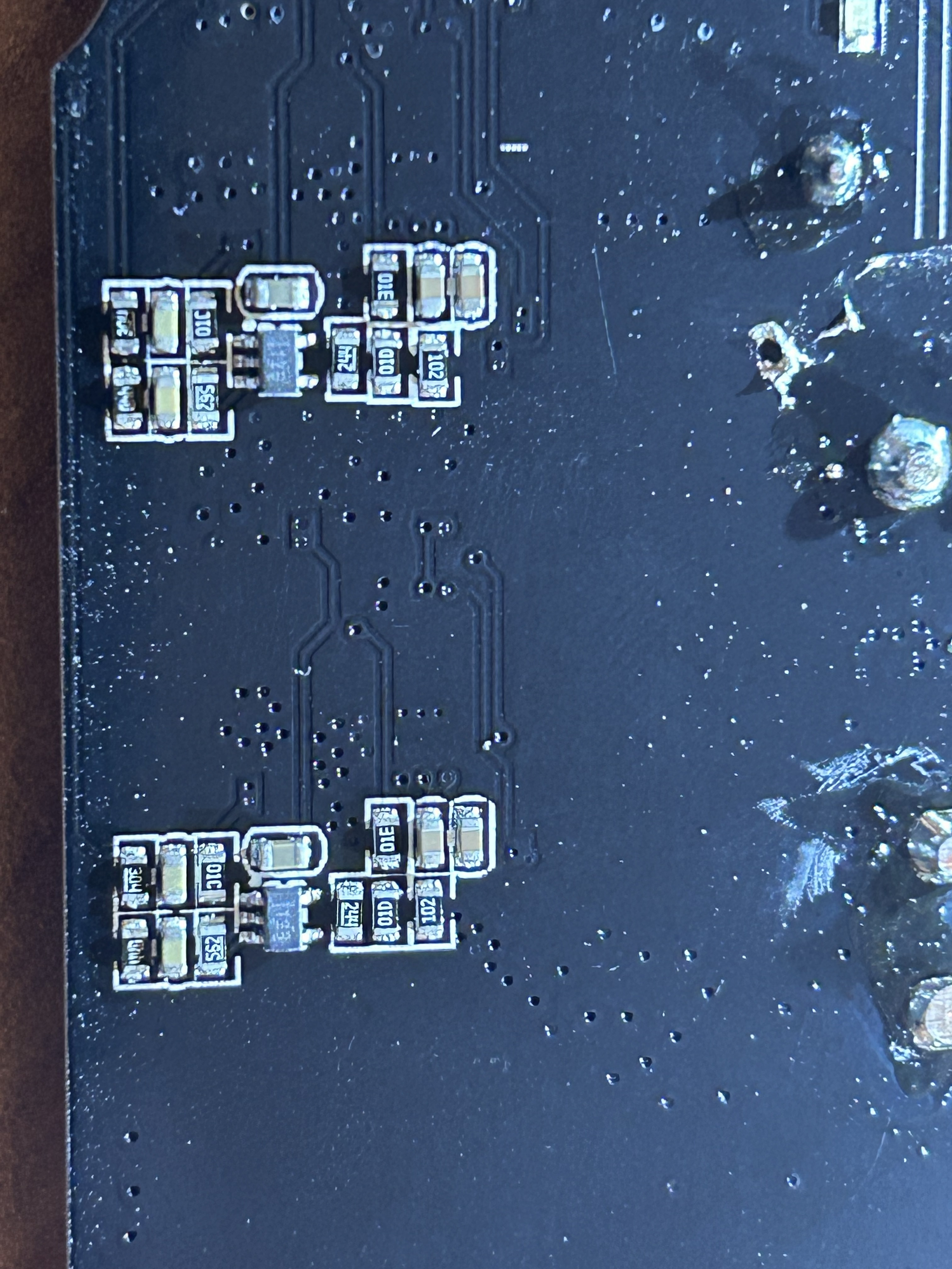

                        Here are pics of the back and chips.

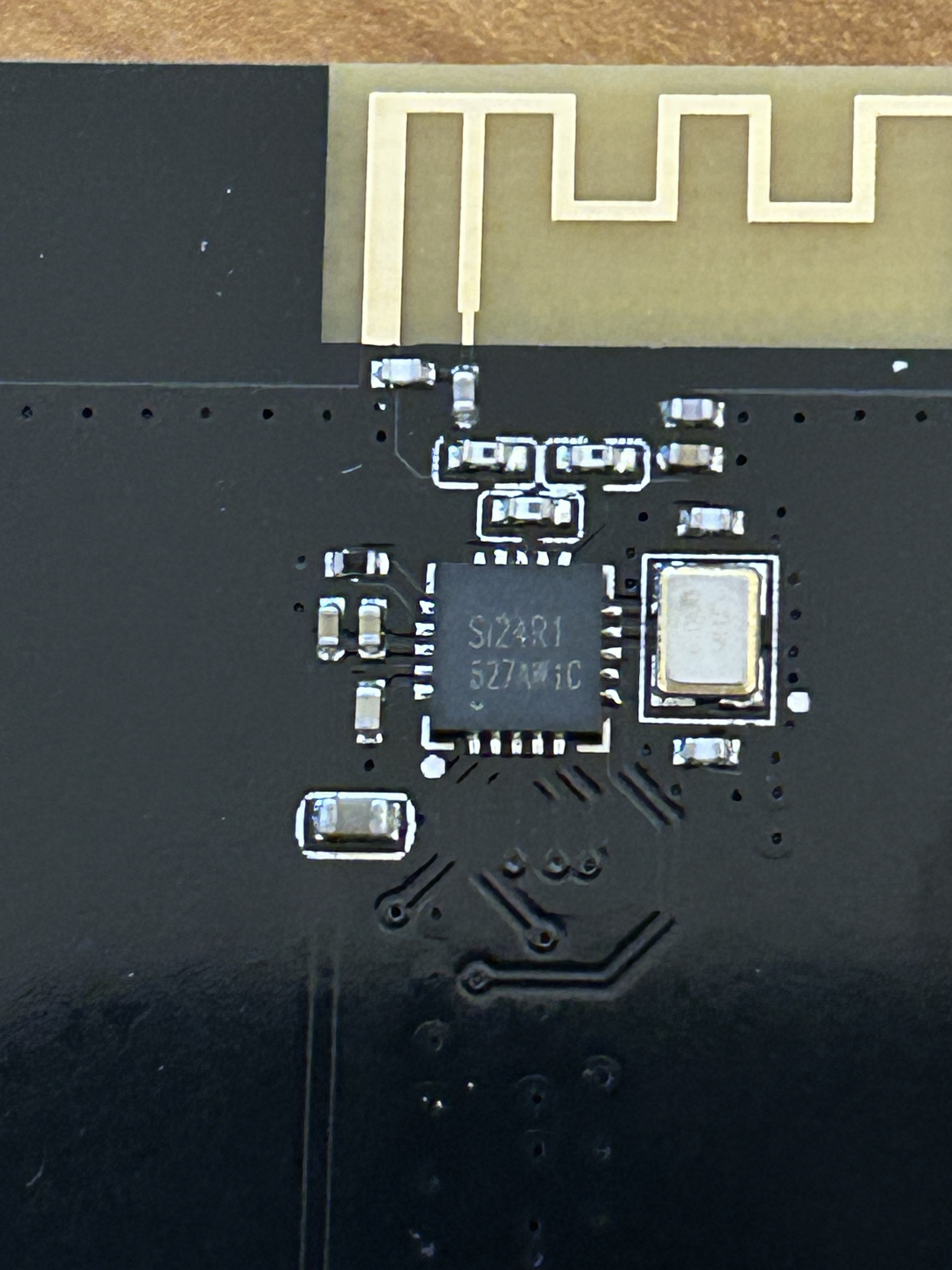

                          Si24R1 is a wireless transceiver.
                          http://www.szczkjgs.com/UploadFiles/...652/Si24R1.pdf (Si24R1 datasheet)
                          https://www.easy-core.com/file-download-530-left.html (module)
                          Those two SOT23-5 ICs look promising, but I haven't been able to identify them. Is the marking "|128" or "|12B"?
                          Edit:
                          Nope, "12B" is an op amp.
                          https://www.ti.com/lit/ds/symlink/tlv333.pdf (TLV333IDCKR datasheet)
                          https://pt.aliexpress.com/item/1005007900820691.html (photo)
                          I'm stumped.
                            • 31204
                            maybe the 2 sot23's on the front are fets,
                            why does it have a stripline antenna?
                            is it bluetooth controlled or something?
