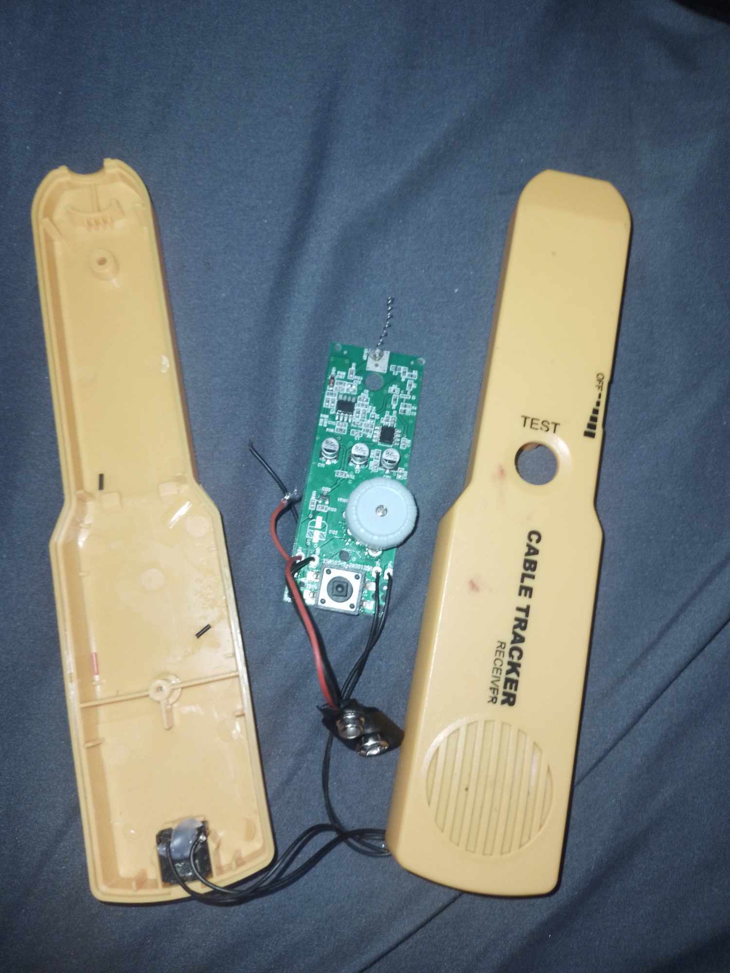

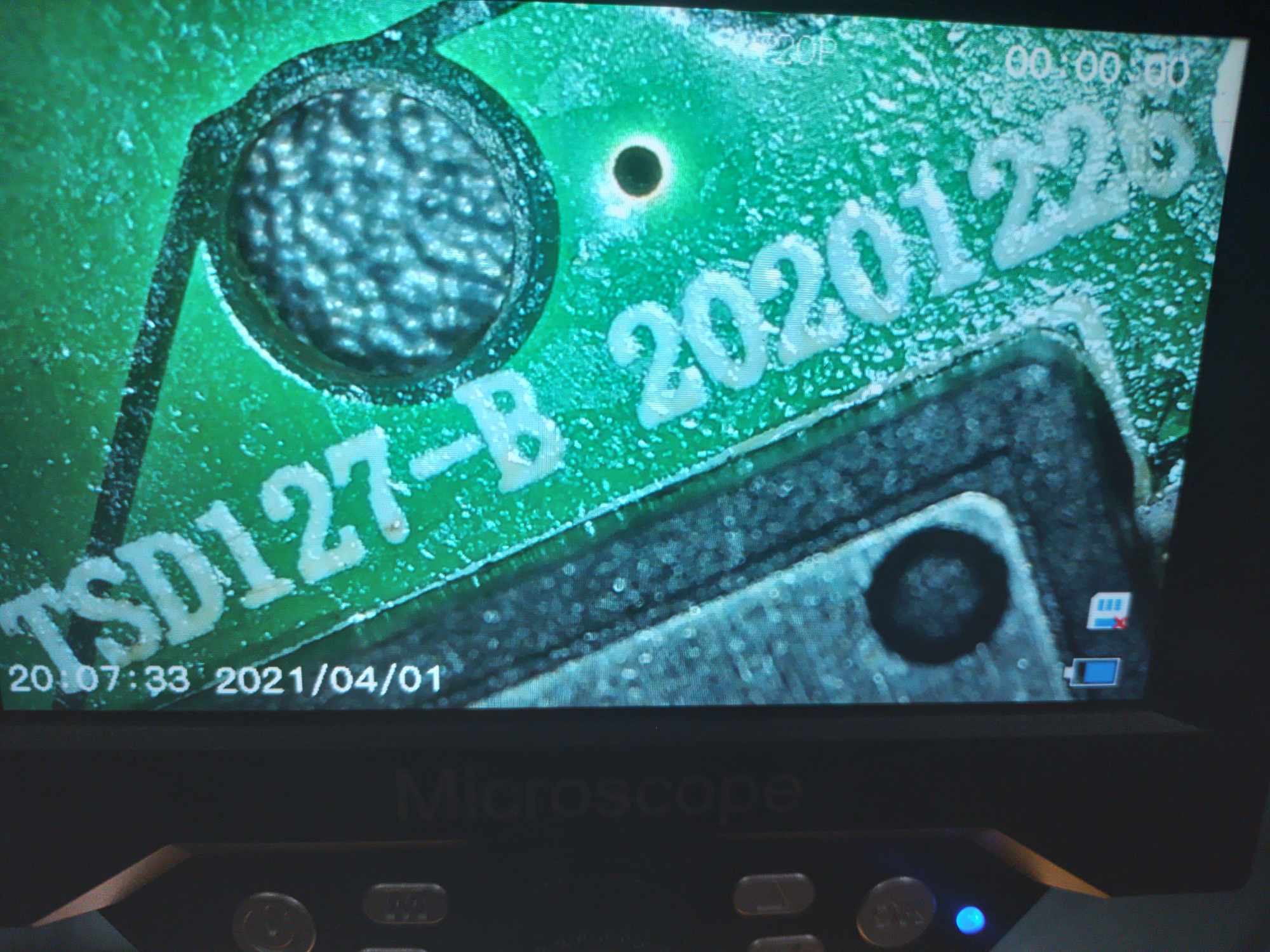

    smd component called
    Can someone know what smd component is this? it's white with no resistance

    By "no resistance", do you mean 0.0 ohms or open circuit?

      Silk screen arround near area may be helpfull...
      It may be small value capacitor, fuse...

        btw here is the device I'm trying to repair
          it's open

            It is capacitor near opamp, silk screen like "C55" or so... it is normally "open"...
            Why is it suspicious?

              It looks like a capacitor to me, and I've analyzed many SMD components in my 20+ years in failure analysis. Do you think it is bad?
                Looks like a C0G capacitor to me. Shouldn't have any resistance.
