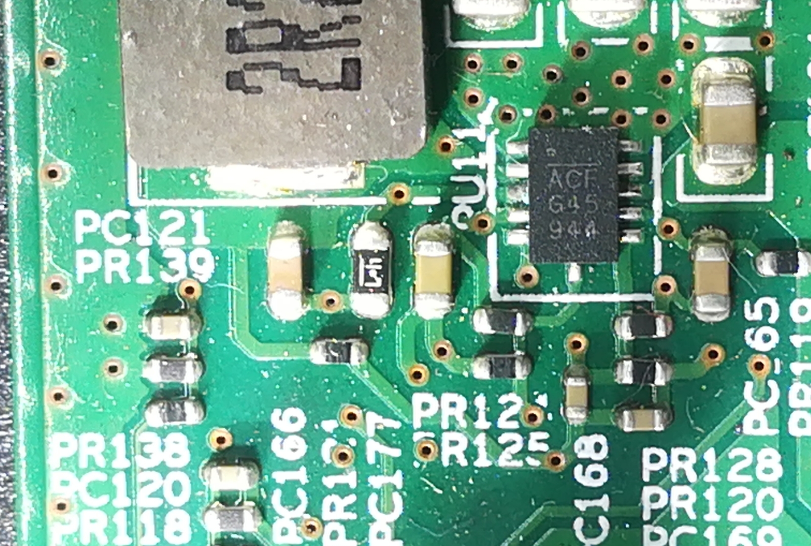

    Hi folks.
    Any help with identifying this IC? Should be some DC/DC step down converter. 'ACF G45' ... I thought, it is Monolithic Power Systems ( based on this topic --> https://www.badcaps.net/forum/troubl...and-datasheets ), but can't find this marking there.โ€‹ Will be thankful for any hint. Thanks in advance.

    ACF = MP28258DD-A
    http://markingcodes.com/search/c/acf
    https://www.monolithicpower.com/en/d...cument_id/556/ (datasheet)

        You are correct, thank you so much! Have a nice day.
