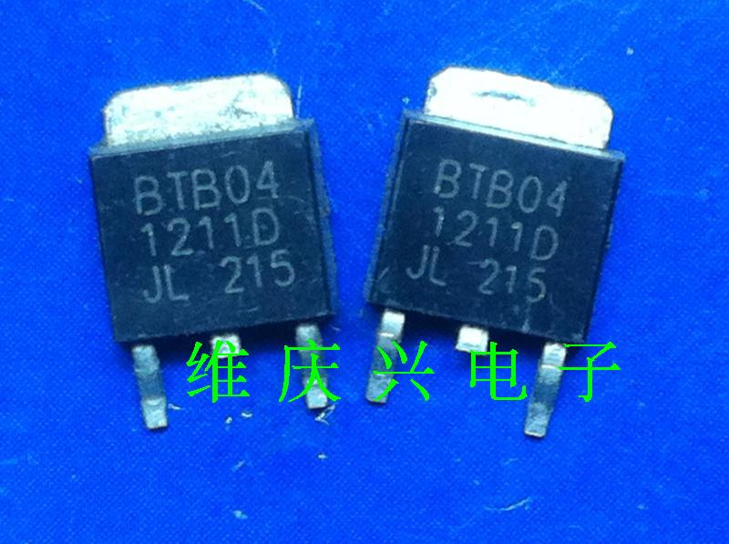

    Hi All,
    I believe it to be a TRIAC on TO-252 package, but O might be wrong.
    If anyone can help it would be greatly appreciated

    May be

      This turned up in a Google search, but the link to the description is now dead:
      https://img.alicdn.com/imgextra/i1/T...0-item_pic.jpg
      Anyway, it was described as "BTB04-1211D 600V 4A Original imported two-way thyristor patch MOS tube TO-252 in stock - Taobao".
      I guess that makes it a TRIAC.

        truclacicr yep that is perfect. Thank you. That is the faulty component as well so just got to try and locate a replica
        Many thanks
