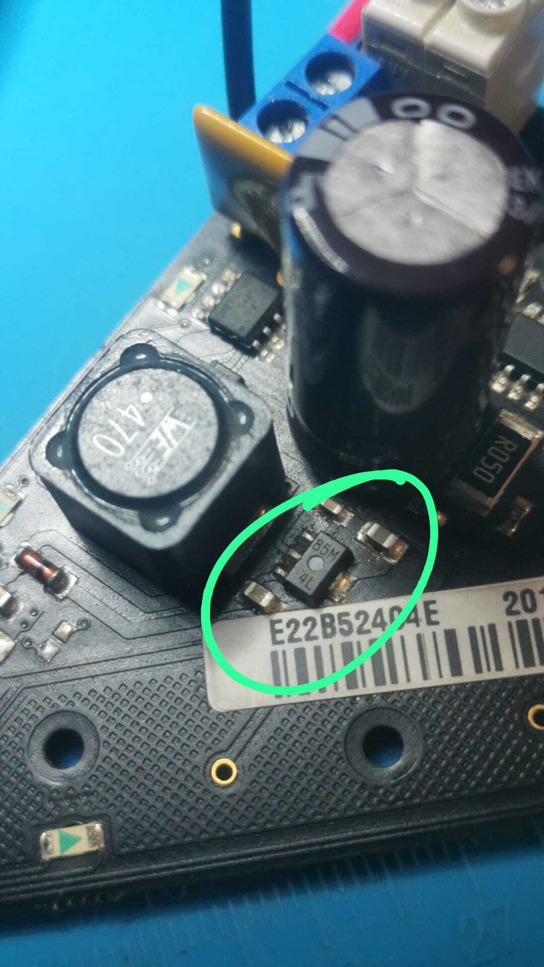

    This 85M 4L component is burned out and I have to replace it, but I can't find its datasheet or where to buy it. I'm sure I'm doing something wrong.
    Can anyone help me which component it is and how to locate it on the web?​
    Thanks.

    XC6701D502PR-G (5.0V regulator)
    https://www.jotrin.jp/product/parts/XC6701D502PR_G
    https://www.jotrin.jp/productFiles/b...94233_5135.jpg (photo)
    https://product.torexsemi.com/system...ies/xc6701.pdf (datasheet)
    http://markingcodes.com/search/c/85m

      Thanks truclacicr.
      I dint know markingcodes.com.
      I suppose that when you are looking for a component you use this website and from there you get all the necessary info about the component you are looking for, don't you?

        Yes, markingcodes.com is a useful starting point. I don't use it for finding datasheets, though.
