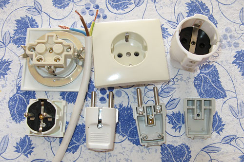

    Re: Alternating current & neutral wire
    its mostly schuko here (German)

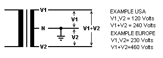

      All my before posts were based on the Australian system were we use
      a a single phase (mostly) to homes.
      (not sure but this maybe changing now but thats another story)
      This could result in some confusion for USA and Canada readers
      which I have since found out use a rather unique and interesting delivery system
      (and others like me of their system...confusion)
      Its called Single Phase 3 wire or Split Phase * system (*not good to use cause it can be confused with motors)
      They do in fact have 240 Volts Available but its designed so they have the best of both worlds
      Either 120VAC or 240VAC. depending on the current demands of the devices used, this also somewhat increases the safety aspects by having a lower more generally used voltage of 120VAC for lower powered devices
      Hows it Done?
      The Key is that the last step down transformer secondary, rather then just use one side as Active and call the other Neutral and tie it to Earth
      Its is center tapped.
      The center tap then becomes the Neutral (which gets tied to earth)
      and you end up with effectively 2 ACTIVE lines from either end of the secondary winding.
      like the following.
      it is used else were in the world but on a more limited basis
      It does result in 2 Actives running in opposite directions so some wrongly think of it as 2 phases, its not
      (there was in time passed a 2 phase system which I think helps add to the confusion)

      if you think carefully about it with the 2 Actives
      they are going at the same Rate of change in an equal but opposite directions with respect to each other
      Now with respect to the Neutral even though heading in opposite directions they are at the same point in their cycle so are in phase.
      I think a trap to watch out for is the colours used too....Red and Black are Actives and white is Neutral
      (So dont make the mistake of thinking a Black wire in the USA or Canada is neutral..its not...ditto if you are in OZ dont make the mistake in thinking white is Neutral its not...its a Switched Active or a Phase 240VAC wire)
      So you Have
      120VAC "A + Red" Active
      120VAC " B - Black" Active
      with respect to Neutral (White)
      240 VAC between the Red Active and Black Active,
      Active to Active is 240 VAC
      So if someone mentions in a post about red active A active or + Active etc and they are from the USA or Canada you will know what they are talking about.
      HTH

        starfury1; aren't the two system quite equal?
        I mean, in "the world" we have 230v AC when we connect something to neutral/ground
        And we get 460v when we connect two phases together...
        In the US it's the same just lower voltages and different frequencies?

          in Answer Yes if you use a Split phase system, but here I dont think its used at all
          not sure on your neck of the woods Per
          but as far as I am aware, here its 240 VAC (NOW 230 Volts nominal) single phase buddy, thats all you get unless they bring another phase line to the house.
          it was 415 Volts AC between phases here so its from a 3 phase system
          (not a split winding) with 120 degree phase shift. (phase to phase)
          (it wont be quite that now we have changed to 230 VAC)
          You system may use a single phase (split winding) like the US
          I dont know, it is used in Eroupe according to the the diagram and the info but I have no idea to what extent.
          I don't think its used at all here but I could be wrong...not the Guru on world power delivery systems.
          It was enough to add confusion to the mix which is why I posted it so people would be aware...its sounding like we are the "odd man out" if you get what mean LOL

            Sorry Starfury1. Your comparison of 230/460VAC system with the American system is not correct , it is way off. The American system is a single phase 240VAC with a centre tap taken to neutral, and neutral is typically connected to ground so that maximum voltage to ground is 120VAC.
            The system in Australia and and other parts of the world is based on a three phase generation. Each phase is seperated by 120 degrees phase angle and each is 230VAC above ground. The voltage across any two phases in 440VAC , not twice the voltage because of the phase reslationship. Many dwellings are supplied one phase only ie 230VAC, the street wiring is most often three phase and different dwellings are connected to different phases to spread the load. Major buildings/factories are supplied with three phases for motors that can utilise the benefit of three phasepower. The single wire colours in Australia are: RED = active, BLACK = Neutral and GREEN/YELLOW striped = Earth. Typically as in the US the neutral in a building is tied to ground at one point only, insuring no voltage is higher than 230VAC above ground. Three phase wire colours are RED, YELLOW and BLUE as seen on three phase equipment. We in Australia follow the UK standard.

              Yes the first one was to make the point the USA/Canada is done differently
              Since all my older posts were based on our system
              (3 phase, or rather a single phase of ours with reference to neutral)
              The idea was to make people aware of this fact...that it is done differently cause of the confusion that might arise from it.
              I didn't touch much on our system at all in it.
              The second post was in answer to Per question and it would be yes "IF" they use a split phase system.

              Per just so we got it right you are correct "IF" it is a single phase 3 wire (Split phase) System
              Mostly the world is 3 PHASE so no it would be incorrect if was 3 phase system as Davmax said and I said above
              120 deg phase shift will result in a different voltage level between the phases.
              (you will find the maths in those links somewhere I am sure)
