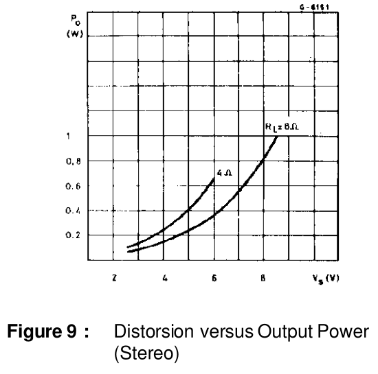

        There's another graph in the tda2822m datasheet :
        So basically with 8 ohm speakers once you go over 9v, distortions are higher than 1% (which is the maximum i'd tolerate) and you only have 1w of audio power.
