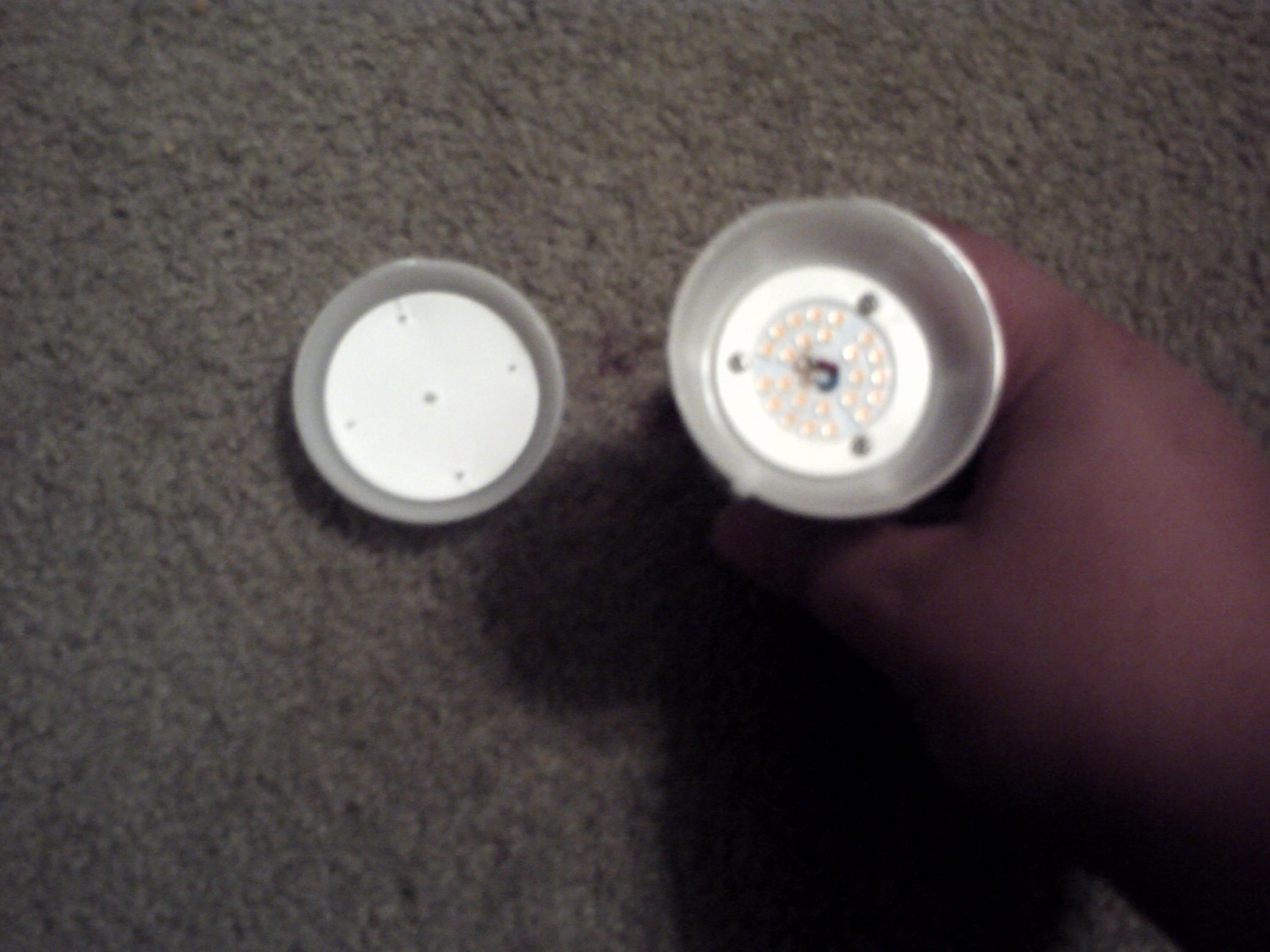

      I just tore apart a 12W (60W equiv.) omnidirectional Greenlite LED bulb (bought for US$10.99 at a grocery store). I discovered that it uses 24 SMD LEDs running at 94VDC. Unfortunately, the power supply portion was potted. The UL number on the LED board traces to "Shung Ching Electronic Technology Co." which appears to just be a PCB manufacturer.

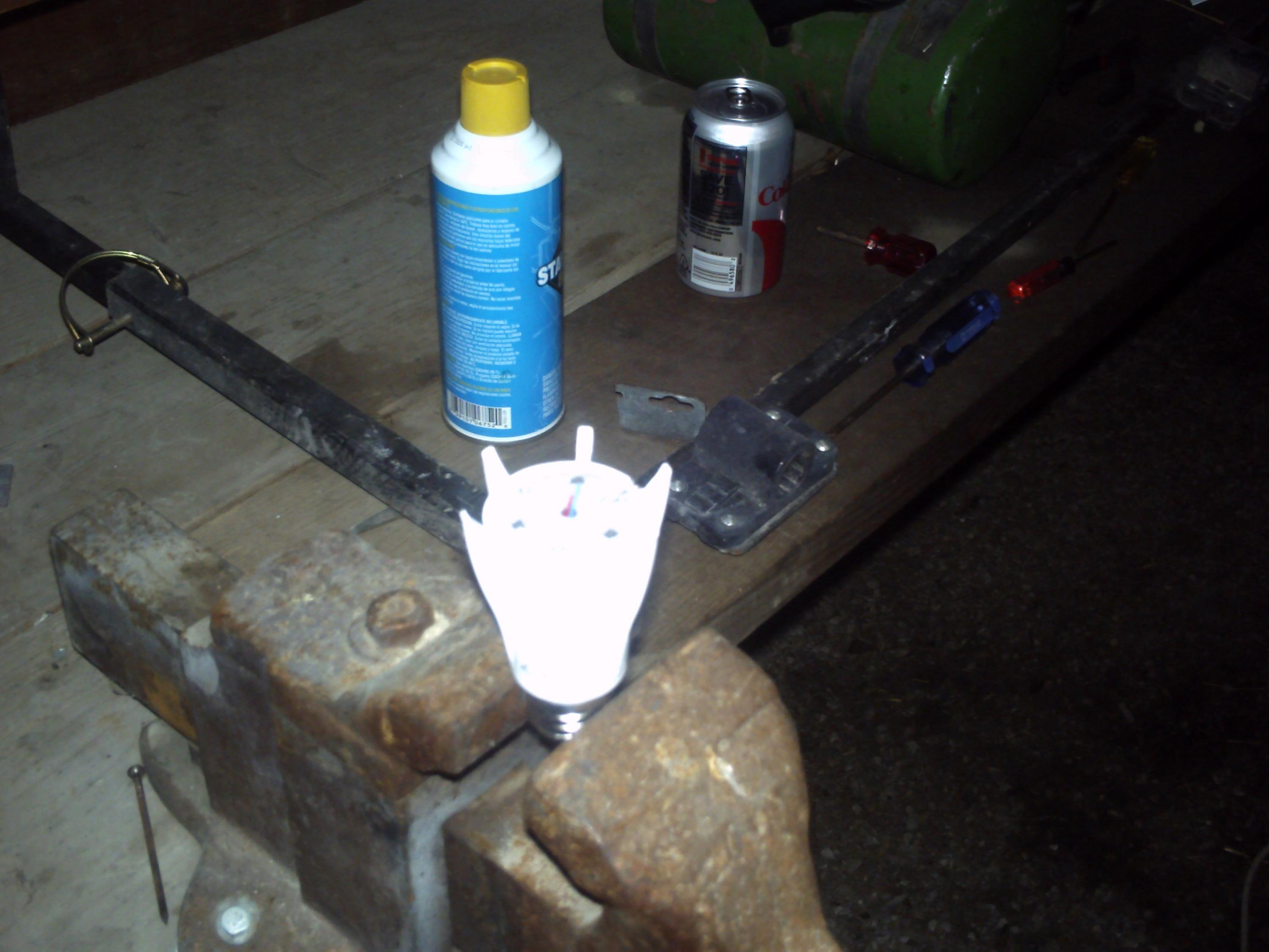

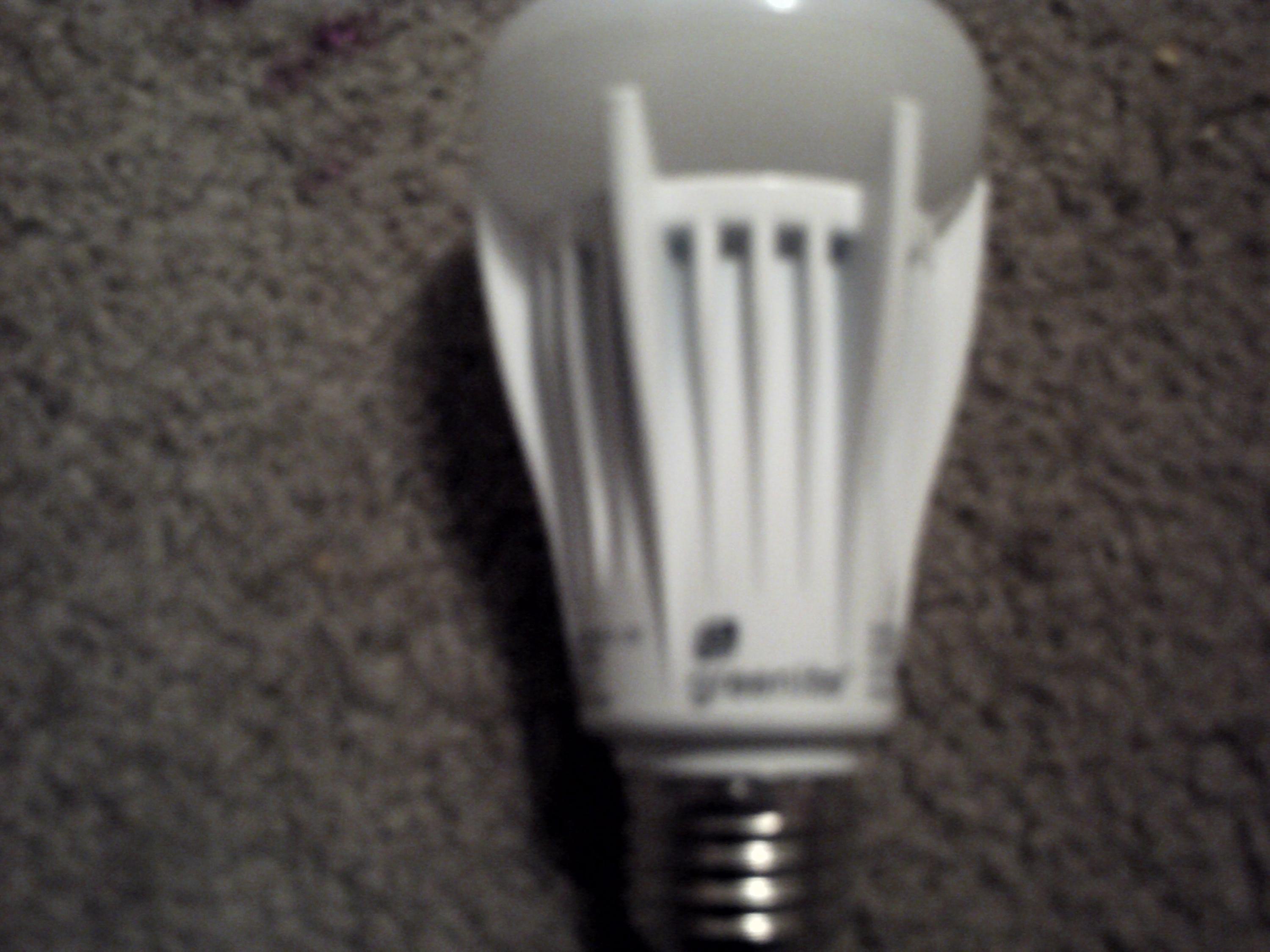

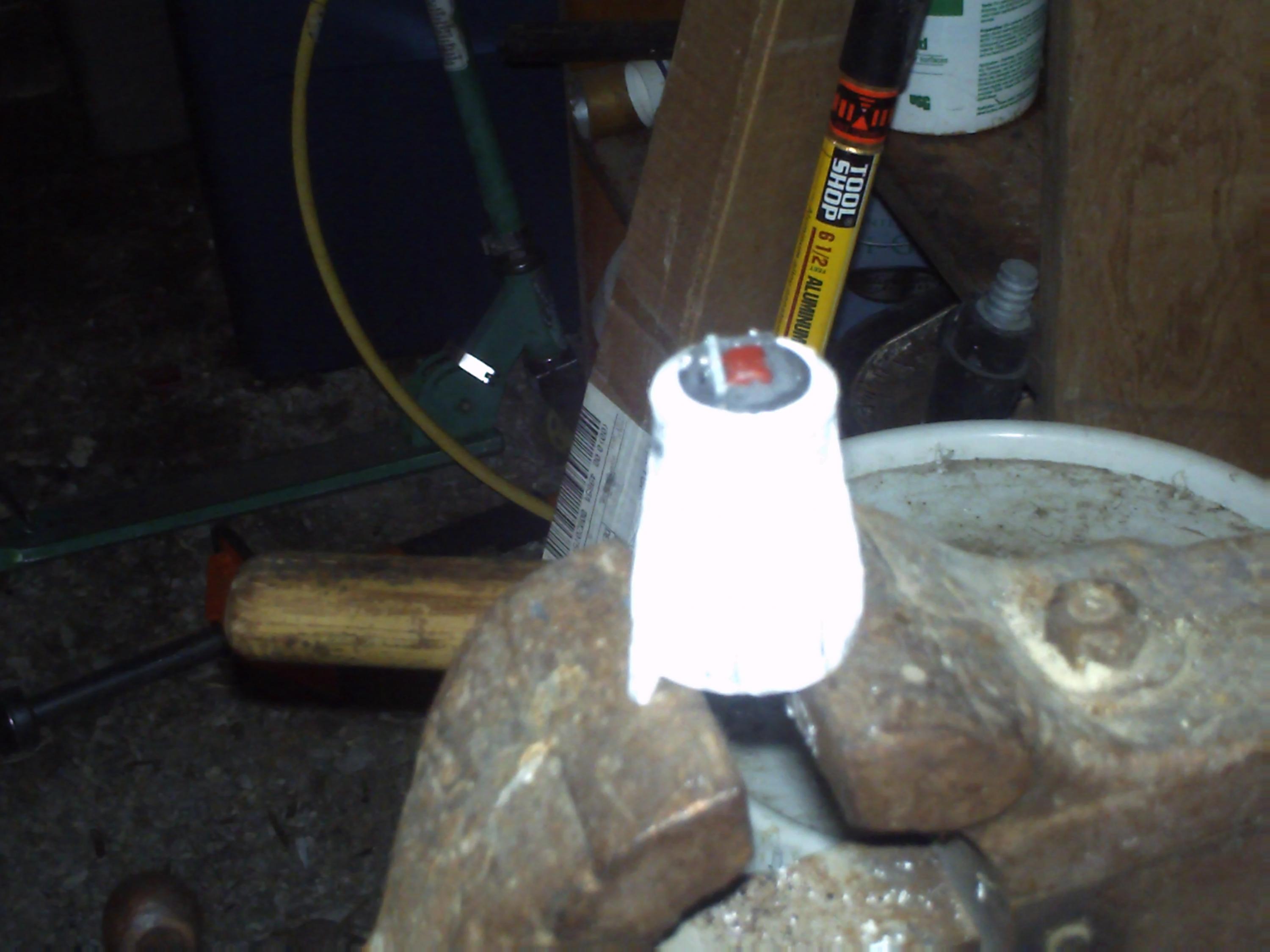

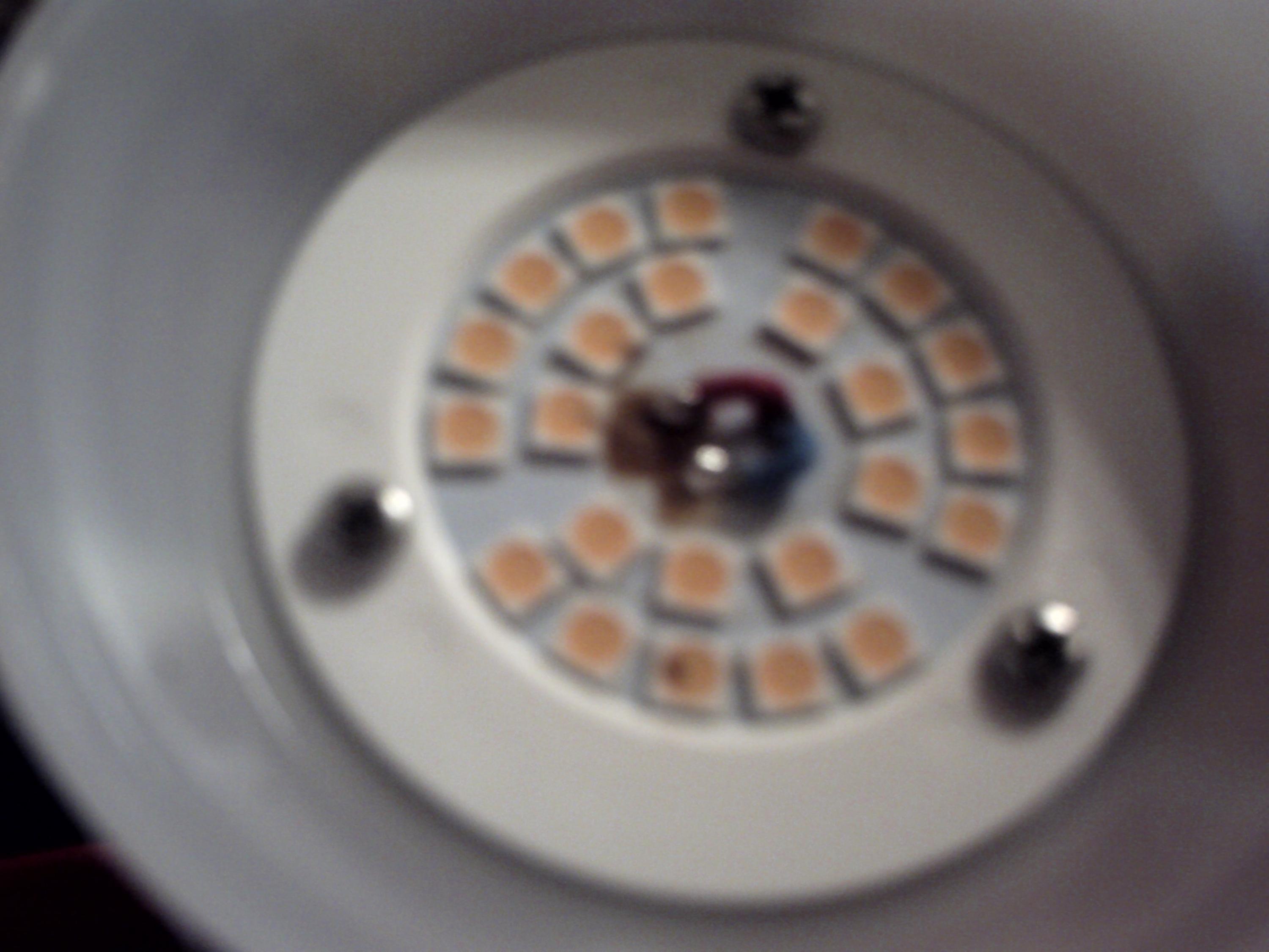

            Here they are. The pictures are:
            -The bulb before I disassembled it
            -The top of the bulb removed
            -The LED board (I wonder why one of the LEDs has a dark spot. This bulb was still working before I took it apart)
            -The bulb clamped in a vise, attempting to open it further
            -The base of the bulb, showing the visible portion of the power supply.
                        Too much current! This will be the common problem with the cheep, upcoming Light Emitting Decorations. It was, and still is, a problem with those nasty harbor freight LED "flashlites." Multiple LEDs, either overdriven and/or with no current limiting, other than the batteries. After just a few weeks, you have DEDs- dark emitting diodes...
                        Ben7- some of your "corn bulbs" used to use a simple capacitive dropper power supply. Just an X cap, a few 1N4004/7s, and a zener. As LED light power supplies, they have terrible ripple, most of the time there are no large electros.
                        The nicer ones have a proper buck converter, even fed by a proper PFC- just like a computer/monitor power supply!
