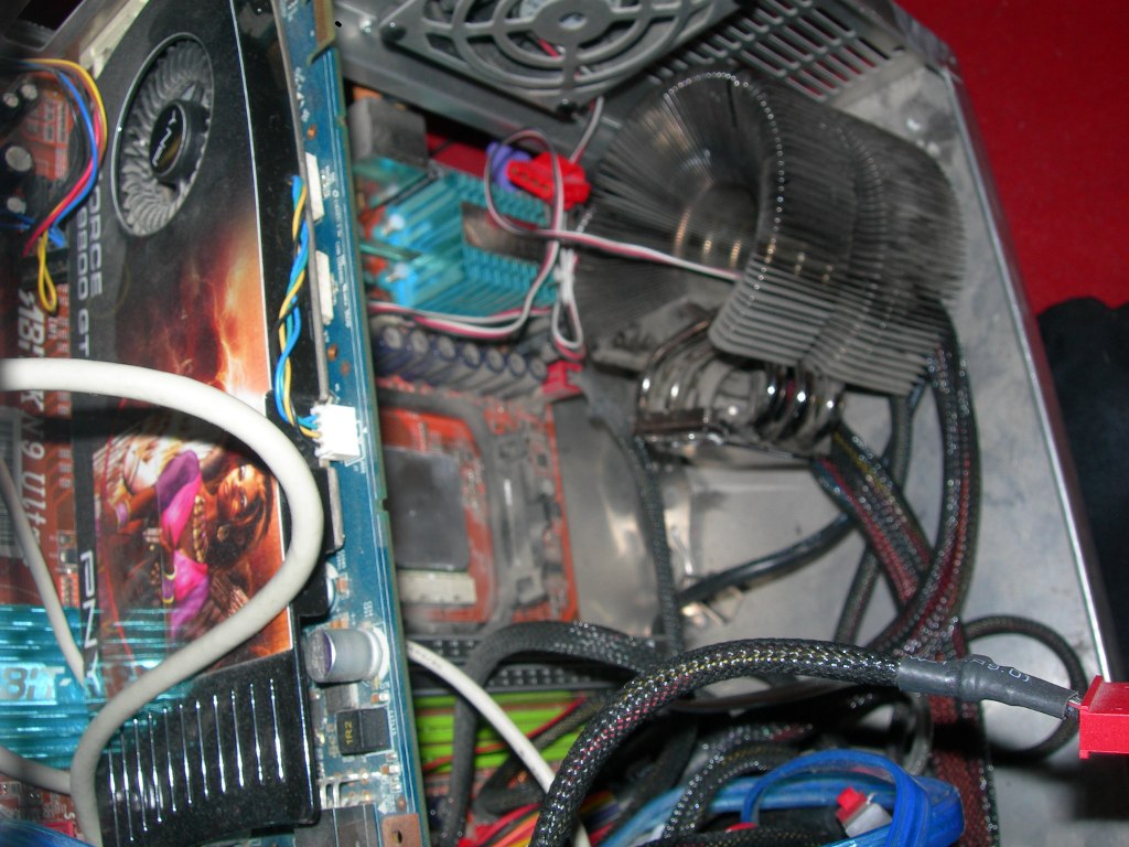

    It's an NVIDIA Zalman heatsink+fan assembly.
    It came mounted on the motherboard I got from my brother.
    It looks like the metal clips just broke. I've looked it up and it has happened to a few other people before me too. The heatsink is really heavy and rests on just some small metal clips.
    Luckily I didn't power it on, I noticed before...
    So... is it fixable? I have a heatsink+fan assy from a broken Gigabyte motherboard, but I'm not sure if it will fix.

    Why don't you just try another heatsink? Salvage a x-clamp from another mobo...

        That can't be 939 it's an AM2 or 754 system... Just get a newer retention bracket that's made out of better plastic...

                Oh, I thought the retention bracket's clip broke...
                  Re: Processor heatsink fell off...
                  The metal part for clamping the heatsink to the processor is what broke. Sheared right in half. The motherboard is okay...

                        I think that would be an Athlon 64 FX-62, not FX64. Double check. If yes, those are rated for 125W TDP - so no, that heat sink is not overkill at all.
                        Doesn't sound like something that zip ties or thick steel wire won't fix . I've done it with many other heat sinks. Works better than the original most of the time.

                            I wouldn't use that fleabay stock heat sink with a 125W CPU. I'd go with a coolermaster hyper TX3. They are cheap, but surprisingly quiet and effective.

                              I found someone selling it for £4, so I'm going to give it a shot. In the worst case I will wait before I start using this PC to play games. I just finished Crysis for the third time before the heatsink fell off. I will see how well it performs. If it gets too hot, I will upgrade it. The media PC (with single core variant) uses a stock cooler and it runs at less than 40°C most times.

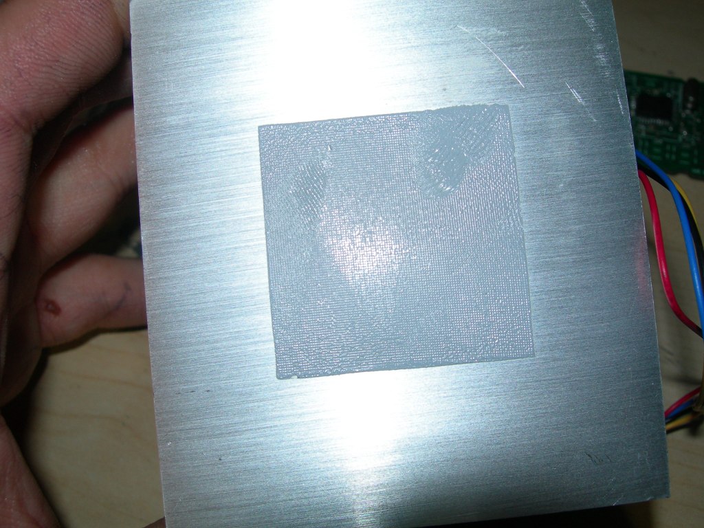

                                  Okay, so the heatsink/fan assembly arrived today. It looks like it has a thermal interface material fitted to it already. I do have thermal paste if I need it, but do I need it if it's got this already?

                                    strip that away you need fresh stuff always.

                                      That's the typical thermal adhesive that ships with all AMD stock heatsinks. It's pretty good (and also a PITA to remove). Snap it on and that's all, no paste needed.

                                        Wouldn't he need to move the gell on his processor before applying the fan with the thermal adhesive
