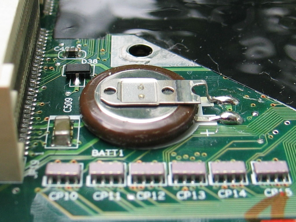

      Thought about posting a new thread in the laptops forum but decided to post here since it deals with the same topic. Had to replace the motherboard in my Toshiba Satellite 1735 laptop recently and found that the new motherboard wouldn't retain the CMOS data. I was expecting to see a standard coin battery but it turns out that the CMOS/RTC battery is soldered to the motherboard, and web searches seem to show that it's a rechargeable lithium-ion battery. Apparently it's no longer holding a charge if that's the case. I initially thought about desoldering it and replacing it with a standard coin cell/holder but then found out about it probably being rechargeable. I don't think that's a good idea with the motherboard circuitry trying to charge the battery. Also it's been quite difficult locating a replacement battery. Thanks for any advice and suggestions. Attached is a photo of the battery.
        Re: CMOS battery life
        A battery part number or at least the voltage would help.
        I think if you look you can find a rechargables that will fit in holders.
        You can also solder wires or pins and stick a holder somewhere else in the chassis.

            Is there a jumper anywhere to choose between standard and rechargeable?
            I ask because an old Socket 3 (!) board I have used an onboard soldered in NiCd but it had failed (of course) - but there was provision on the board for a normal battery to connect via a pin header (those kind which are a 3v lithium AA-size battery inside a black plastic case with a lead and plug)
            I installed the header, changed the jumper, new working battery and the board doesn't try to recharge it.
                @ eagle2a: let the laptop sit for a while with the charger plugged in.
                took a couple hours for the CMOS battery (also rechargable) in one of my old toshi's to take a charge after it was left unused for ages..
                it kinda seems to tickle-charge it if it "thinks" there's no battery or it's dead, so it'll take quite some time till it reaches the voltage threshold where the laptop actually starts charging it normally..

                  That's true.
                  CMOS battery charge circuits are not fast chargers at all.
                  They are intended only to keep the battery topped off.
                  Restoring dead ones is not in their job description.
                  Eventually they will do it if the battery isn't shot but it could take a day or more before you've actually got a full charge.

                    Thanks for all the excellent advice! I'll try it and see how it goes.

                      @Agent24:
                      No, there isn't a jumper on the board. Sorry I forgot to answer your question.
                      And it does appear that the CMOS/RTC battery is finally starting to hold a charge. I'm not sure how much and how long it'll last but I'm not having to reenter the CMOS data every bootup like before. I'll have to experiment with having the main battery in or out to see if it has any effect, as well as how long the CMOS/RTC battery is keeping its charge. Thanks again for the replies and advice!
                            Thanks again for all the feedback and replies. After over a week of observation, it appears that the CMOS/RTC battery is still not charging but the CMOS data is generally retained if the main laptop battery is present. The CMOS data is lost immediately if the main battery is removed (without external DC power) or if the external DC power is unplugged without the main battery present. I haven't decided whether it's worth all the time and work required to completely disassemble the system again to replace the CMOS/RTC battery. I was running the laptop on external DC power without the main battery present but I may just keep an old battery inserted now to retain the CMOS data.
                                  Personally I would replace it, even if just to prevent it from leaking.
