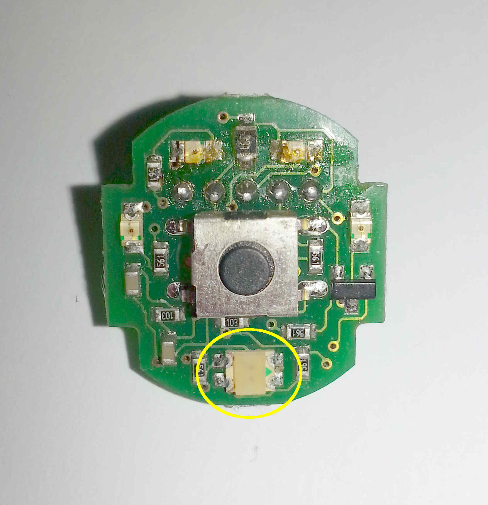

    Finding smd led to replace
    I got this fuel indicator board that has one color of the circled led not working, do you know what kind of led is it (it measures approximately 2x3mm) and if it can be replaced with a soldering iron ?
    Do you also know the kind of the other four leds above ?
    Many thanks!

    Re: Finding smd led to replace
    Nobody know what kind of led it is and if can be replaced ?
      How much voltage going into it, and what are the 2 colours supposed to be
        The colours are green and red, don't know how much voltage probably not more than 5V, if needed to know I will try to measure it.
        The other four leds are all green.
          Can you measure the size of the LED. It is likely a plain bi-color SMD LED, guessing 3.0*2.5mm but there is bigger 3.2*2.7mm etc.
          example: Kingbright APB3025ESGC-F01
          Once you know the size, a suitable part can be found in your locale.
          A multimeter on diode-test can check if both LED's are working, or if the green one is 3.2V or 2.1V type if it is working.
            The voltage on red led is 1.8V but strangely the voltage on green led is 5V.
            Do you believe it is normal or there is something wrong ?
