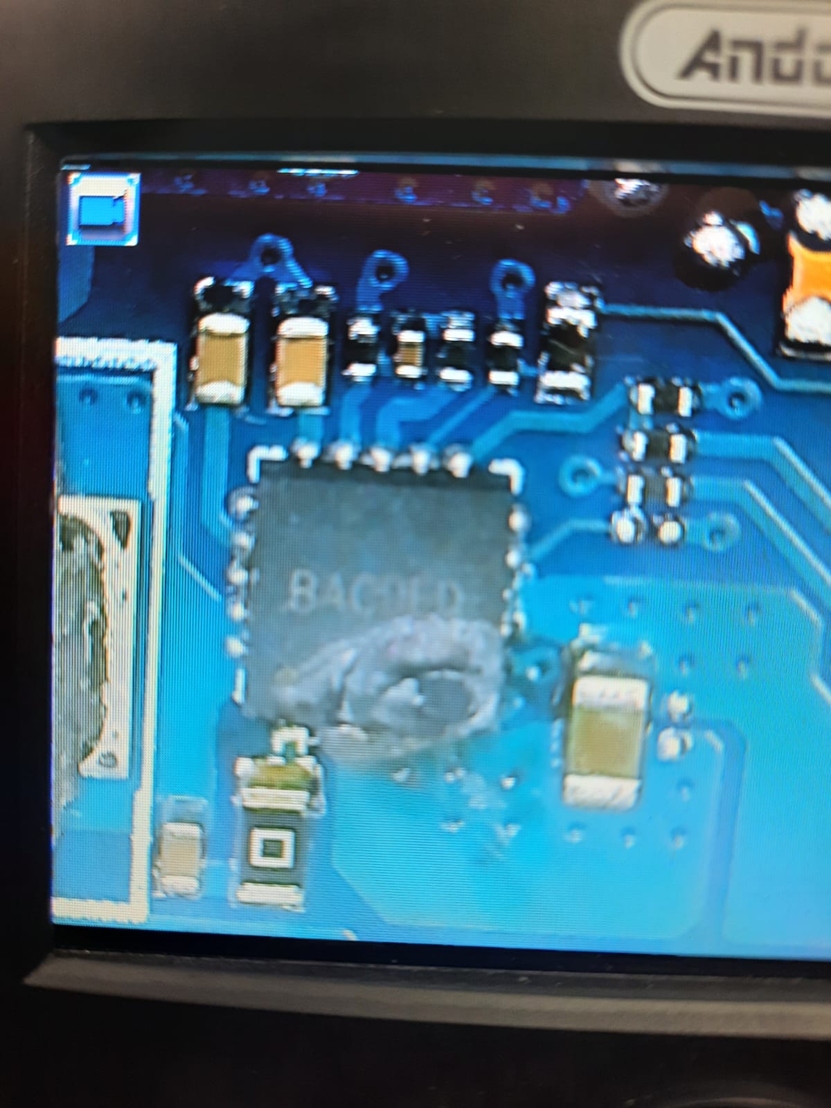

Help with identifying IC. Code on it looks like BACDED
  • ebyte64
    • Jun 2023
    • 51
    • South Africa
    Good day all. Would anyone perhaps have any idea what IC this may be? Code on it looks like BACDED. I have also attached a picture. My apologies for the quality.
    When I google the text I get a few results of a 10 pin sop real time clock IC. But not sure if this is a variant.

    Re: Help with identifying IC
    https://www.badcaps.net/forum/showthread.php?t=90619
    https://www.badcaps.net/forum/showpo...1&postcount=12
    BAC*** SY8288CRAC - N/D (Quanta ZHP ZSP)

      Re: Help with identifying IC. Code on it looks like BACDED
      Thank you so much. I did actually look at those threads first. Can't believe I missed it. What I get for being in a rush lol. Thank again.
