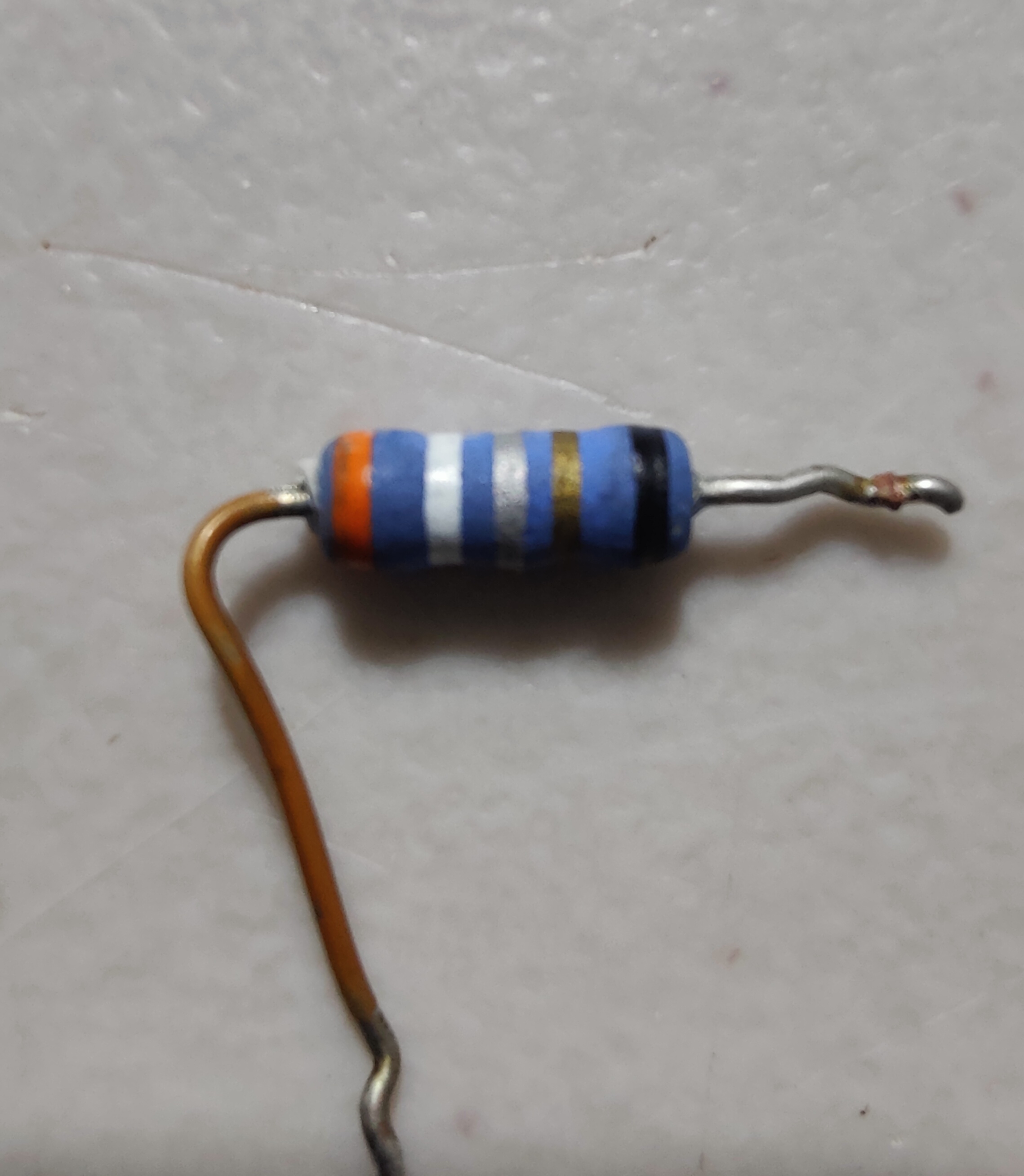

    I need help identifying this resistor color code (see the picture)
    Thanks in advance

    what does it measure as ?

      Re: Help identifying a resistor
      around 1ohm, but maybe is defective
        0.39Ω 5% non inductive, If it measures around 1Ω it is ok, Check your meter lead resistance, it is likely around 0.5Ω
            R J how you read the color code, starting with orange? because I was using a color code calculator online and the result was 39 ohms, but I believe I'm doing something wrong
              Orange = 3
              White = 9
              Silver = x0.01Ω
              Gold = +/- 5%
              Black = non inductive
                Right. Thanks R J

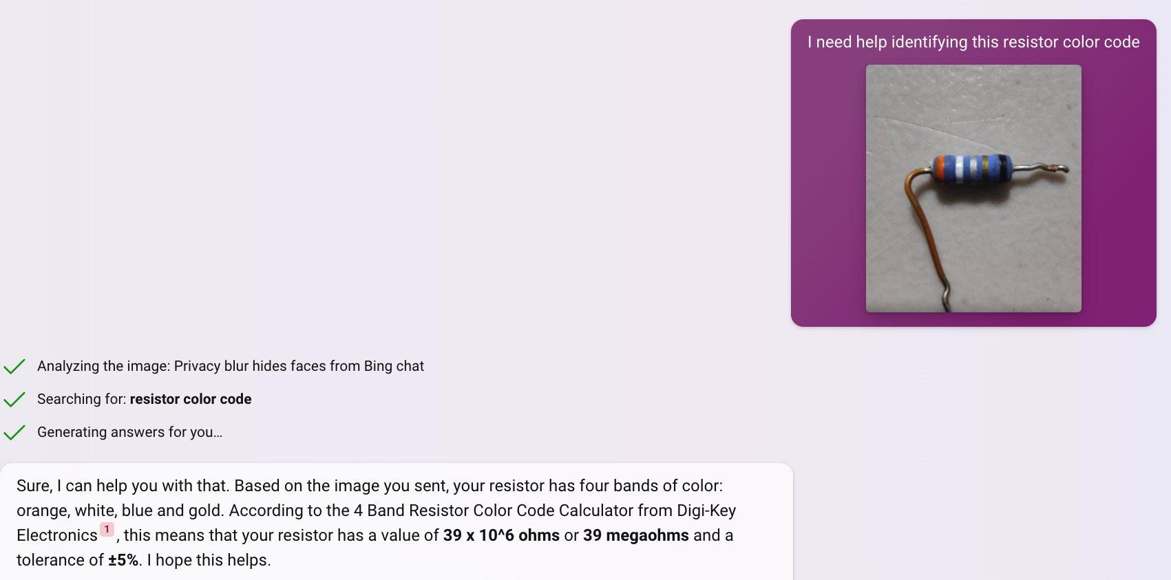

                    I tried asking AI
                      LOL Though I don't think resistor manufacturers are helping, AI has a ways to go...
