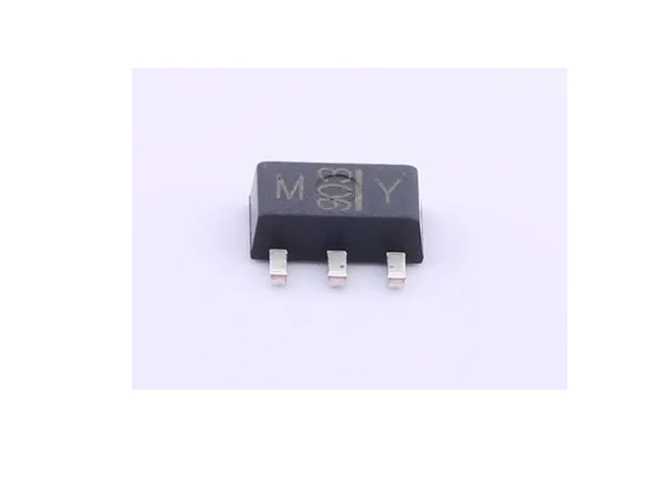

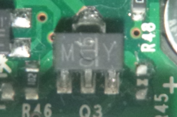

    been trying to locate the details of the following component but with no joy, so does anyone have any idea what this is?
    The markings are M 015 Y and it is on the main board of a Roland AX synth
    Thanks in advance

    Re: Sot-89 identification
    2sc2873-Y
      Originally posted by R_J
      2sc2873
      Nice one.
      The numbers are just to confuse us?
        By identifying the part you have helped confirm that although the transistor might be ok, the readings around it are off.
        I now have a clear area to check out out.
        So seriously... Thanks!
