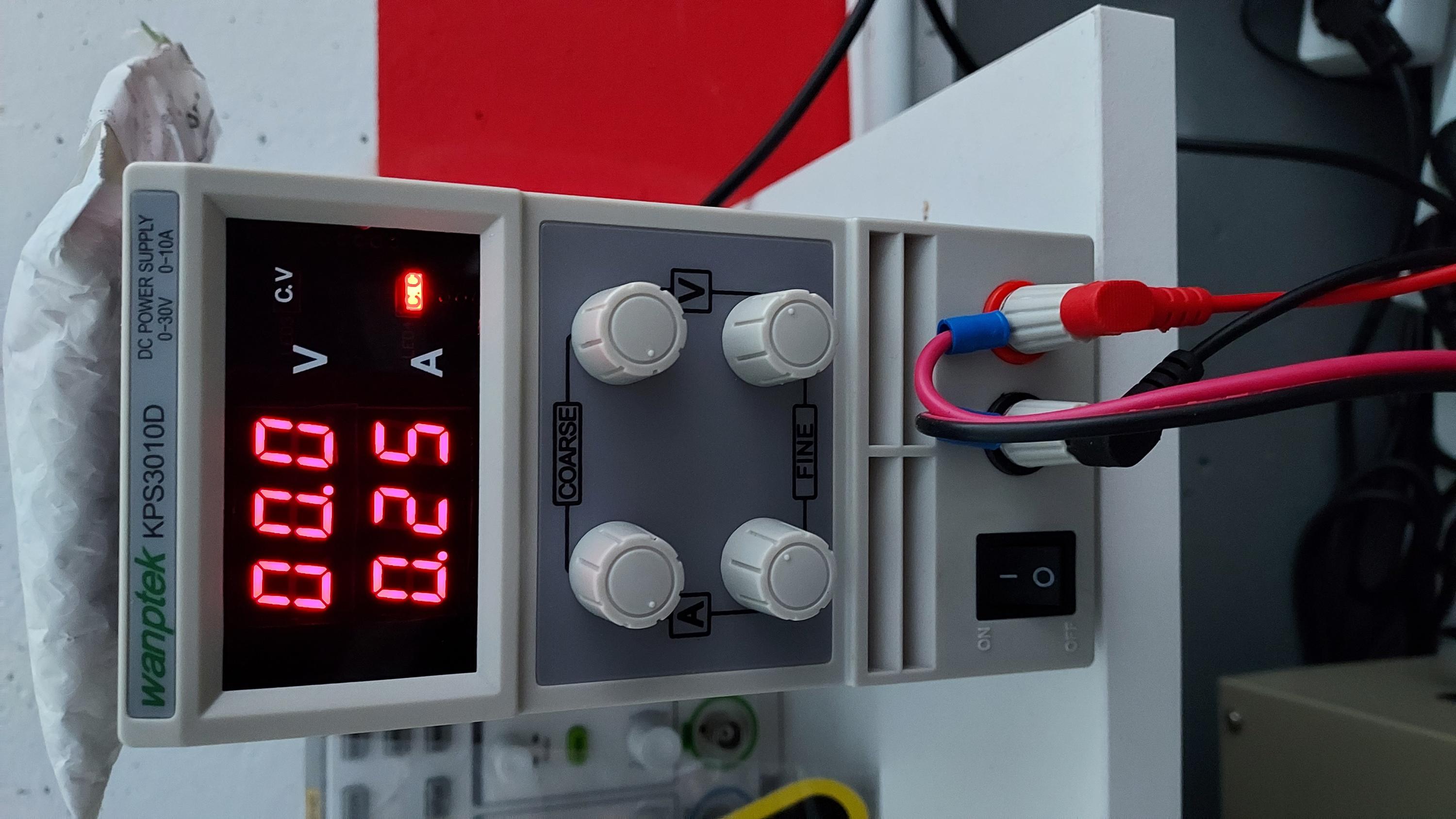

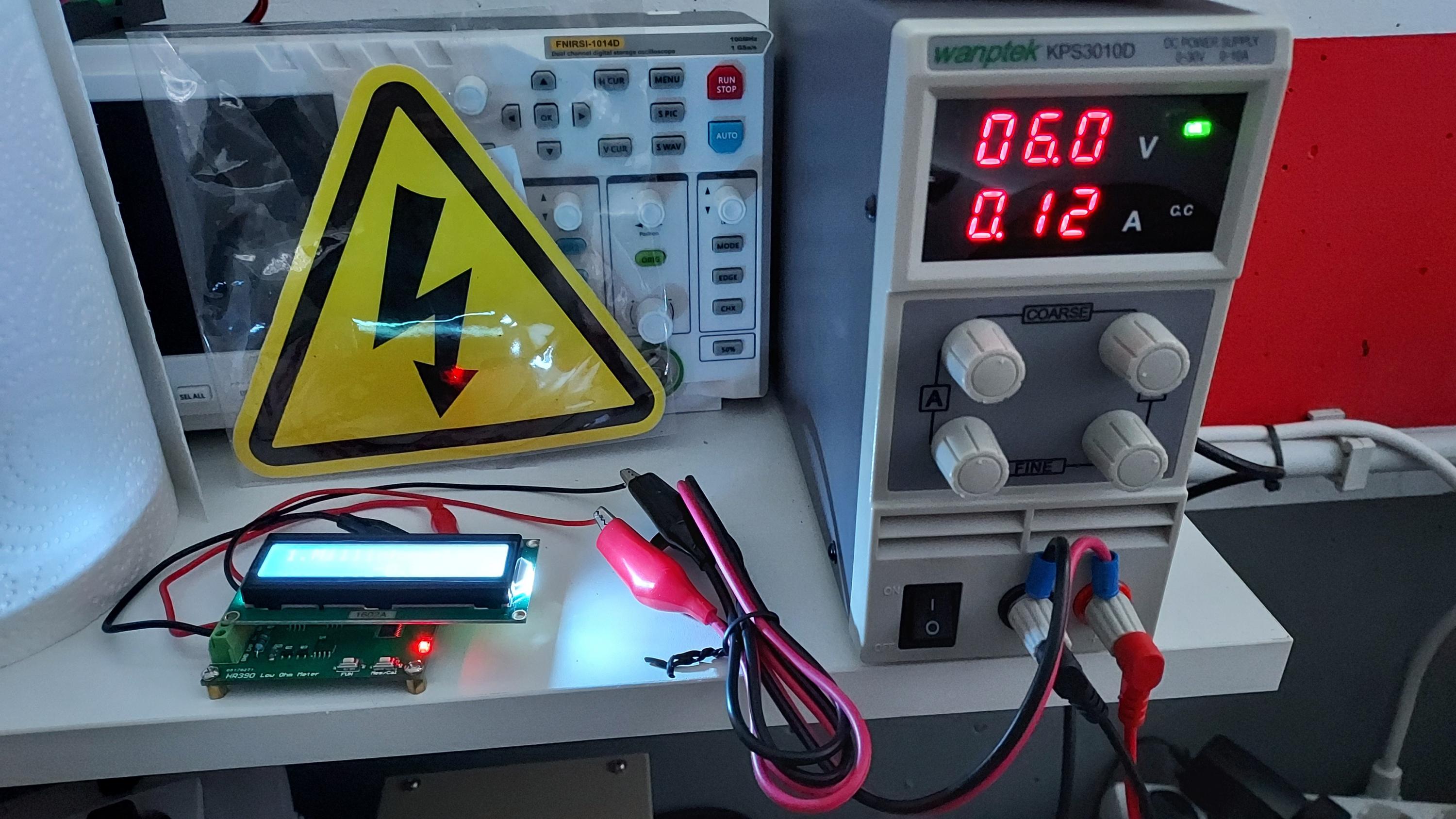

    Hi:
    I bought it long time ago this Wanptek KPS3010D SMPS.
    I would like to use it for injecting Voltage into any circuit, but not sure whether is designed for this purpouse.
    This is the sequence I am following:
    1. I start shortening the probes and setting 250mA
    2. Then I set Voltage to 6V without any load.
    3. I connect load..........and voltage drops to 4.1V !!!
    (For this testing I know the load consumes 120mA)......
    I don't see how I am supposed to use it for injecting load if it does whatever it likes....
    Thanks for any feedback,
    Francesc.

        From your pictures I dont get it what is wrong, I see that noobs are in different position on each foto, you do 250mA limit and that not conserned if load is lower. Voltage should be the same if current limit not reach, or uncarefuly touched.
        For injection, for finding the short on pcb, make shure that psu dont some protection to cutoff output... if is all ok, the wire and clamp has to start heat when short connected and leave that about some time.

            I knew it for sure that it was crap so I disassemble it. Just by visual inspection I realised that the output capacitors were bad. The one from the left had a leakage.
            I removed all 4 and they were completely dead. No capacitance at all, and open circuit.
            Furthermore, once removed I realised that the one from the left was assembled with wrong polarity!! Maybe the rest died because of this. Now the PSU works as expected without any fluctuation.
            I will do the Bulb test and I will post the results :-)
            Again this time was because of badcaps and assembly guys that do not pay enough attention
