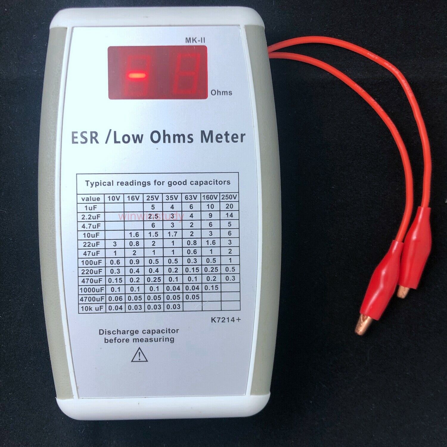

Chinese clone of Bob Parker Blue ESR meter
  • jayjr1105
    • 281
    Maybe these have been around for a little while but first time I've seen chinese clones based off the BlueESR/BobParker
    https://www.ebay.com/itm/133690692481
    Seems they claim the Zilog finally got replaced with something newer. Would love to see a teardown of this.

      Re: Finally built the Bob Parker "Blue" ESR Meter
      I'm not sure what happens once you post a design in an electronics magazine. I do notice you don't get source-code for projects with an MCU, in magazines.
      ESR Meter Mk2 is from 2004 and really needs an update.
      1/3 the price for a chinese clone? Likely a chinese cheapola STC (8051-compatible) is in there but who knows how the code was ported over.
      Zilog Z8 MCU 1KB OTP and 125 bytes of RAM- obsolete but Bob got diagnostics in there which is really nice.
      There's no secret sauce in it other than being a decent design that simply works really well, compared to other crap out there. I wouldn't trust the knockoff to work well at all, but never did check ROM protect bit on the original MCU. There's also entire companies in china dedicated to hacking out firmware though.
          From that listing, so this how you measure ESR I've been doing it wrong for years lol Inspires such confidence in the product...
          Just realized there's no blue here and the case is off the shelf Hammond clone with LED's drive direct by MCU so still cheaper than an LCD.

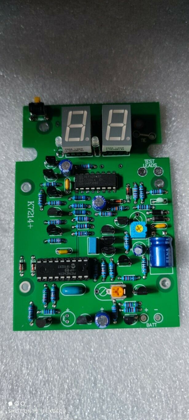

              I messaged him on Ebay asking for pics or schematic....
              New message from: winwinstudy (57Blue Star)
              The circuit is basically the same as the BLUE ESR METER, the MCU is replaced by a PIC16F627A and the circuit diagram can be easily found on the internet.
                That's a tiny PIC 18-pin 1K flash. The acid test is if the self-diagnostics got carried over.
                The big 3mm LED for decimal point works great when you're inside a machine doing in-circuit testing. The display's tiny decimal point (unused) would be hard to see and it's a huge mistake to get that ESR number wrong by 10 or 100.
                I like the 50mA test pulse, seems to handle most electrolytics.
                A newer meter would have an extra digit and measure capacitance as well.
                Not a prob. with modern MCU's they have lots of code space.
                      He actually sent me a pic...
                        Looks like an almost 100% copy of the original PC board, except the PIC MCU is flipped compared to the Z8, and they added a top-layer ground pour.
                        The firmware matters the most on how accurate the port over to the PIC is.
                          woah heck forget the ground pour, the original is a single sided PCB, the fake needs more tracks - on the upper layer...
                          Heeyyy... Now I get why they used those oversized T-1 LEDs... seems just about all the 0.5/0.56" 10-pin 0.6" center LED displays made today are all RHDP... dang. Just because of the slant it fits that way...
                            I split off the discussion from the original thread here: https://www.badcaps.net/forum/showthread.php?t=95107
                            After a quick Google search it seems this clone is based off the firmware that is available to purchase on a pre-programmed PIC16F627A here: http://www.nippur.hu/english/bpesreng.html
                            Quite funnily the Chinese cloners of this (reverse engineered?) design even copied the exact text used from that page and the word document it links to for their eBay AD.
