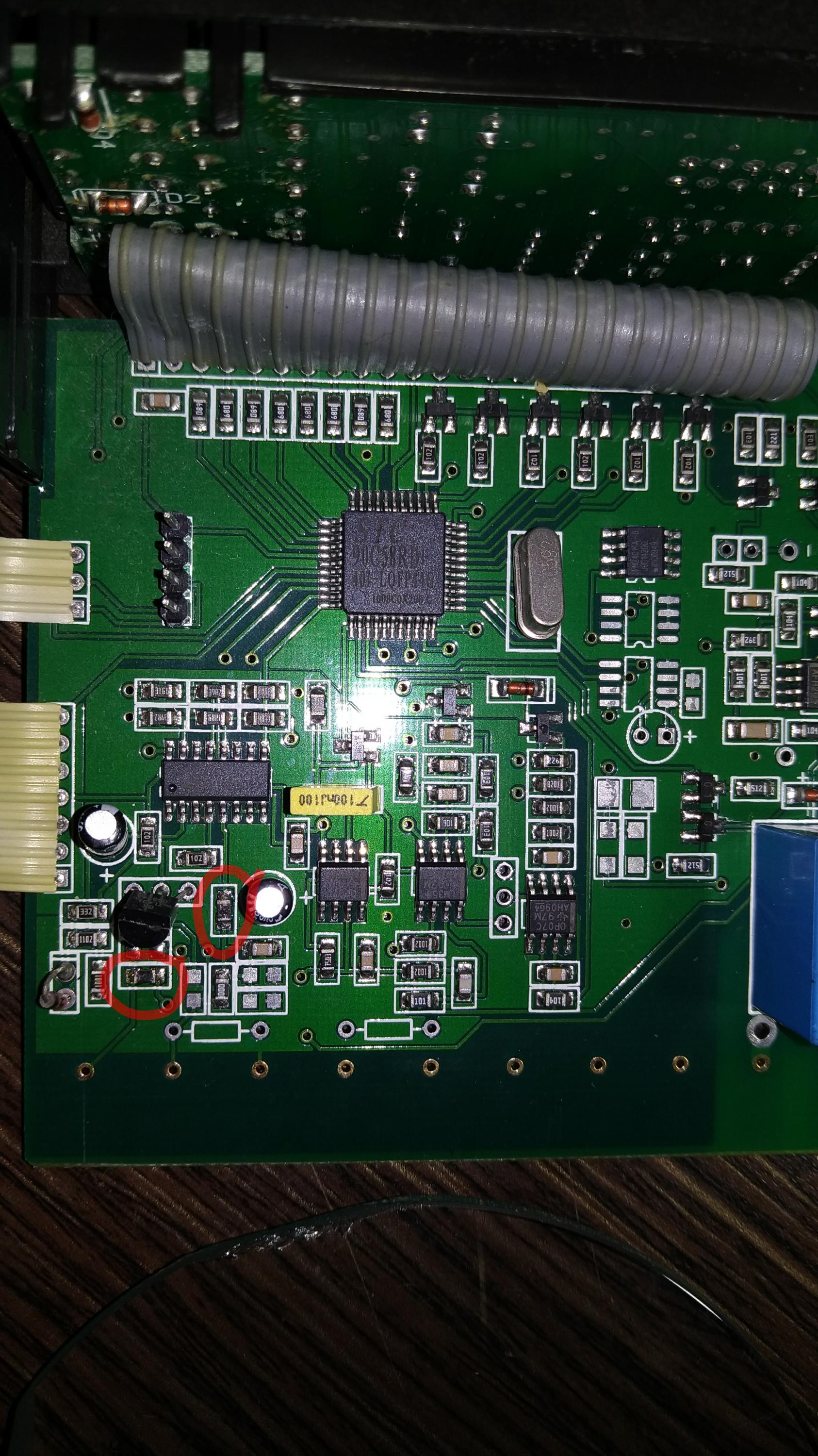

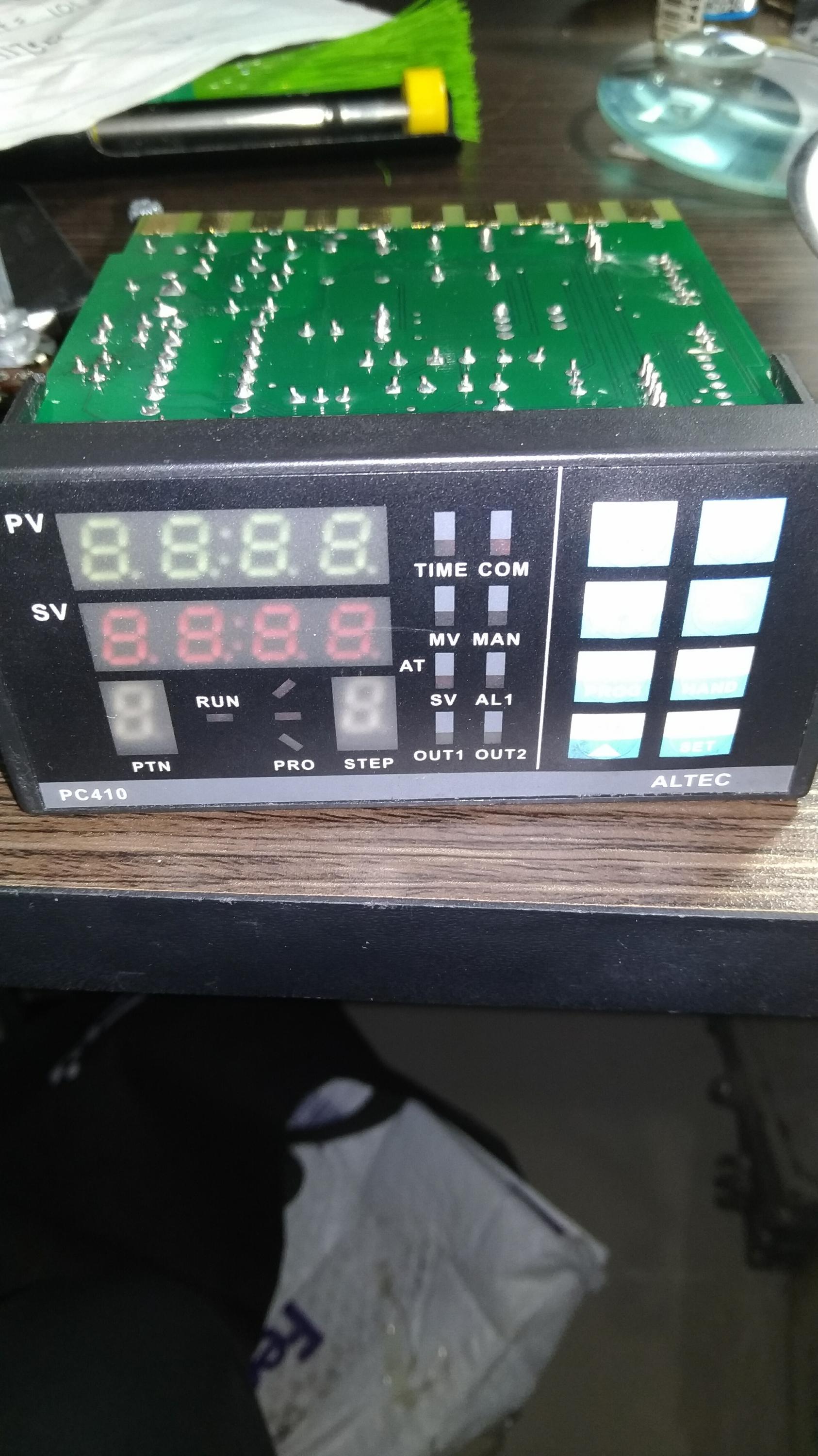

    Hi i need help identifying the value of some burnt resistors. I have accidentally pluged the controller upside down. Upon inspection I saw some burrnt resistors I don't know if anything else got damaged. If anyone has the same controller maybe can take some photos of the board.
    CONTROLLER NAME AND MODEL ALTEC-PC410

    blown transistor mid-right too.
      CAN A MOD CHANGE THE TITLE TO "Altec controller" ??
      Can you take a photos? Your resistors are in tact? I just need the code. I can check the transistor for you if you like. Also, what happend to your controller?
        • 31087
        Re: Achi pro SC controller
        it's your controller - i'm just looking at your pictures!
          Oh OK. I didn't even notice that transistor. I hope someone can take photos so I can identify the parts
            By the way the thing still has power. I had to change the top223yn because it had no power. After changing, was putting it back to the housing I didn't notice it was upside down. Hence the damage,
              if a topswitch device blows, its usually caused by the startup capacitor.
              a 10uf to 47uf electrolytic nearby.
              i have to fix several hundred sattelite recievers with that problem once.
