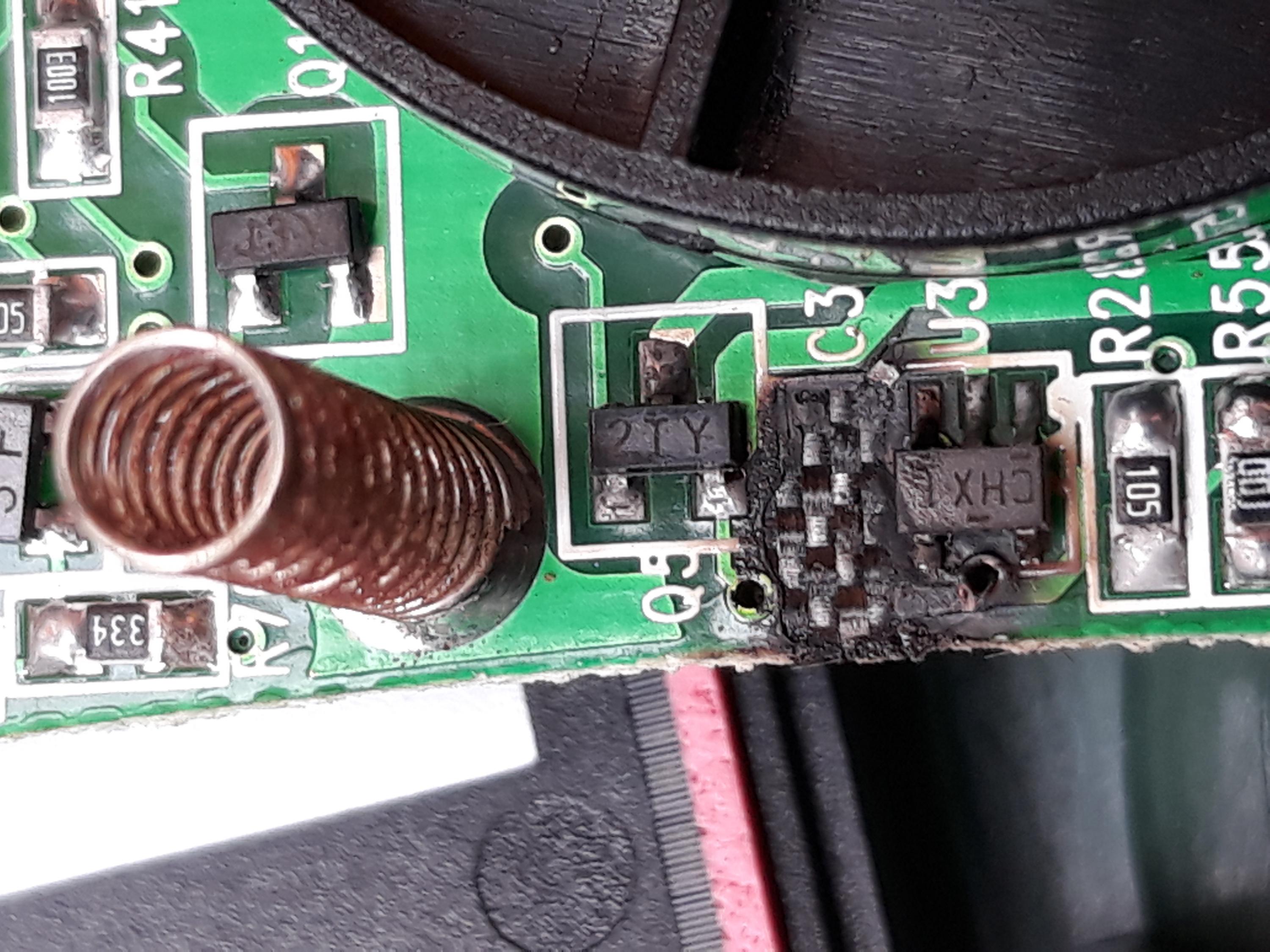

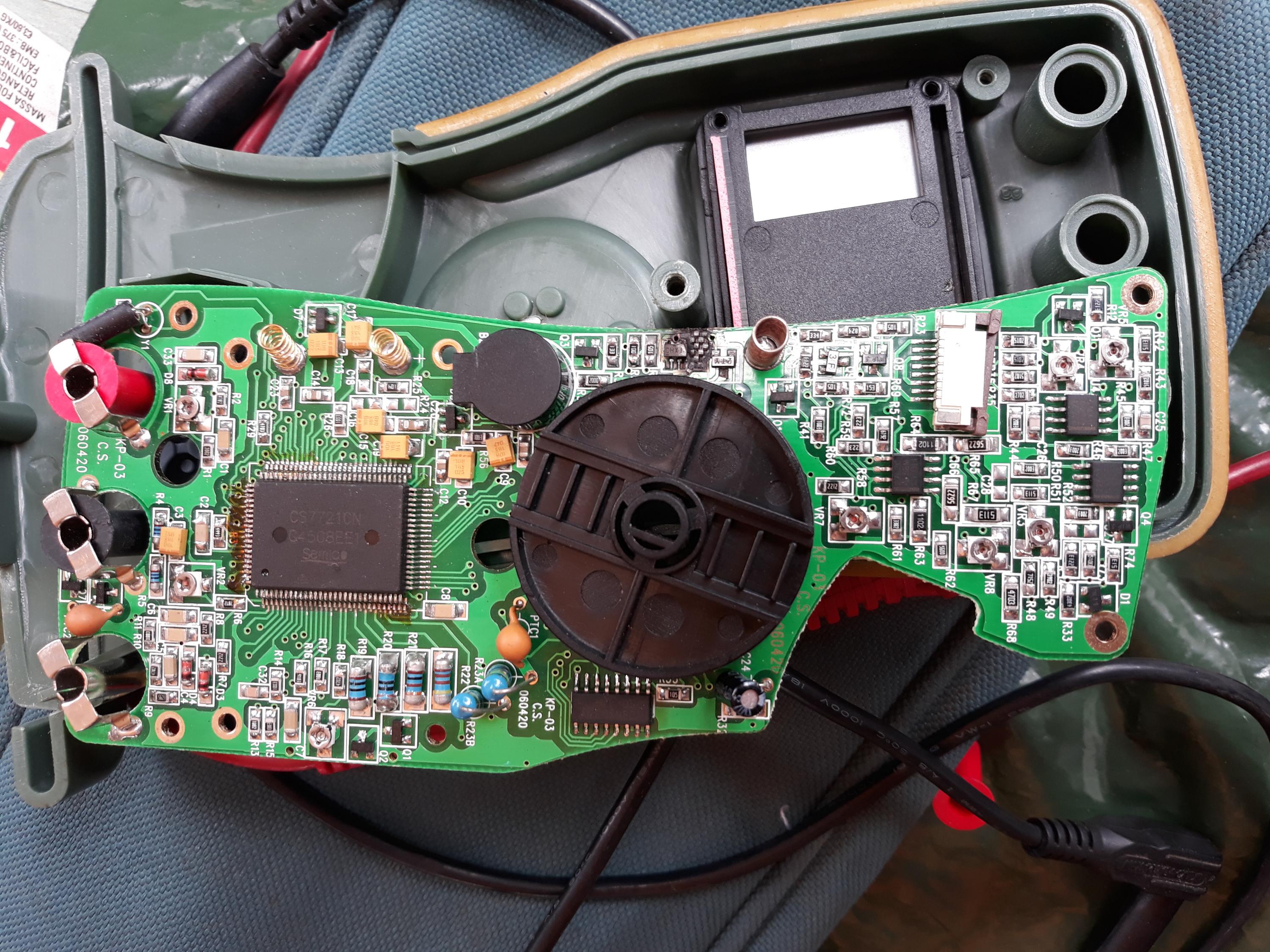

    The factory / reseller ... don't know anything about the device (Schematic, Service manual, etc) and I need to repair this DMM - Clamp Meter.
    2TY - Transistor - Q5 (Diode mode ok)
    CHX ??? 5 Pins - U3
    C31 ??? Burn,
    Tested - V, Ohm, Diode, ºC ... don't see any errors
    Thanks in advance for all info
    Ruy

    Re: Koban - Current Clamp Meter - DMM
    CHX may be XC6116H028MR
      Thank you,
      I can't find PDF with that reference.
      Thank
      Ruy

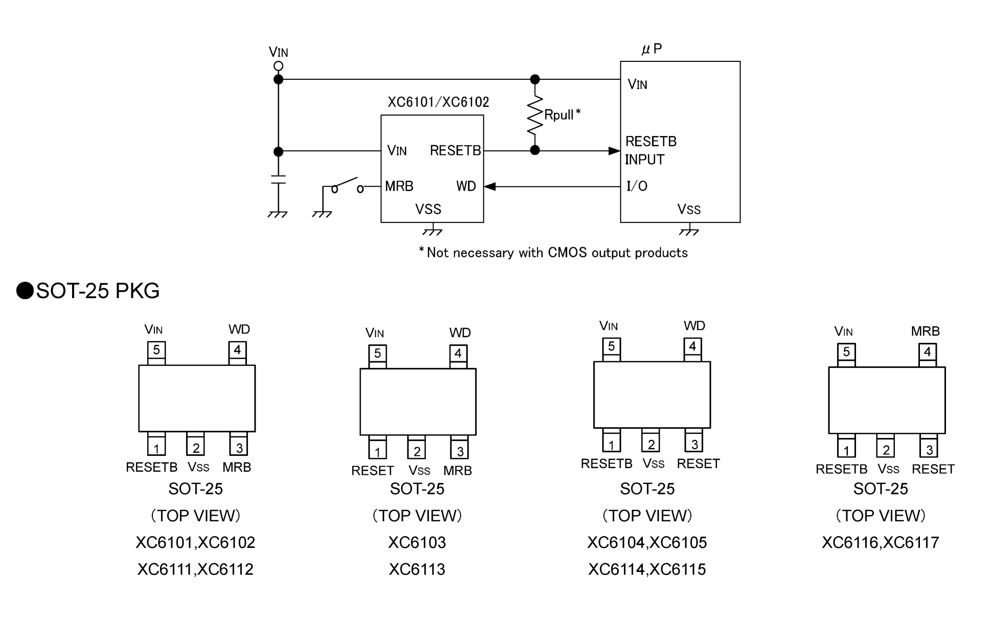

        @neuron
        stj is most likely right! A simple quick search returns:
        Part No.: XC6116H028MR, SmdCode: CHX, Manufacturer: Torex, Package: SOT-25, Pin: 5, Memo: XC6116H028MR, Description: 2.8V Voltage detector, 0.1%, Delay time = 1.6s
        The datasheet may not be easy to find but that`s not your major concern, right?
        Either way, you can find here the datasheet.

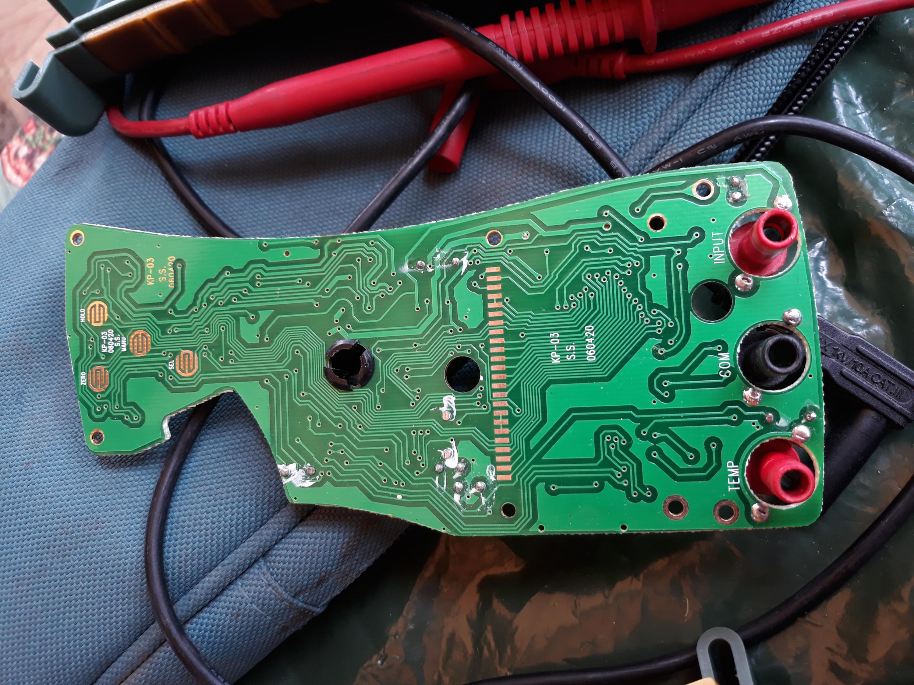

                • neuron
                  • Feb 2013
                  • 126
                  • Portugal
                  mabe you can find a schematic for a similar meter with the same chip.
                  Semico CS7721CN
                  i also found this:
                  "The CS7721CN is pin for pin compatible with Fortune Semiconductor FS9721"
                  and a LOT of meter info is here:
                  https://sigrok.org/
                  Thank you stj, megaraider
                  2TY 2 - Emitter -> down -> 2 Layer, through hole.
                  2 - Emitter -> up , Left -> C letter ->
                  U3 pin 2 VSS -> C31
                  U3 - pin 1 (down) -> 2 Layer, through hole -> the other C31 pin
                  Testing U3 (Diode Mode) I get +- 0,56V
                  Other procedure to test this IC?
                  Regard,
                  Ruy

                  • megaraider
                    • Jul 2015
                    • 307
                    • Portugal
                    Regard,
                    Ruy
                    Some thoughts:
                    U3 is an IC, see the attached image taken from the datasheet.
                    Follow the 5 pins traces back to the connected points and test if it`s working.
                    Q5 is most likely a transistor. Remove it from the board and test it.
                    C31 was a capacitor... value and type remain unknown.
                    From the previous, and compared to other similar schematics, you should be able to sort it out.

                      • megaraider
                        • Jul 2015
                        • 307
                        • Portugal
                        And where I can find that schematics?
                        In your attach XC61xx.PNG the cap between Vin and ground ... value?
                        Ruy
                        See datasheet here.

                          • televizora
                            ghettomodmaster
                            • Nov 2016
                            • 957
                            • Bulgaria
                            I wonder what happened so the PCB is so burned.

                            • neuron
                              • Feb 2013
                              • 126
                              • Portugal
                              Only C31 Burn
                              I power up and tested all function
                              V, Ohm, Hz, Diode, ºC, ... don't see any errors
                              Zero, Hold, Select.
                              Ruy
                              • megaraider
                                • Jul 2015
                                • 307
                                • Portugal
                                Originally posted by megaraider
                                See datasheet here.
                                It's in japan. and no info about the cap ...
                                From the above datasheet, page 11:
                                4. Noise at the power supply may cause a malfunction of the watchdog operation or the circuit.
                                In such case, please strength the line between VIN and the GND pin and connect about 0.22μF of a capacitor between the VIN pin and the GND pin.
