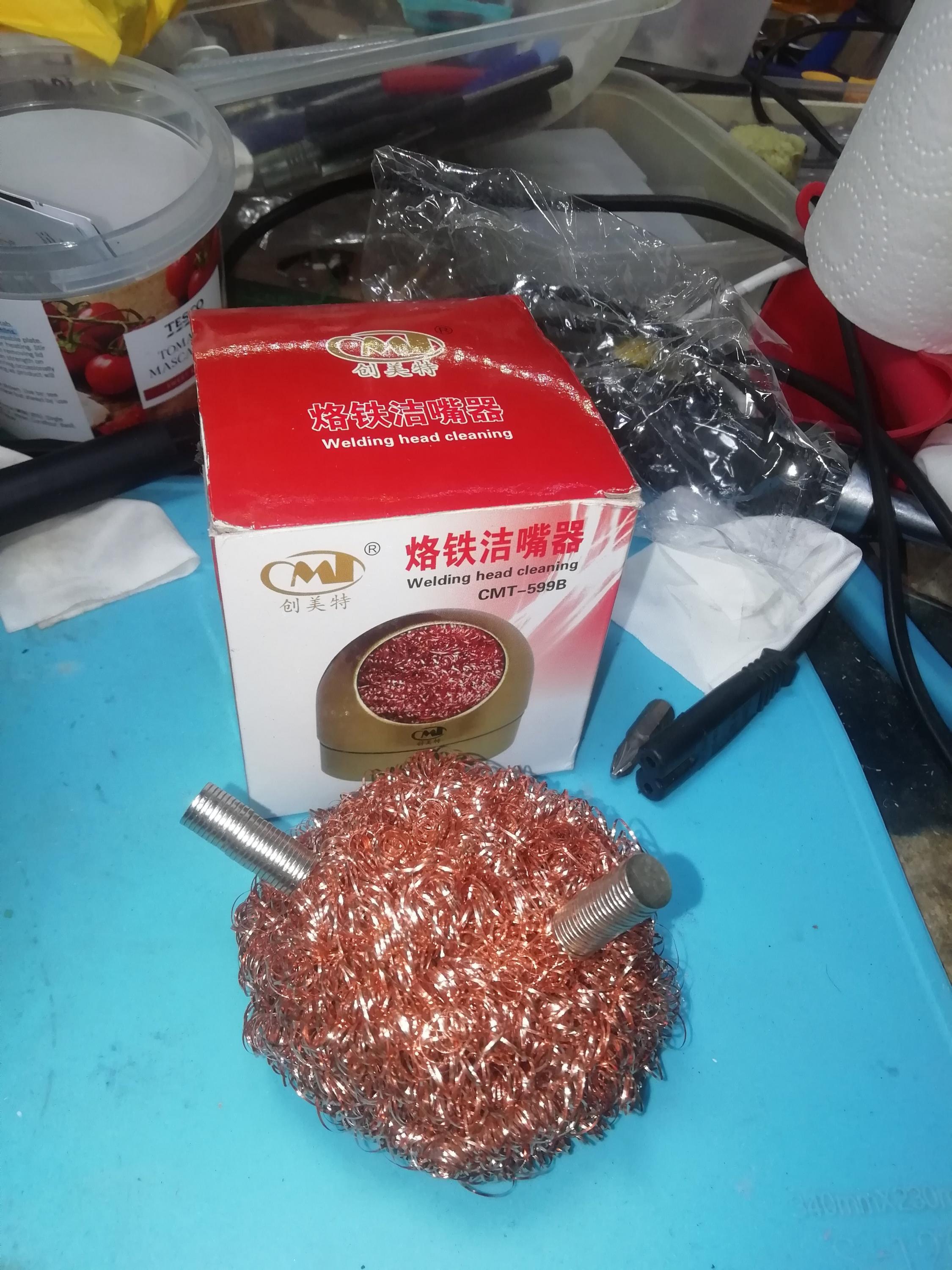

                                    brass wool is fine, but some scumbags sell steel wool with a yellow coating!!
                                      Also available in Rose Gold ! Luckily I bought it for the holder not the contents.

                                        Re: Soldering/desoldering station
                                        BOO. That would do it. scumbags with yellow coated steel wool...
                                        Not only that, the steel wool still doesn't clean as well as copper/brass as excess solder would stick to the wool better.
                                        At least it's not yellow colored plastic wool...
