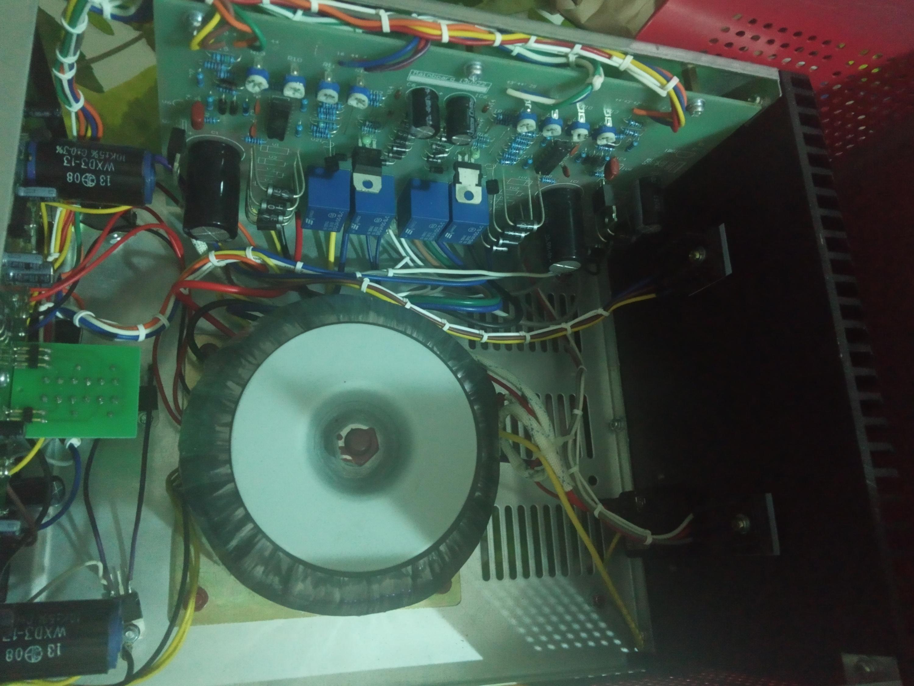

        I use that more than the other one. It is dual 0-30V 0-3A but you can set it to use both supplies in series or parallel or independent so you can have 0-30V 6A (parallel) or 0-60V 3A (series). Also it an do +0-30V 0V -0-30V for dual rail plus/minus supply
        In additional is has a third fixed 5V Supply.
        The ability of being able to do split rail plus-0-minus supply or having three independant supplies (two 0-30V variable and one fixed 5V) has proved indispensable for repair work. I do mostly TV/Monitor, motherboards and some amplifiers. If you can find one like this second hand for a decent price buy it.

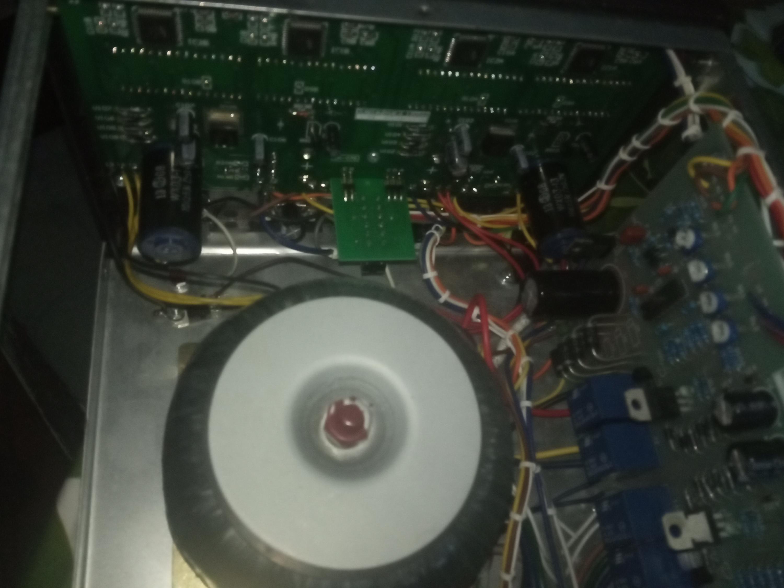

                I got one of those triple psus. I don't know the oem but this one is branded uni-t, and it's been very reliable over the years. A bit bulky but hey it's linear. I've heard newer smps aren't as good for finding dead shorts, because they will go into auto-protect mode.

                          I think it's better built than another one branded Circuit Specialists. Whether that is OEM´d or a ripoff is anyone´s guess. The Uni-T´s entire backpanel is a heatsink vs. the CS´s two fans. So it´s also quiet as a mouse. Compare that to https://www.ebay.co.uk/p/1342932699 . Scroll for the review with pictures of its innards.
