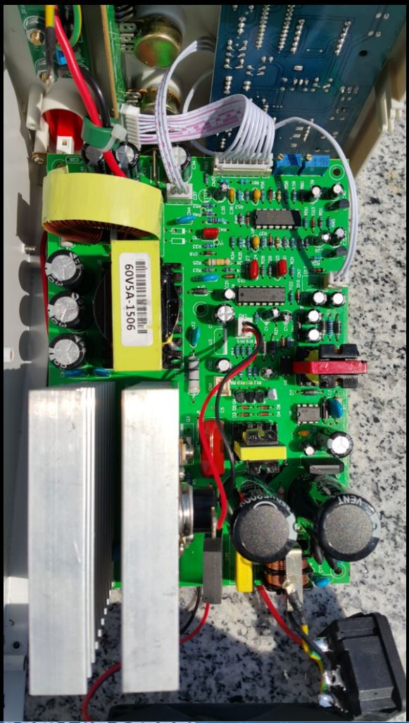

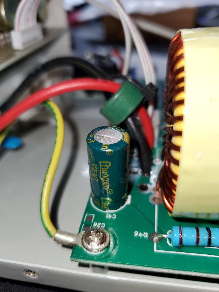

    All,
    Cooked my Inexpensive DC Power Supply.
    It was a not thinking moment and by the time I realized what I had done...the damage was already done.
    I believe I can correct but do not have a schematic. If anyone has one of these and could take a quick couple pics of theirs I would be most greatful.
    I know I popped a 330 uF 63 Volt Capacitor (C41).
    A resistor (believed to be a 1/2 Watt) but the bands are not telling me much either...I see the first band (Green) and last band (Brown)....Its in Location (R13)
    Two other SMD Resistors (R01 & R02)....They are not super small but are thin and black...I believe the wording on them are 5R0 but I am not certain as they are pretty cooked in the middle. The R01 is between the cooling towers.
    There is also a small ceramic SMD capacitor that popped (C24).

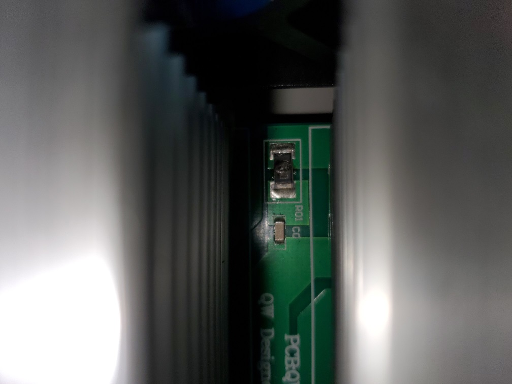

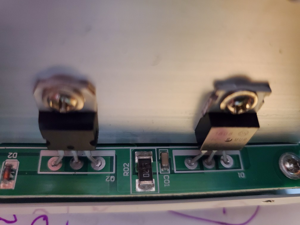

      Re: DC Power Supply QW-MS605D
      budm,
      Thanks for the reply.
      I have included the images of the unit and the damage.
      Basically the R13 Resistor was my first idea there was an issue but the C41 quite literally blew its steam before I pulled the plug.
      It was only the second time I had used the supply and I was testing some back lights on TV I was disassembling to dispose of the Chasis.
      Thanks again,
      Chris

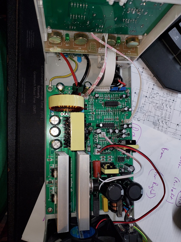

        All,
        I have included a pic of the complete unit internals as well.
        Thanks Again,
        Chris

              Not sure if this will help or not for a schematic drawing but on the PCB there the silk screen markings;
              PCB: QW-301DXL-KZ
              QW Designed By LYH 2015.09.17
              Chris

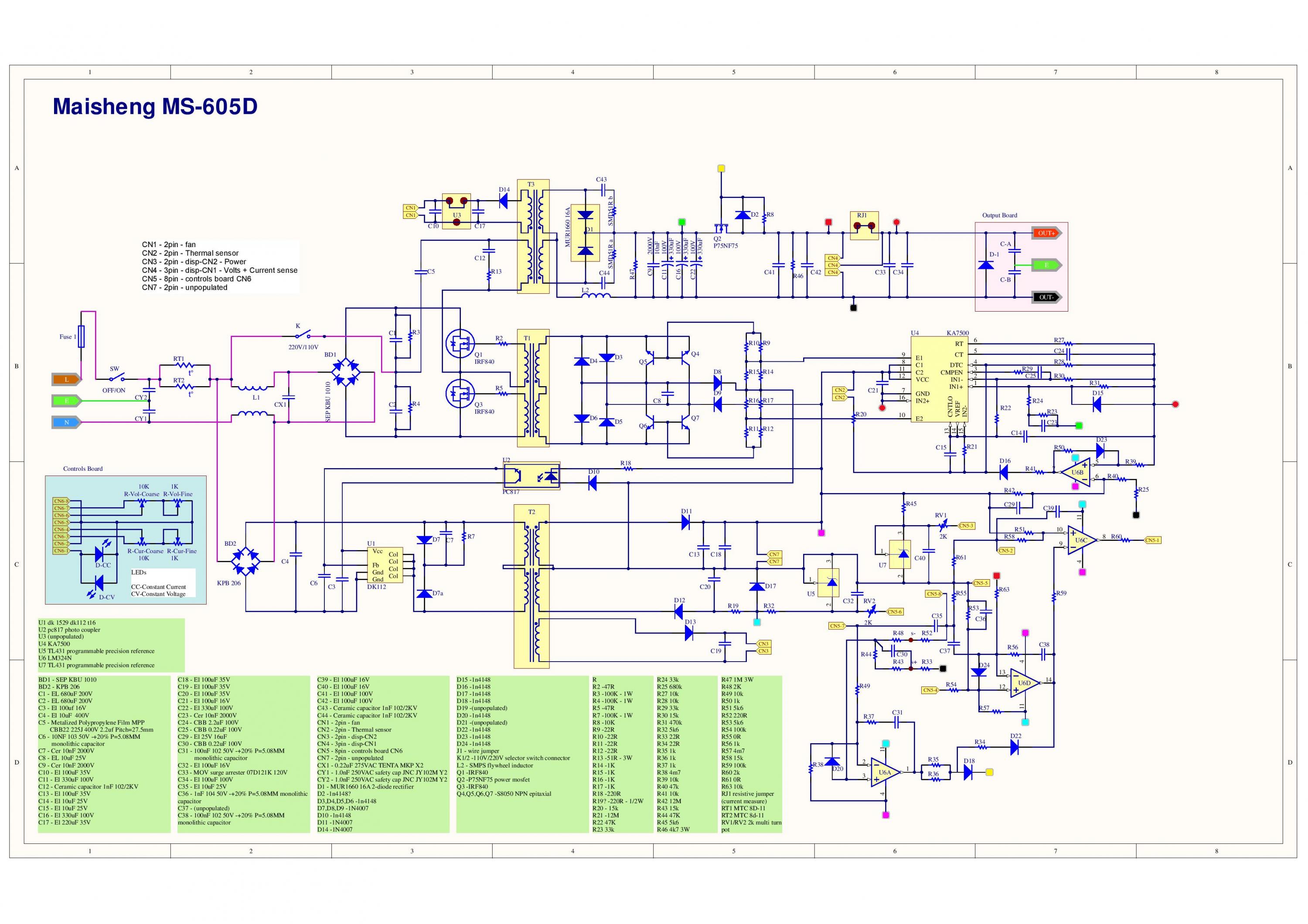

              • R_J
                • Jun 2012
                • 9535
                I have this, It should be close and should help.
                  • Jul 2011
                  • 6039
                  You said earlier that the cap that blew was rated 60 volts DC
                  If the power supply output is 60 DC and this cap is on the output rail where it see over 60
                  That poor cap could not help it self but to blow
                  It needs to have 100 volt rated caps on the output rail
                                Guys,
                                I was looking at getting the order together...

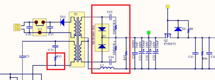

                                I have included an image breakdown where my question resides;
                                R13 is a Metal Film Resistor - 51R 3 watt (According to R_J Diagram) (Small Red Square in Image)...My resistor is fairly burnt (included image)
                                The Image given by RJ matches my DC Power Supply fairly well (R13 location included) but in his image the Area circled in red (large Square) - 2 SMD Resistors - Believed originally to be by me to be 5R0 and is my R01 and R02.
                                In the included diagram (this post) its written vertically (large red square) to be SMD51R.
                                So should I by the SMD51R 3watt if the R13 is a 51R 3watt. The MUR1660 Numbers match on the Diode (D1). My assumption from the burnt SMD components to be 5R0 is probably wrong?
                                Chris
                                  I suspect the smd you have (5R0) are correct 5Ω. If they were 51Ω they would likely read 510 and not have the "R" It could be the diagram is wrong or just different.
                                  R13 will likely be a 51Ω 3watt, Here is a picture I found

                                    • R_J
                                      • Jun 2012
                                      • 9535

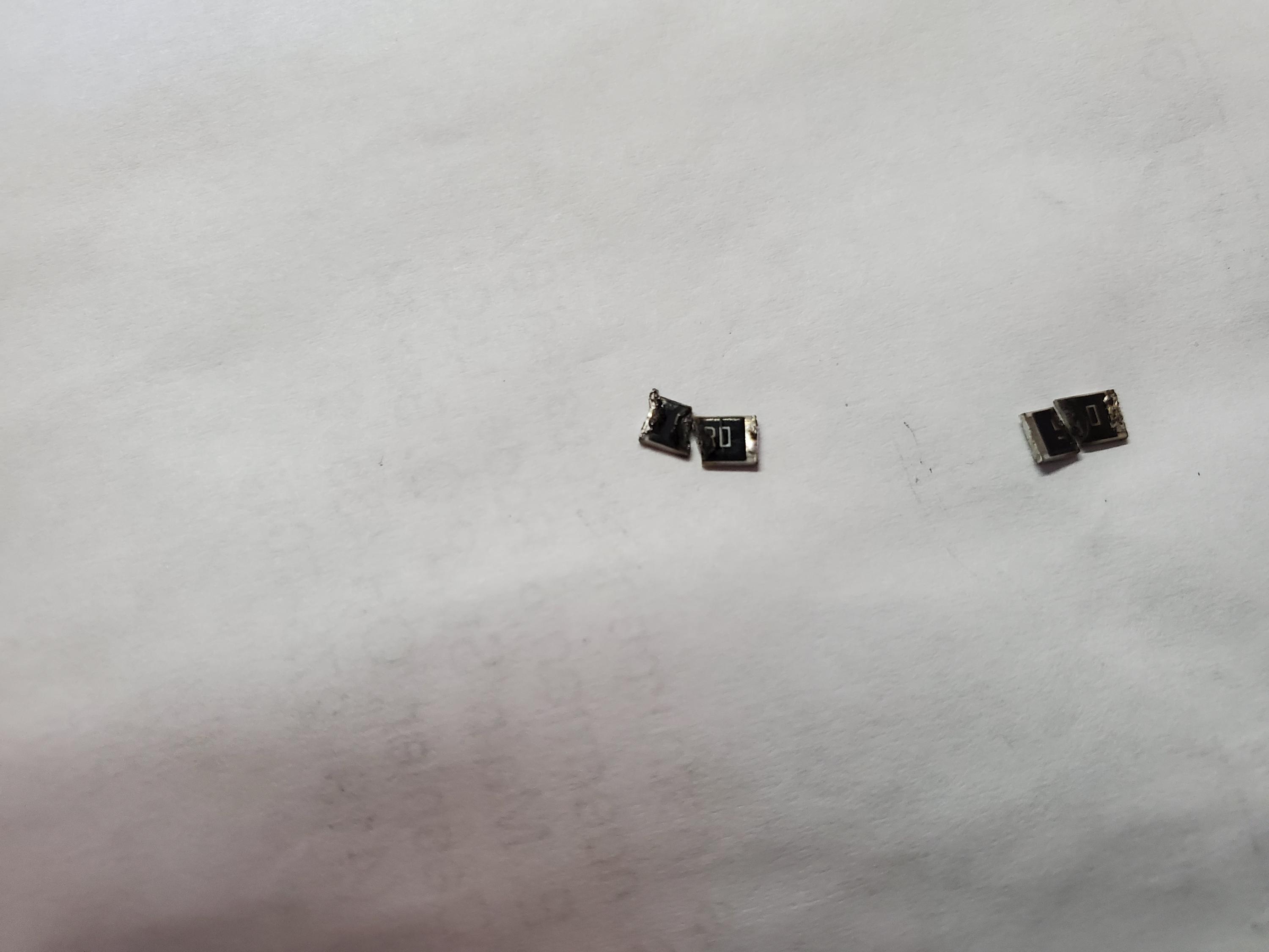

                                      After a closer look I think they may indeed be 51R0 resistors, There is enough distance between the 5 and the R0 for another digit and I see that 51Ω is a common value, It is likely a 3 watt
                                      Looks like digikey A121269CT-ND, made by TE, 352251RFT, Thick Film size 2512 (6432 Metric)
                                      Measure them, they should be L=6.3mm X W=3.1mm
                                      • SolomonMan
                                        • Apr 2019
                                        • 206
                                        I believe that is the right sizing...I grabbed a micrometer but it was hard to measure as its hard to see where the crack goes exactly together.
                                        They are a good size SMD Component and the sizing was fairly close.
                                        Chris
