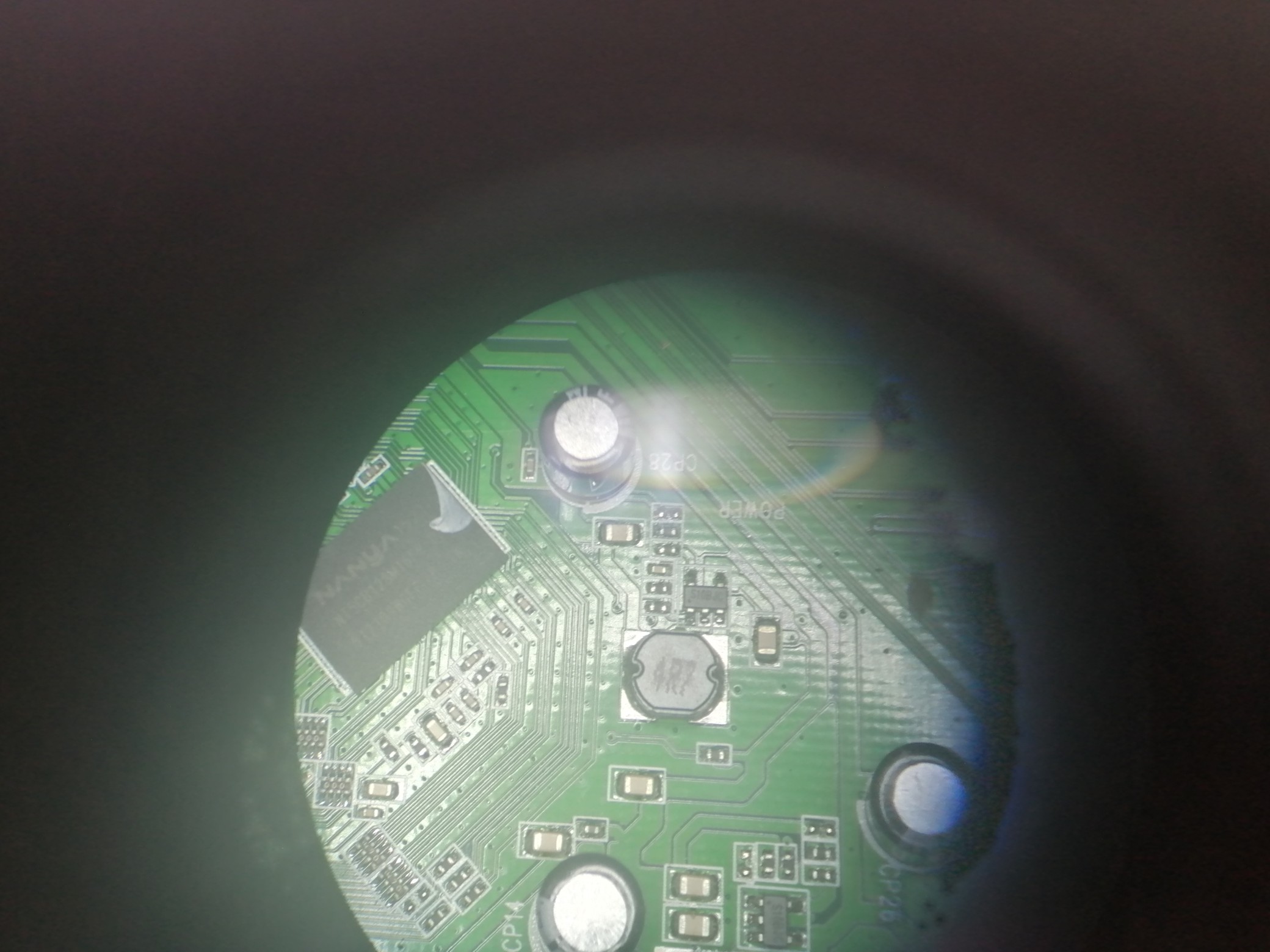

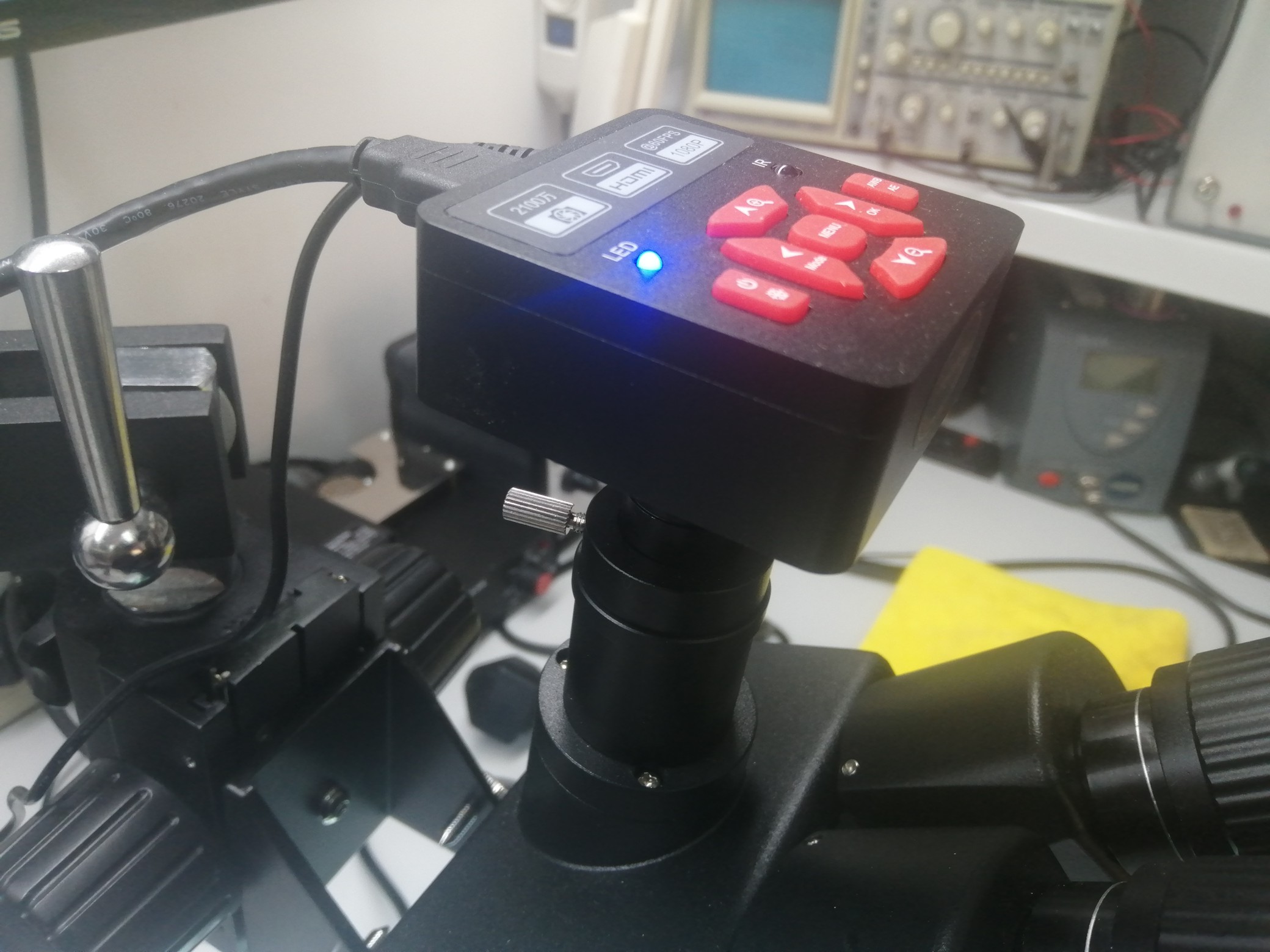

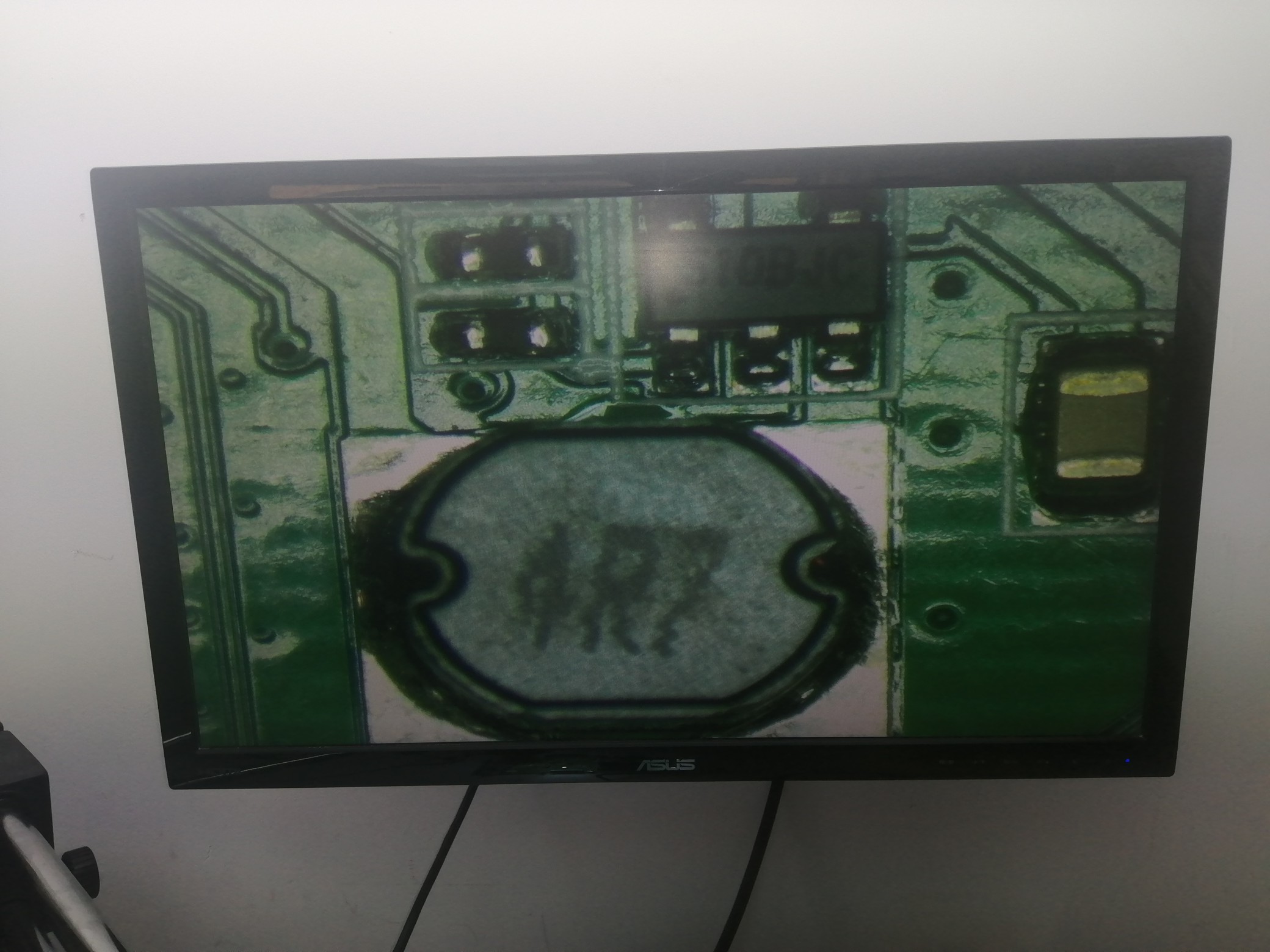

    I'm getting a much more magnified image on the camera of my trinocular microscope than the one I am seeing through the eyepieces
    I set the camera to minimum zoom but it will not zoom out anywhere near enough to work properly.
    Adjusting the vertical position of the camera on the microscope sets the focus, not the image size, so I have to position it at a set distance
    I've asked the seller but before they answer, can anyone say if this is actually normal? Not having had a proper microscope before I have no experience.
    Attached is a pic of the monitor screen and a pic taken through the eyepiece of the same PCB at the same magnification setting.

    It looks like its set to 4:3 zoom its stretched the image. Whats the camera and monitor model numbers .

      I think there are adapters (barlow?) to put on the camera to make the image further away.

        I got a reply from the vendor telling me the camera was working normally and I needed to buy a CTV 0.5X adaptor to fit on the camera then the image will be the same size.
        I then asked if he sold the correct adaptor and he gave me a link to this one, and says I need to select type CZMCTV 1-2.
        https://www.aliexpress.com/item/3286...3d073e5f9rxcr0
        So hopefully that will solve the problem and it isn't particularly expensive but I do wonder why the microscope plus camera combination I bought didn't include the correct adaptor in the fist place.

          Re: Microscope Camera question
          Just a follow up
          I received the CTV 0.5x Adapter and now the camera shows a much wider field of view.
          Not quite as wide as through the eyepieces, but it is close enough.
