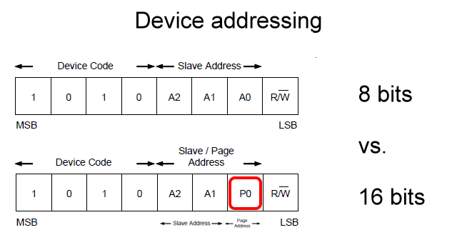

    Originally posted by stj
    bad move.
    24c00 upto atleast 24c08 is 8bit, but at some point they switched to 16bit!
    See the attached picture for differences in device addressing between 8 bits vs. 16 bits arrangement
    IMO the hookup is nothing but trouble
    From the picture on your 1st post not only you have plenty of spare space as well as the e2prom header!
    Use the header, add another header for the remaining e2prom pins (SDA, SDL & WP do not seem to be connected to the existing header),
    and insert a micro-switch in series with the power e2prom pin (so you won’t have to hold the processor in reset / halt state while programming the e2prom).

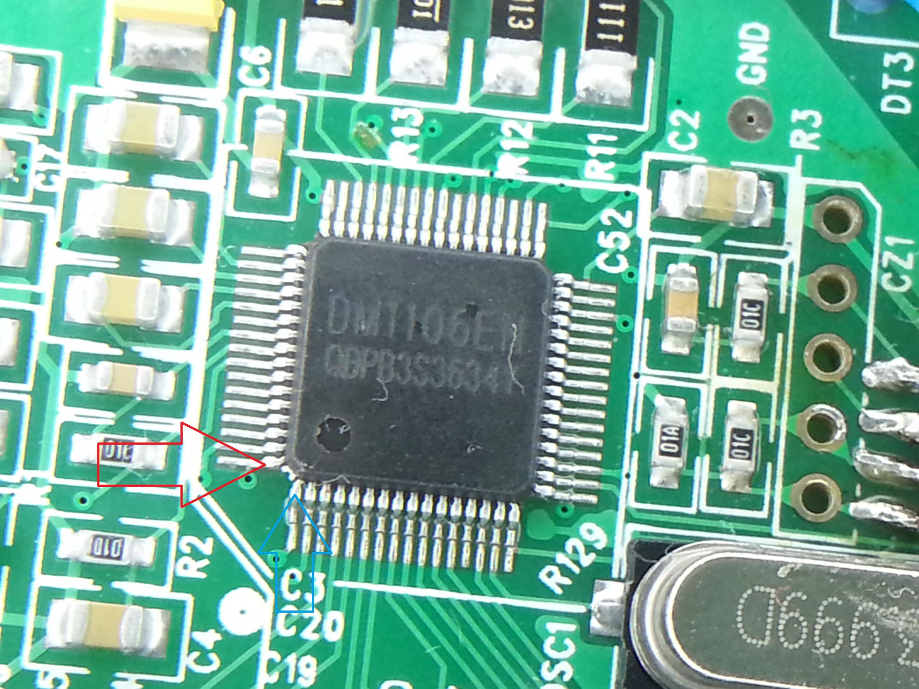

            I'm ready to try the button. First, dumb question: what's the pinout for this chip ? Where does the numbering start ? The datasheet doesn't quite make it obvious. Which one is pin 1 ? Red arrow or blue arrow ? Logic would dictate it's the blue arrow because of the way the text is oriented. So apparently, for MAX/MIN, I should connect pin 23 to pin 26, which should be on the side that's mostly unconnected on the right, towards those header holes. Assuming it operates like the select button, I'd connect it (tap the button) once to enter MAX, then again to enter MIN and again to exit, at least that's what I read and what the meters which have the function normally do.

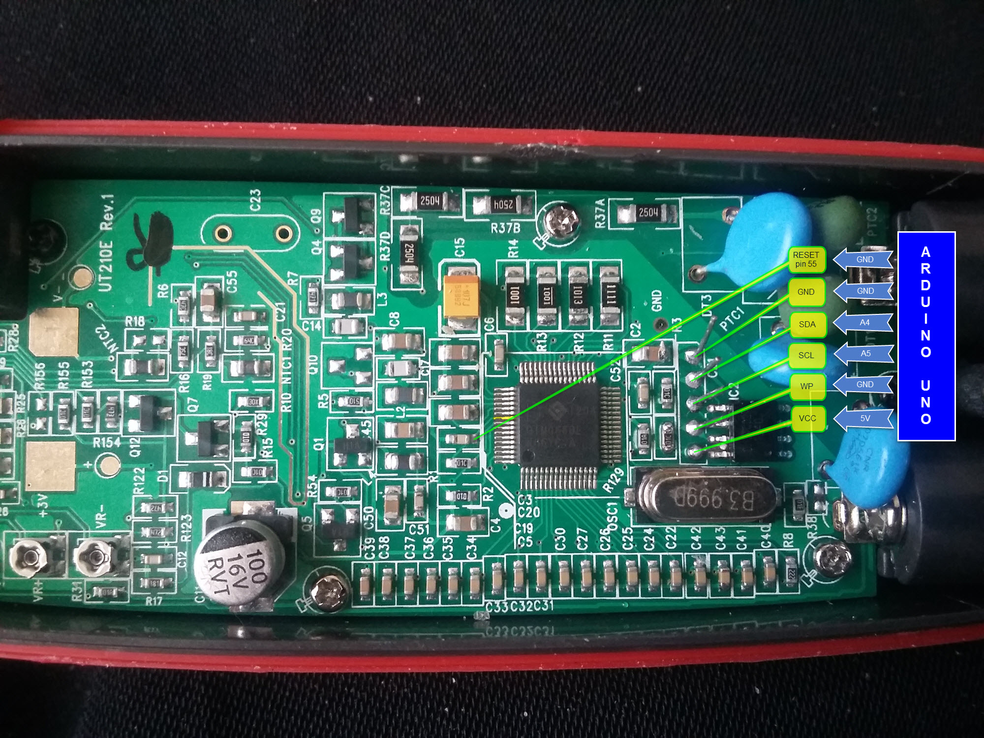

              Originally posted by Dannyx
              I'm ready to try the button. First, dumb question: what's the pinout for this chip?
              This picture answer your question plus all you need for in circuit e2prom programming.
                • 31199
                Re: Hacking the Uni-T UT210E
                yea, pin1 is where it says "c3"

                  No need for the arduino - I have a programmer which I used and it's working now as I've said. It was the wrong IC (despite both being 24c02). Ok, so I got the pinout down too...moving on
                    No need for the arduino (...)
                    In circuit eeprom programming not restricted to arduino
                    you can do it with the programmer you're using and avoid the hookup mess in any future mods if need

                      I avoided that because I thought it'd interfere with the main IC...at least that's what I read somewhere...not necessarily true.
                        That's why you also need to connect the RESET line (pin 55) to ground (GND) while in circuit eeprom programming and thereby eliminating any interference

                          Just soldered some thin pieces of wire to pins 23 and 26. However nothing's happening...either I'm doing something wrong or it's not that simple...I doubt all it took was a missing button after all
