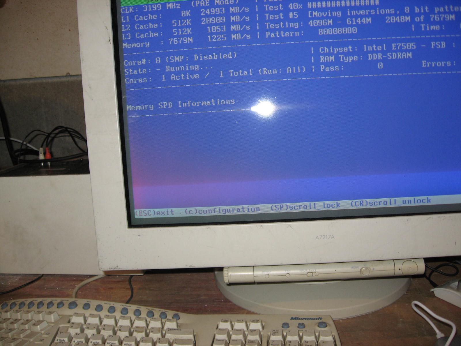

    My HP A7217A (Rebadged FD trinitron) needs degaussed badly. The lower right corner's blues are non-existent and auto-degaussing isn't doing shit. It was in Topcat's attic for years, stored next to goodness what, then hauled in the back of my truck for 5 hours. Ever since that it's been screwed up and I'm now getting around to fixing it.
    Question is what's the best kind of degaussing tool? Even on fleabay they're a bit pricey, so before I plunk down money, I'd like to know if there are any gotcha's to look for. New Chinese coils better than old used coils? What about wand-type degaussers?
    I'm a noob at CRT work, but I do know there are a few former TV techs around here...

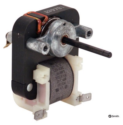

    If that doesn't help, get a small box or stand fan, with an open C-frame motor, and pass this over the face of the CRT. Try various placement to find where the field from the motor is strong enough. Enclosed motors don't seem to work very well.

      Forgot to mention, the issue goes away for 1 second after auto-degaussing, but then I hear a click and it goes back to normal. Still a screen magnetism issue?
          Back to normal means wonky?

            Re: Manually Degaussing a CRT
            Yes.
            See attached... it's worse than this, but this is the best picture of the issue I have.
                    Yes.
                    That keyboard is headed towards looking as dirty as the keyboard I saw at the Crotched Mountain Rehabilitation Center garage, LOL. (For their vans and bus.) Even though I thought their keyboard was much worse, LOL.
                        Originally posted by stj
                        so is the internal degausing working??
                        if yes, then a screw has been slightly magnetised - it will slowly clear.
                        if no, lets fix the degausing.
                        it's a posistor and sometimes a relay.
                        Yes degaussing seemed to be working just fine. However, the display has been distorted for months.
                        I did try using the supermagnet trick. Made it worse at first but then it got better?
                        I'm out for a few weeks, so until then I can't really test anything
                            The colour in the problem area looks to be magneta in colour, suggesting the blue and red pixels are being affected.
                            I would think with a degaussing issue that you'd see colour images around print characters in that area. Can you get gray scale printed characters in the area at a low resolution?
                            The manual for your HP suggests there are dynamic colour and convergence adjustments (page 14, 15) that affect different regions of the screen. Seems to me that may be the issue rather than an overall convergence problem related to degaussing.
                            I don't know if it's possible on these displays to set purity with red, blue, or green screens only. If I remember correctly, on older colour TVs, you set the purity for mid-screen, adjusted the screen for a white raster, then used the dynamic convergence panel to adjust the extremities of the beam movement for each colour. I recall using a static pattern on the screen to do that but it was a long time ago.
                            I know this unit uses the Trintron, single beam scan and it seems there may be electronic deviations in the dynamics control system at the bottom LHS. There may even be components out of spec.
